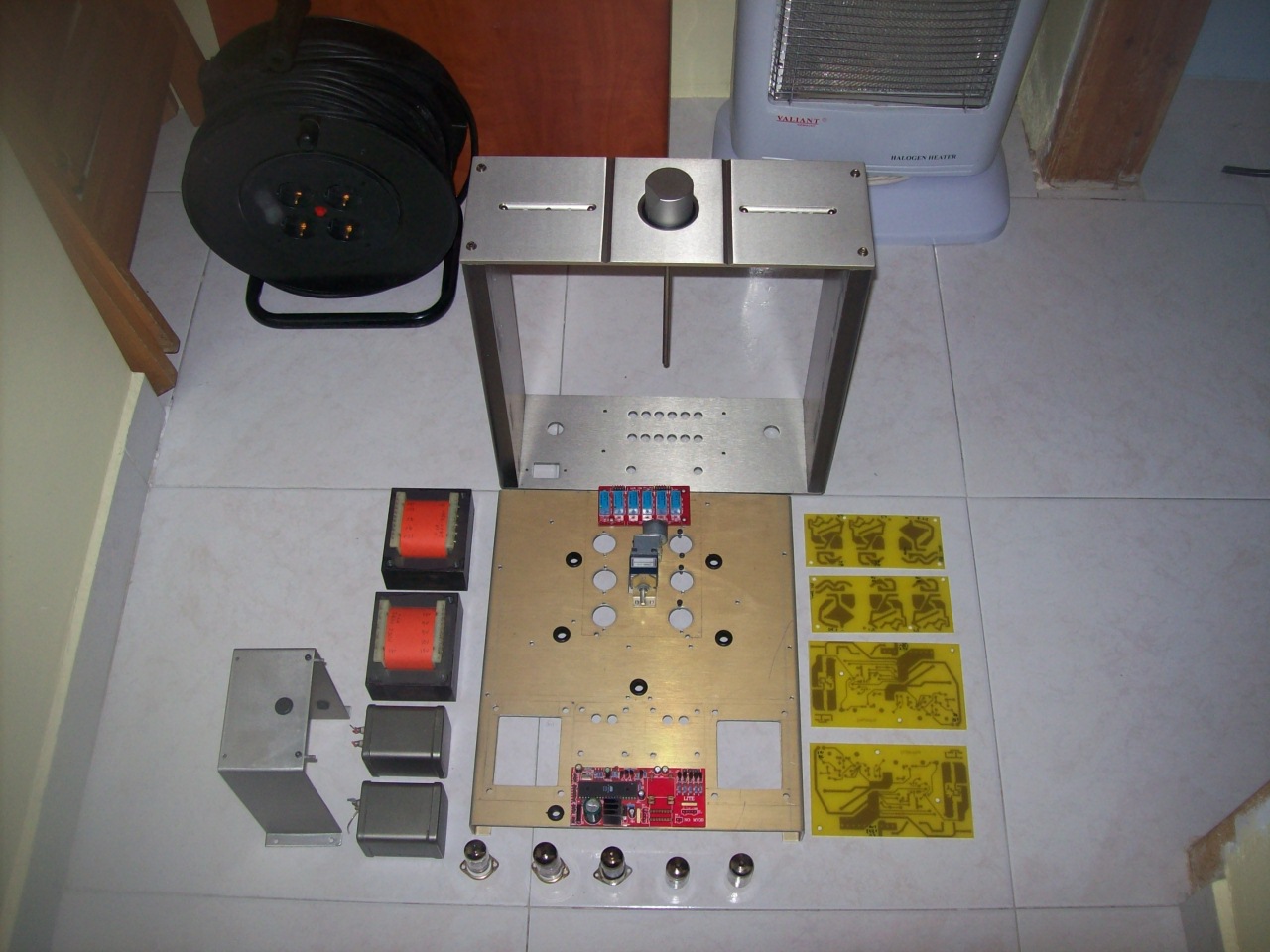

I like the Dynaco look and setup. So you found the transformers yesterday. And made pcb's and got it fired up in one day!!!! I'm jealous. 🙂

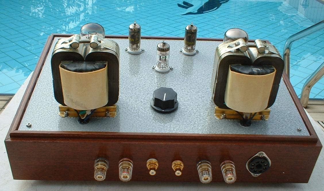

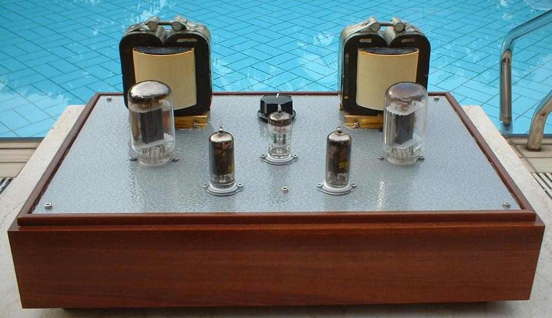

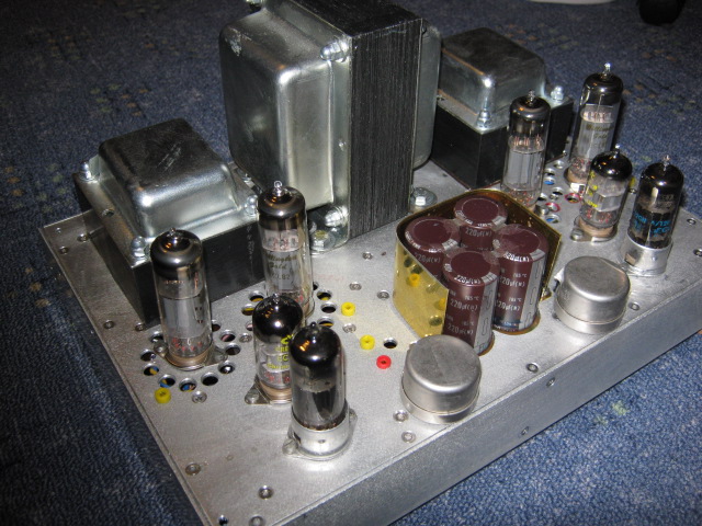

Well well; alot of similarity, ECL82 7W per channel. Drop-through o/p trannies; home-made mains tranny different orientation. Not a touch of hum..Fixed bias operation.
squad= balanced input trannies: front end 12GN7 as triode; split load p/s ECC88. I like the sound but 8K primary is a touch soft on the upper register, neverless an easy amp to build with a remarkable performance and sounds astonishingly loud and clean when put against a 20 Watter.

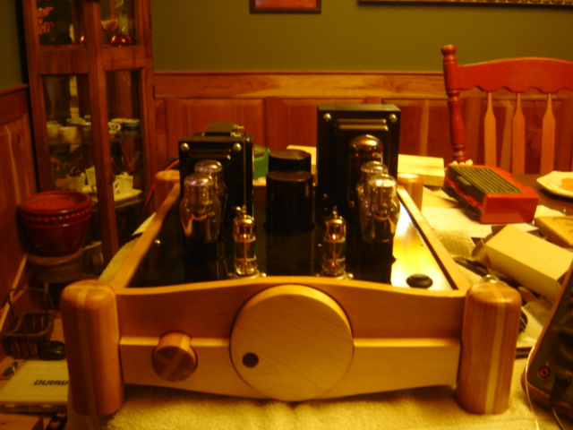

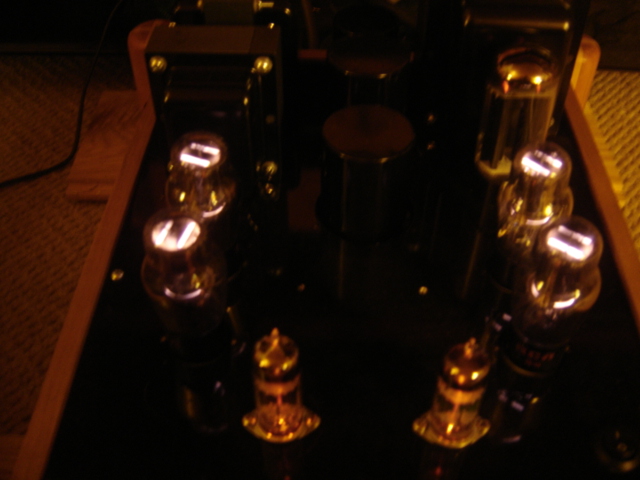

12b4 linestage built based on threads here. CLCLC Filter with 2x OD3 for 300V B+. Resistive loaded plate with a LM317CCS on the cathode keeping the tube biased at 20mA with 150V plate voltage. Have not played with LED bias yet. Built P2P but embarrased to show it as wiring is UGLY. No hum so I guess it is good enough for now.
Chasis made of Cherry and Maple of local origin.
The gas reference tubes add a very nice light to the amp.

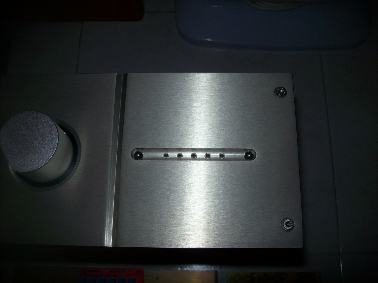

The left knob is the selector switch. The line amp will accept 3 unbalanced inputs. I am not real happy with the knob and will probably redo.

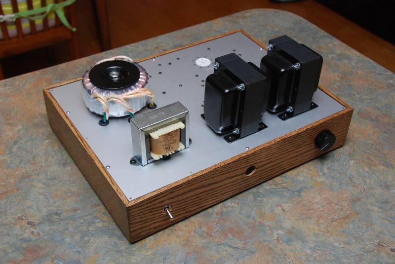

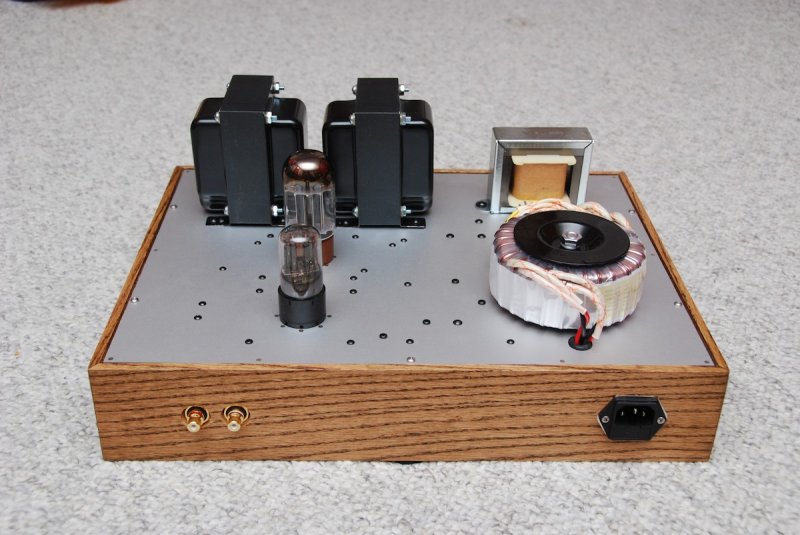

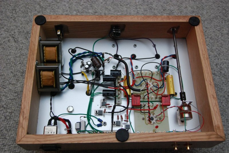

Here's my take on the lilliput amplifier using mostly spare parts that I had around from previous, similar builds. The power supply is a SS rectified, choke filtered design by a friend who also helped tweak the amp circuit to better use parts that I had on had. The chassis is oak with a custom aluminum top plate made by Cam-Expert. I'll try to get the schematics cleaned up in case someone else wants to build a 25lb headphone amplifier. 😱

looks nice and clean inside!
and not a whole lot of components either..
the less the better, methinks

Very nice job. The internal wiring cleanliness is an inpsiration.
I assume it sounds as good as it looks.

Thanks! I cut my wiring chops on a few other projects and figured out quickly that while it take a lot of time and effort to end up with a clean layout it really is worth it in the end especially if you have to do any troubleshooting.
And yes, it sounds quite good to my ears. 🙂
