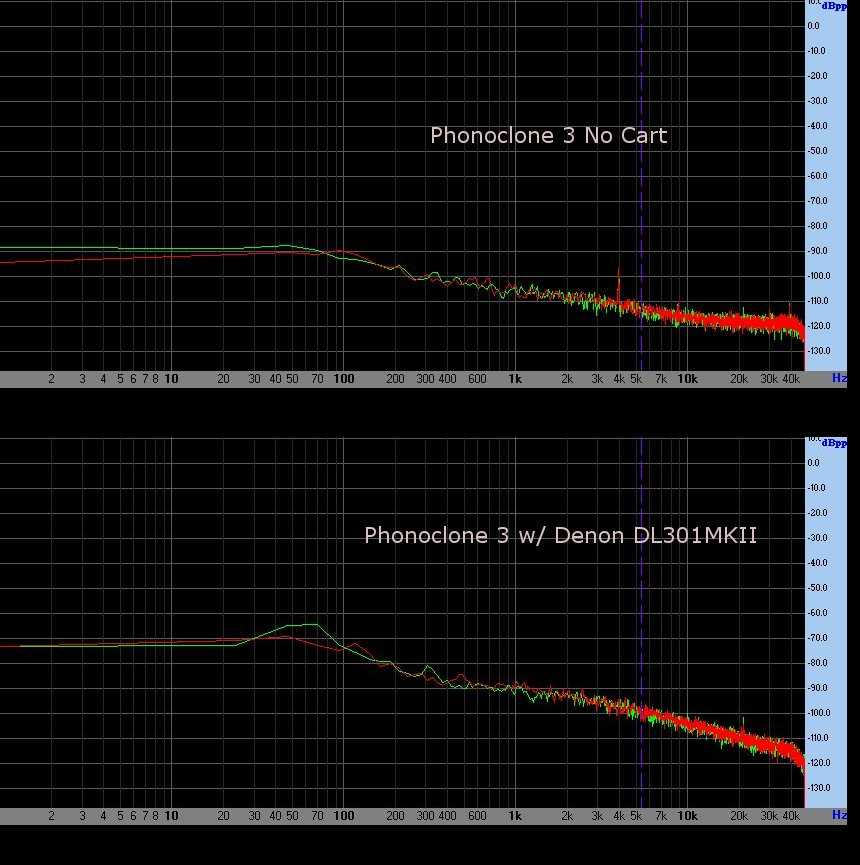

Here's the noise from my P3 with and without my Denon DL301MKII attached. The soundcard input wasn't calibrated so the values are arbitrary.

j_sunne said:Here's the noise from my P3 with and without my Denon DL301MKII attached. The soundcard input wasn't calibrated so the values are arbitrary.

a) Only measurements with the cartridge in place have any meaning, as the cartridge load sets the gain.
