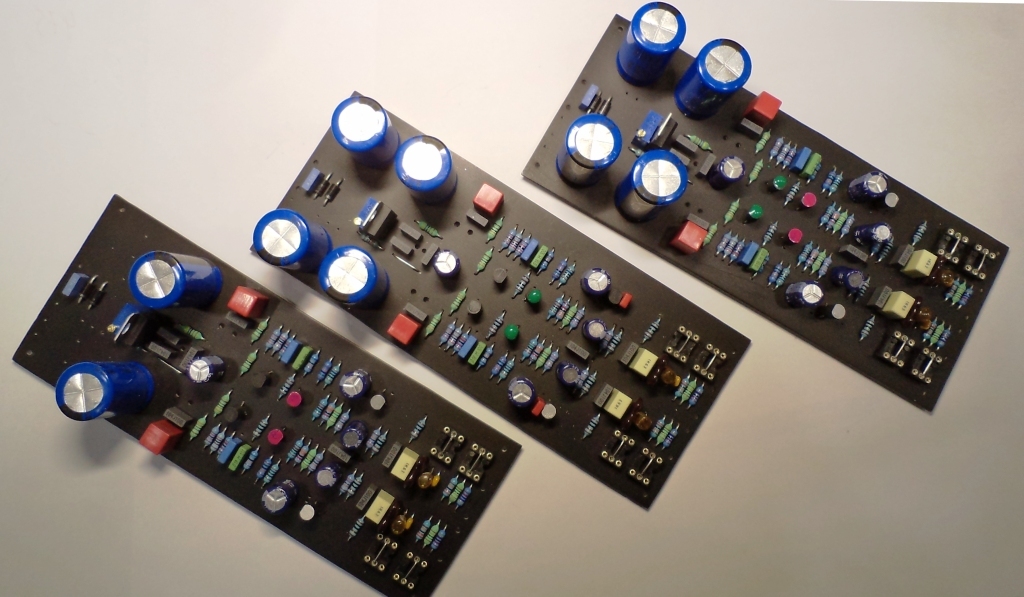

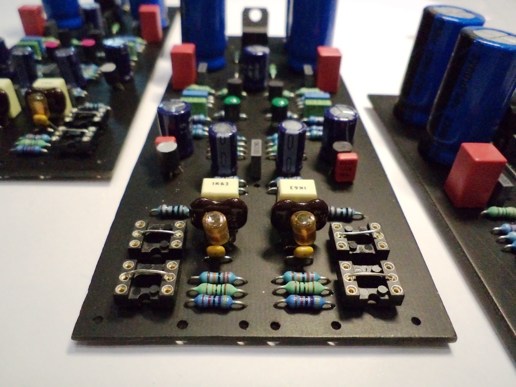

Hi Sakis,thanks for your very fine photos in posting #50. Well done!But what are these amber coloured components next to the input capacitors? Some of them are looking quite like LEDs?!?There's still one point left open: What's the correct value for the resistor between the supply line and the first voltage divider? Is it 100k, as shown in your schematics, or is it 180k, as discussed above?Best regards!
before input capacitors there is a block of capacitors and resistors to define the load of the cartridge since my drawing skills was discussed here i forgot to place this in the input of the phono stage .
In general only the schematic of the phono stage is in question here next to this will be the input block and of course the power supply ..
Amber parts are 100pf styroflex capacitors very rear for most people though sound and perform superb in filter applications .

As said at this point i am at the stage of measuring and analyzing the device so it is expected some things to change hopefully for the best
