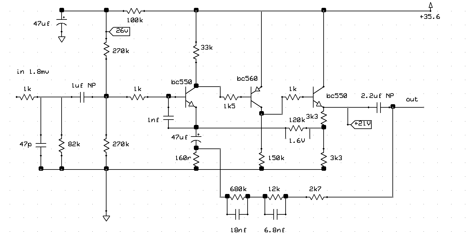

Damir it seems that we play some kind of word game ...But since English is not my native language i can try to explain it better if i manage .
I can place an example if you want ,where there is going to be a number of things that simulations cannot predict but in reality can and will effect the result ...here problem is that things like that are added to the final result .
Let me start with the most simple ...input capacitor is 1uf so we have
1uf electrolytic
1uf electrolytic 0.1uf bypassed
1uf bipolar
1uf bipolar 0.1uf bypassed
1uf MKT
1uf MKP
1uf MKS
1uf MKT 0.1uf bypassed
1uf MKP 0.1uf bypassed
1uf MKS 0.1uf bypassed
Now expect any of those to have small tiny variations in the sonic performance can you simulate that ?
Problem is that all of them are acceptable solutions and all of them will play Still there is going to be some difference in the sonic performance .
I will estimate this to a level between 2-3% ( for many other this is way much more )
Now choice of output capacitor will add for sure another 5-8%
Then choice of semis all your BC 550-560 in your simulator have hfe of 400 ( example ) all of them have exactly 400 hfe and all of them preserve their hfe at any given temperature
Can your simulator comment about that ?
I will guarantee you that matching the transistors closely in respect with the other ch will add easily another 8% of audible improvement .
Farther more a BC 550 from NXP states an hfe of 270 no minimum no maximum
Fairchild BC 550 states 110 till 800
Question: can your simulator or anybody else suggest that for this application the wise choice is 300hfe ( for example ) I expect not ...
You have a page full and we only talked about 3 parts
This is what i mean ....about the simulation ...we haven't even touched other even more critical issue like power supply for example ...we have only talked about a couple of things and narrow the improvement to maybe 20% ....

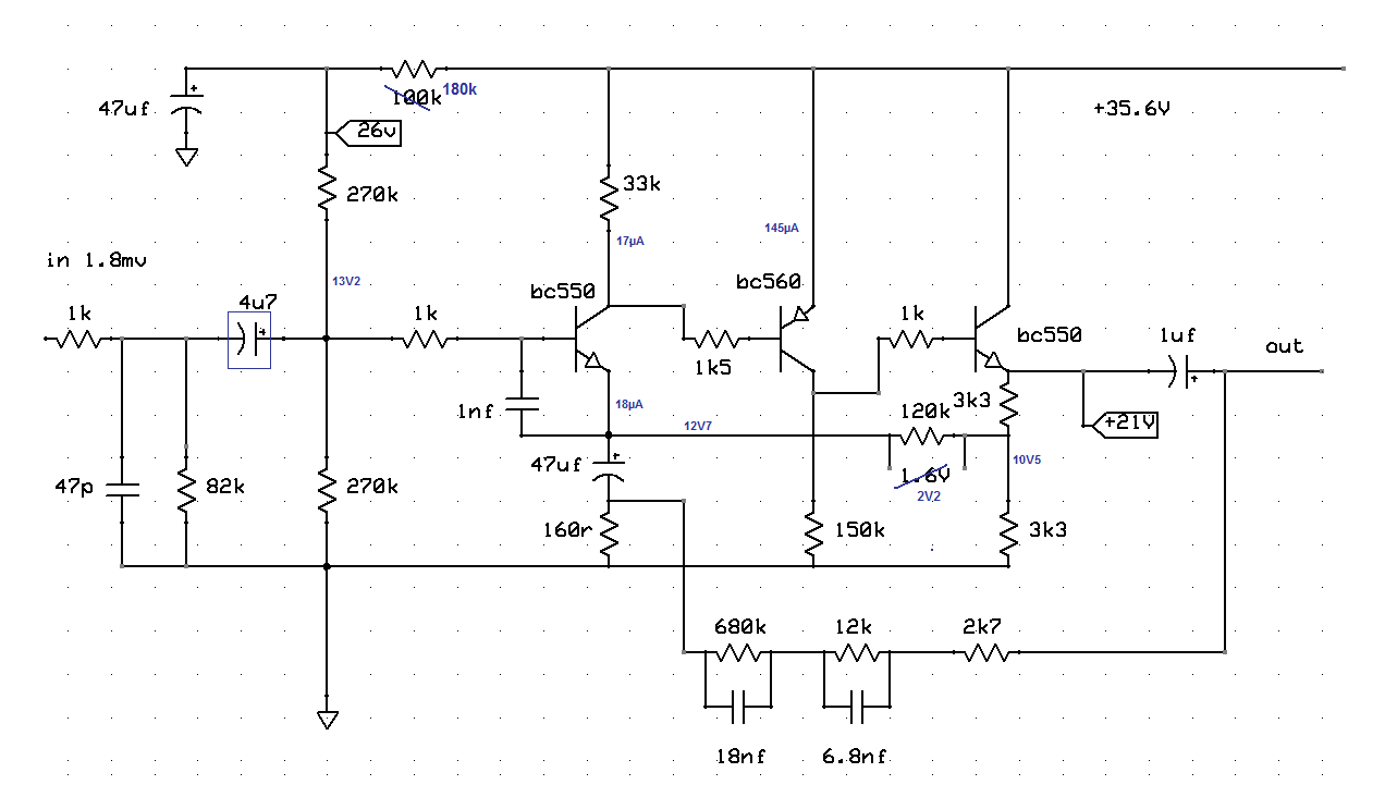

Hi Sakis,thanks for your very fine photos in posting #50. Well done!But what are these amber coloured components next to the input capacitors? Some of them are looking quite like LEDs?!?There's still one point left open: What's the correct value for the resistor between the supply line and the first voltage divider? Is it 100k, as shown in your schematics, or is it 180k, as discussed above?Best regards!
before input capacitors there is a block of capacitors and resistors to define the load of the cartridge since my drawing skills was discussed here i forgot to place this in the input of the phono stage .
In general only the schematic of the phono stage is in question here next to this will be the input block and of course the power supply ..
