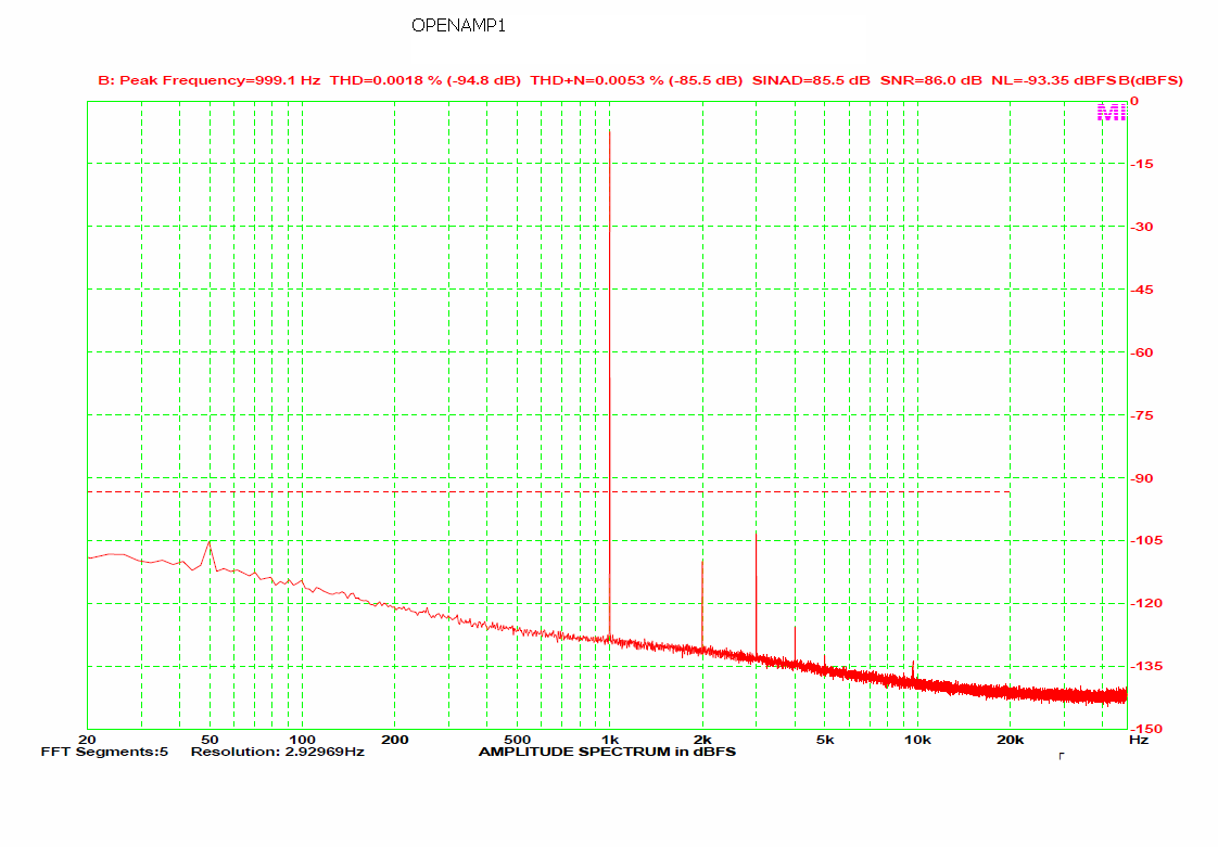

Try decent (I use Sylvania 3 mica) 5751 instead of 12AX7. Slightly less gain, but much better sound.
My phono (used every day): 5751 (green LED bias, 1mA), passive RIAA, 5751 (green LED bias, 1mA), ECC82 (3.5mA) cathode follower.
CCS:
As you can see, this is CCS loaded phono (all tubes!), and almost invisible harmonics.
http://www.diyaudio.com/forums/tubes-valves/246392-c3g-triode-strapped-linearity-question-9.html #85

Perhaps you could take a look at the distortion spectra of my preamp, where everything is loaded by CCS and point out the 3rd, 5th, or higher harmonics. And there's dreaded cathode followers.
I would also like to provide you with one. And my suggestion would be - get away from tubes as far as possible :D
