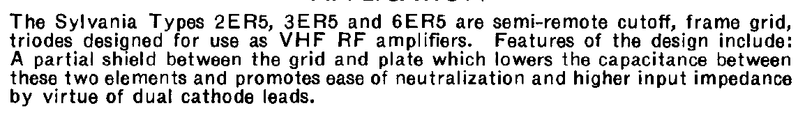

I realize that this is an obsolete thread but it does raise a question about the 6GK5. IIRC it is a semi remote cut-off tube which begs the question how much voltage can we swing before the variable characteristic becomes objectionable.
I don't see anything in the datasheet about being semi remote cut-off. It is a frame grid tube though.

It looks like Mu flattens out between -1Vgk and -.5Vgk (sheet 4). For a small signal amp, that might be a good bias region.
6FQ5 is equivalent, and it does state Semi remote cutoff.

R.f. is not my main field, but I do not know of a frame grid tube being remote cut-off. Anyway as said, for a pre-amp it is used as the phono input tube, strictly a small signal application. (To my knowledge the remote cut-off feature only applies for larger signals; at low bias the Vg-Ia slopes are virtually the same for remote and sharp cut-off types.)
As another example, the 6ER5 is a semi-remote cutoff frame grid triode.R.f. is not my main field, but I do not know of a frame grid tube being remote cut-off.
Yes.Anyway as said, for a pre-amp it is used as the phono input tube, strictly a small signal application. (To my knowledge the remote cut-off feature only applies for larger signals; at low bias the Vg-Ia slopes are virtually the same for remote and sharp cut-off types.)
The GE datasheet for 6GK5 gives a good set of curves. Clearly gain controlled or semi-remote cutoff. Looks OK for small signals if you keep it up at 10 mA.
