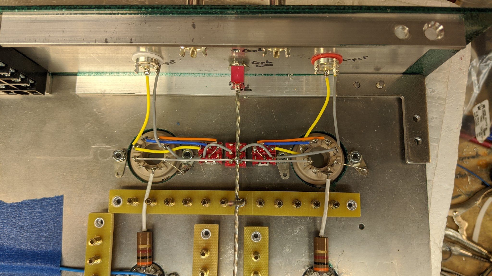

1. A switch for switching between the LL1931 two step up options 1:8 and 1:16. I made a schematic with a 4PDT switch that I think would work but perhaps I made a mistake. Please double check for me. 🙂 Pictures below.

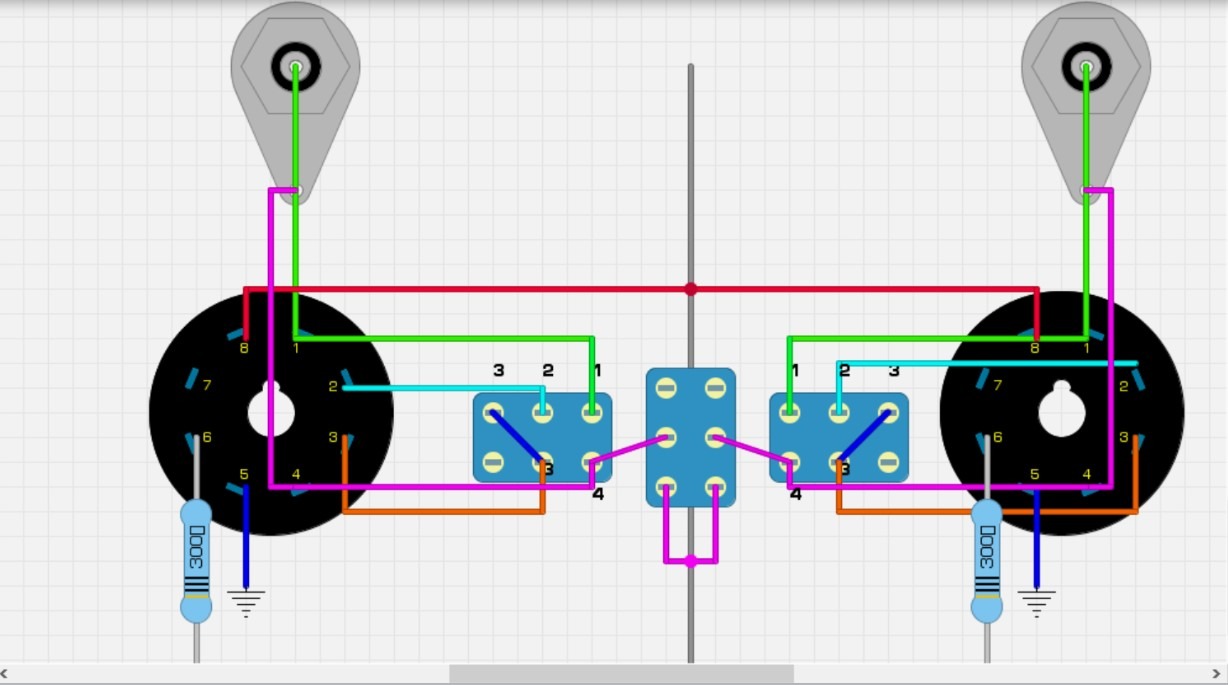

2. I would also like to have a switch that can easily bypass the SUT in case I would like to use a MM pickup. I have made a schematic using another 4PDT switch that might work. However, during bypass mode, the circuit is still connected to the SUTs secondary coil. Don't know if this might be a problem (extra resistance perhaps?)? Please look at it and comment and give advice if needed. 🙂

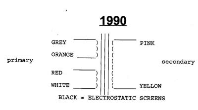

Pic1: Schematics from Lundahl
Pic 2: My 1:8/1:16 switch (this only shows schematics for the switch). The numbers in the switch are showing the corresponding pin on the transformer that it is wired to and not the pin number on the switch itself.
Pic 3: SUT bypass schematics. "In" on SUT is pimary coils and "Out" is secondary coils. Secondary coil is within the active circuit in bypass mode. Bad idea?

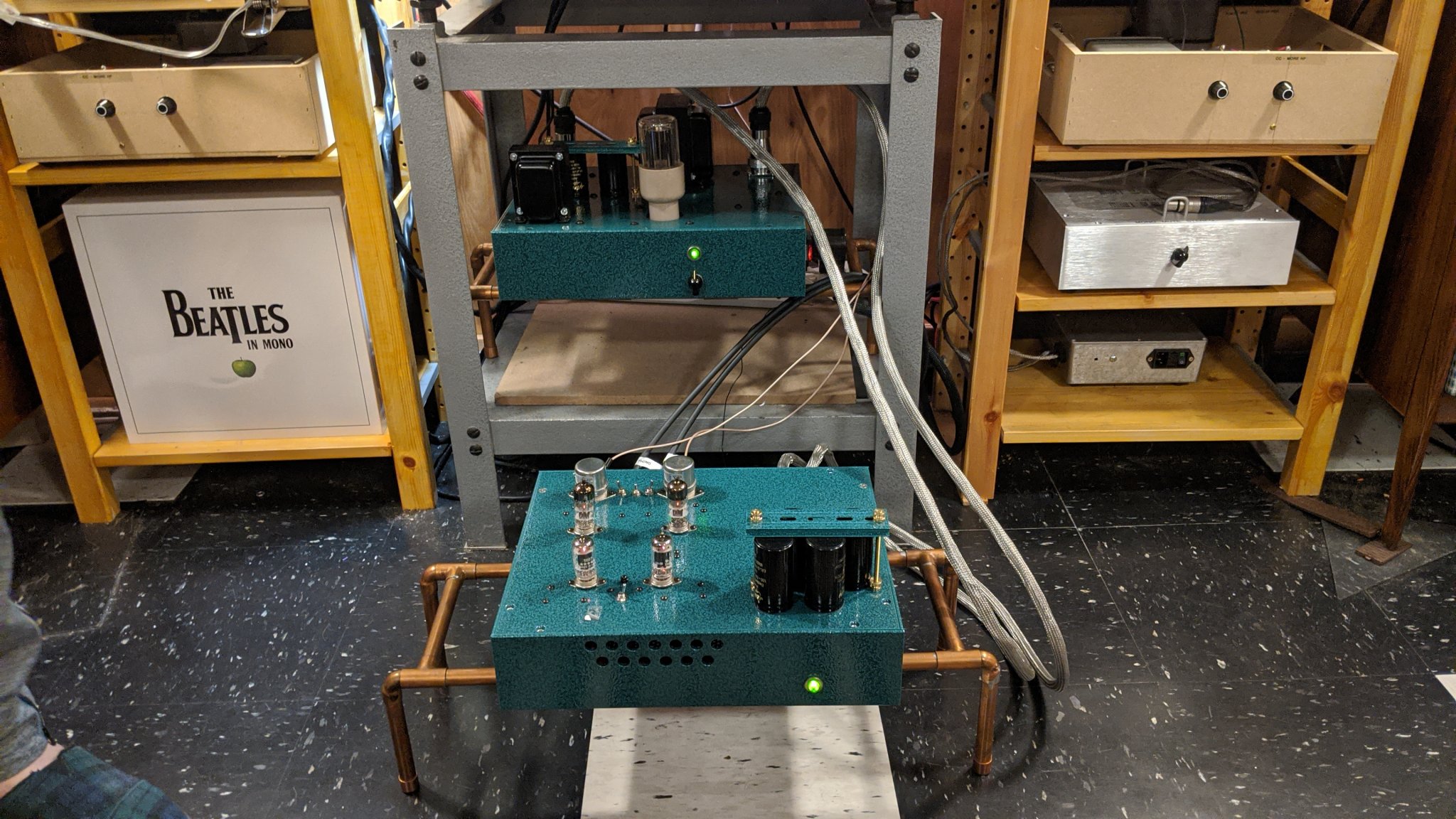

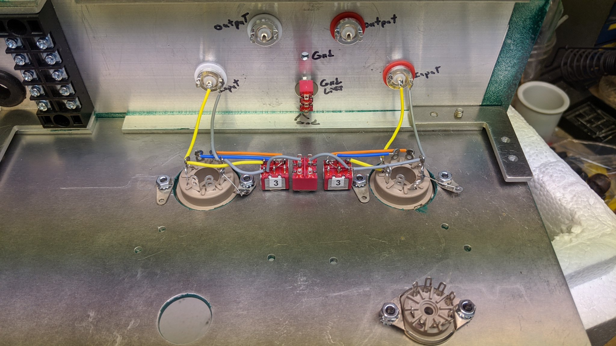

I built a tube phonostage and used octal based Sowter SUTs wired so they could be plugged into the top plate from the outside. (see last picture) I thought it would be quieter than having a SUT connected by a set of interconnects. Not so I found. At some point I pulled the octal based SUTs and built some jumpers with socket plugs and wired to jump the sockets in order to try a stand alone SUT. I found that with minor repositioning, I could get the background noise level much quieter than I ever could with the built in SUTs. Crazy

Well, mine had it's power supply six feet away so that wasn't a factor. The ability to move the SUTs turned out to be helpful, even an inch or two could make a huge difference I found. I thought I had done a good thing only to be proved wrong. I do not have an expert opinion on your switches/schematics as I am far from an expert. Here is how I ended up wiring the SUTs I just jump them externally if I need to bypass them.

Not such a good idea to have all that wiring and the switches before the phono inputs,
where the signal levels are extremely low. I would rather have two separate phono stages,
one MC and one MM, before doing that.

I didn't think about that. If this solution compromises sound quality and noise level I will get rid of the switches. I don't think I will change cartridge that often, but flexibility is nice though. However, one version of the original EAR834P had a MM/MC switch and a built in SUT, and also some high end SUTs have switches for different gains and impedances, but certainly better implemented than my idea I suppose. I have seen som DIY PCB boards with a switch for different gain that probably have a much shorter signal path than my idea. This one example: https://www.diyaudio.com/community/threads/lundahl-ll1931ag-stepup-transformer.379447/

I have looked around on the net some more and found that for the most part people (and commercial products) then to have separate inputs for MM and MC and route both of them to a switch where one goes directly to the phono stage and the other have the SUT directly after input and then goes to the switch and then to the phono stage. I think that is how I will do it. 🙂
