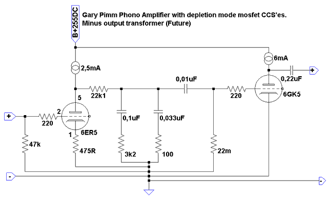

Thanks for the suggestions.
@Sy
yes, I know 'FragJanZuerst' - a good recommendation, thanks. It is a very good shop, he has great transformers with reasonable prices and the F&T MKP caps he sells are a good choice to my ears. I just did not find a 6GK5 there (maybe I should look a bit more carefully).
If I understand you correctly, you would dump the entire RCA topology and go for something completely different.
I followed some of your projects here with interest and trust your recommendations. Any hint which way to go (other than the RCA topology)?
Keep in mind that I would like to have a +/- simple topology.
I am still in the process of re-reading Morgan Jones' book.
@revintage
would you use the D3A triode-connected or as pentode?
Thanks,
Martin

Don't think you'll find them on mainland Europe. Mostly in the States and Japan. Therefore you might as well go for the D3a. A German tube. (Triode-connected)6GK5
Martin,
The D3a could be used either way but Zout will be higher going pentode. Think Dave Slagle did some calculations and found Ra=12k (=Zout) being the best. In this case probably triode-strapping is the best.
Martin, it's not so much the topology as the implementation- a passive RIAA sandwiched between two gain stages is very viable, just not the RCA version (designed for cheep'n'easy). I have a phono preamp project which will be appearing shortly. I would also recommend any of Allen Wright's designs, Kevin Kennedy's phono stage (some great similarities to mine), or Gregg the Geek's. If you have Valve Amplifiers, the phono stage designs in there are excellent, and use ECC88 or 5842 as input tubes.
R1 needs rp included if there is NOT a blocking cap right before it. It will shelve up/down the mid highs as a plateau. There is good reason to put it in the end of the passive filter, coupling to second stage though.That is it usually gets to be a much smaller cap and the limited bias current of first stage does not struggle to slew by having to charge a large enough cap if right after. Also smaller caps can be afforded easier for better dielectric quality. <snip>
@ Eli
Salas makes a very good point about the location of that first coupling capacitor although I just tend to make it pretty large (and expensive.. 🙄 ) To minimize interaction with rp over the life of the tube you do want to make R1 about 10X larger than rp, but don't get carried away with this because the johnson noise of R1 brings up the LF noise floor significantly. (More of an issue truthfully with very quiet high transconductance tubes because you don't want to degrade the noise performance with a resistor that is much noisier than the tube driving it..)
My take on the Lipshitz circuit is a little odd, I place the bias resistor before the actual network right after the coupling cap - because this eliminates the issue with dividing down the gain as a ratio of R1/Rgrid which because I don't use grid leak bias is a significant effect.
You need to take the thevenin equivalent of rp+R1//20M in your calculations for the equalizer network - though its effect will be small. Whether or not you do as Salas suggests make sure the pole introduced by the coupling capacitor and R is <5Hz for good results.
I have seen Sy's latest design and would strongly recommend it as being well worth the wait. SY and I have generally similar approaches to this problem and I believe his design will be a little easier to get working properly. My current design has not been published to date, (it's almost 2 yrs old now) but will probably eventually show up on Positive Feedback if I can get my act together and write an article about it. 😛
The D3A in triode mode is a spectacular performer. It really redefines the meaning of the word quiet. The johnson noise due to winding resistance of a typical MM cartridge will probably be 10 - 12dB noisier than this tube, a good high output MC (low dcr) cartridge might be just a few dB quieter than the tube. The typical 12AX7A based front end is typically at least 3dB - 6dB noisier than the noisiest MM types IME.
Not to steal my own thunder, but.. agreed on the MM, disagree on the MC. Input referred equivalent noise resistance of the triode-connected D3a is 65-100R. Now a low DCR cartridge will be something like 3R, right? That works out to about 13-14dB more noise from the tube compared to the cartridge, if I'm doing the math correctly. And that doesn't count the noise from the mandatory grid-stopper.

PC88 datasheet sates an Req of about 240R which is among the best, common to the double triode 6922 family. It brings you down to 2nV/rtHz. If you parallel 2, you go to about 1.42nV/rtHz. Comparable to a single low noise Jfet. A C3M trioded gets down to 2.6nV/rtHz for comparison. Better do that with a PCC88 though which has the single envelope advantage, keeping things tight and common Tc.
