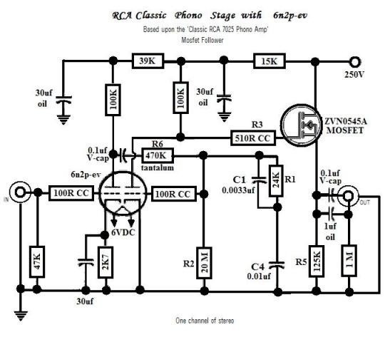

If you want to build something at modest expense that performs competently, you will be (IMO) very hard pressed to do better than the tweaked RCA design. While, it's not SOTA, it is quite competent. Those of us who worked on the setup were determined to correct as many weaknesses as is possible in the RCA original, without "getting crazy". The MOSFET follower at the O/P provides substantial drive capability. Grid leak biasing the 2nd gain block improves bass extension. High Miller capacitance at the I/P is a fact, but many MM carts. work well. Properly selected 12AX7s yield satisfactory noise performance.

While you're at it, you might mention the astonishing linearity at high voltage swings. The first time I had one on the spectrum analyzer, I thought my equipment was broken.

A really nice rework Eli. Nothing's as much precious to DIY as an easily repeatable inexpensive project with proven tone. Those kind of projects are giving value and widen the appeal of the hobby.
