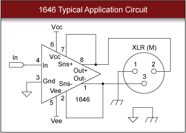

Sorry mate it is balanced
Got picture for you
Al
