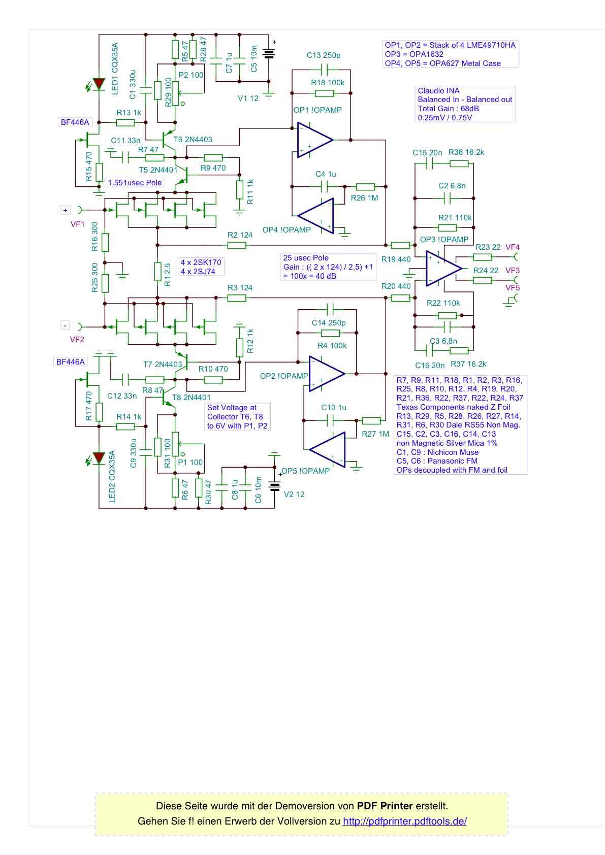

Bksabath, here is my original schematic. The version shown was for a very demanding customer so it has some very expensive parts in it.
What is not shown is the servo. For more details i sugest you do youself a favour and get you a Linear Audio Vol.0. That bookzine has a lot of other interesting articles.
The servo shown there works only when you transfer balanced into unbalanced at the output. I designed a new servo that holds the DC offset to less then 1mV, single ended and differentially and it will be published in a follow up in Vol.1 i hope.
As soon as we have stuffed the new PCBs and tested them, i will also publish the changes on my MPP thread. Jacco, thanks for the enthusiatic words. From my point of view it´s a classic.
P.S. concerning the noise, when i compare balanced to unbalanced, balanced has a 3dB noise disadvantage provided we use the same amount of input devices, BUT it is much more robust in terms of hum pickup, so in a realistic setup it may be less noisy overall.

I just had a quick look at the schematics have you tried THAT 1646 as balanced line driver
I will start to use them in the next couple of weeks but from specs look like the OPA1632 may be a better choice
So tanks for that pointer as well
