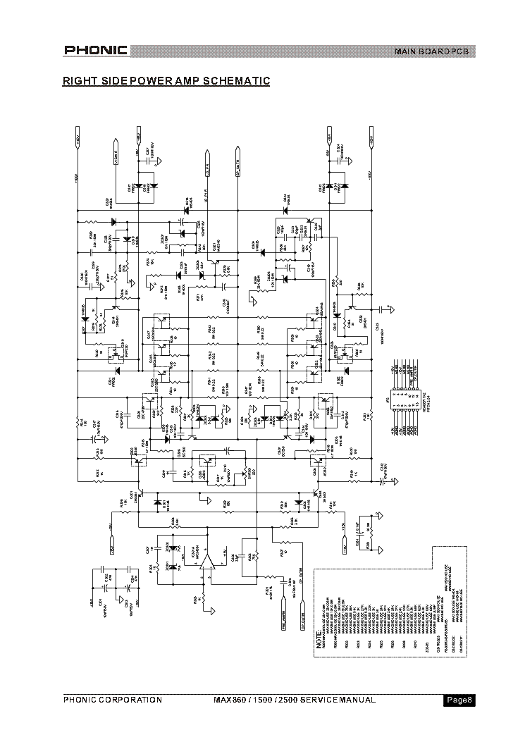

I just have a question about voltages in Phonic MAX2500. Can somebody tell me exact voltages for this amp??? Thanks
PSU voltage?
Yes, power supply voltages and just want to see differences between MAX1500 and MAX2500 power supplies. I have toroid transformer from Behringer EP2500 and planing to put it in to Phonic MAX1500 if it is possible (voltages are cca 4x38V AC).
Service manual attached.
Sorry only one page attached, as the whole file is too big...
Sajti
Sajti
Thank you for schematic but I already have it. In service manual I have described all tree models but with only one schematic attached. On that schematic voltages are +90,+55,0,-55,-90 and I have found those voltages on my Max1500 but I do not know voltages on MAX2500 because it is not described separately in this service manual. On this sheme I see voltages +100,+55,0,-55,-100. Is it correct value for max2500?
