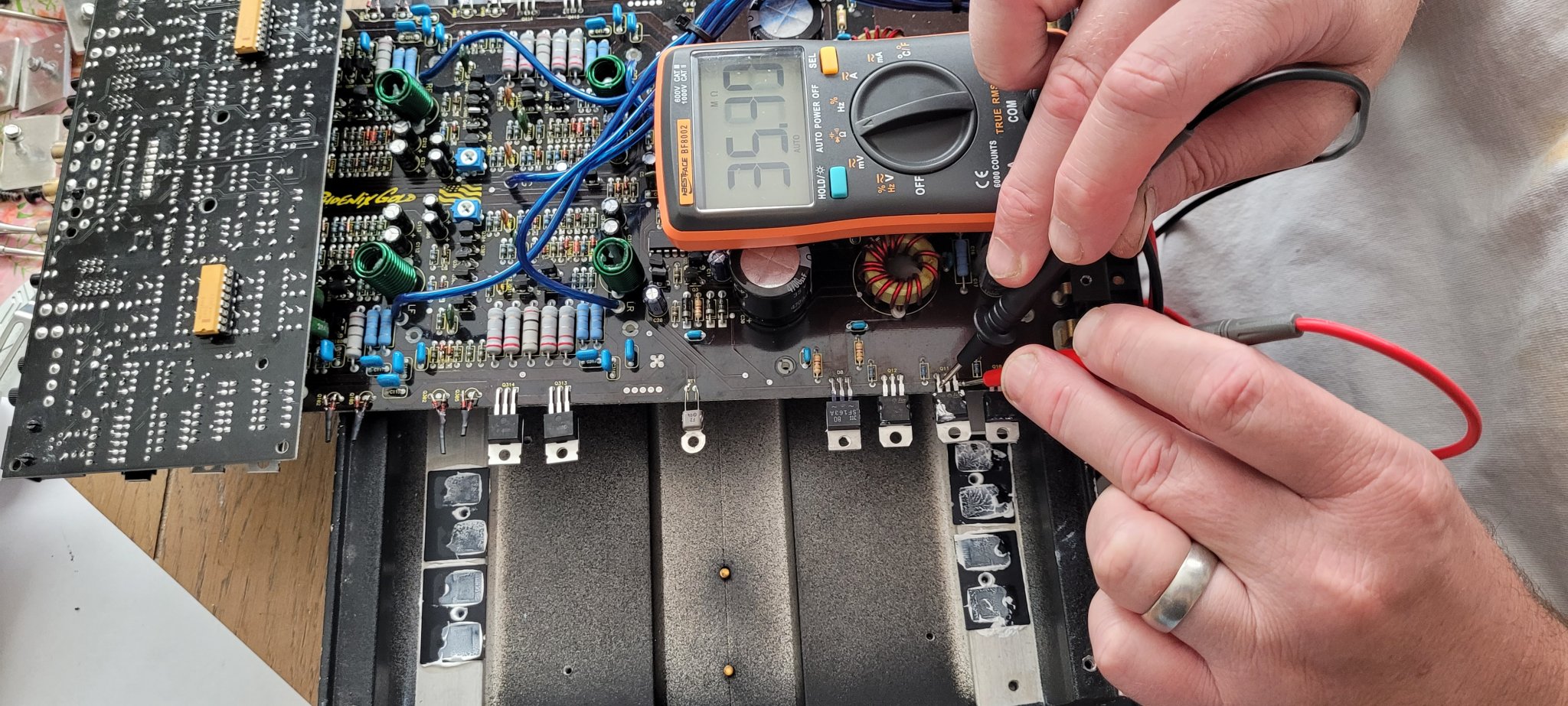

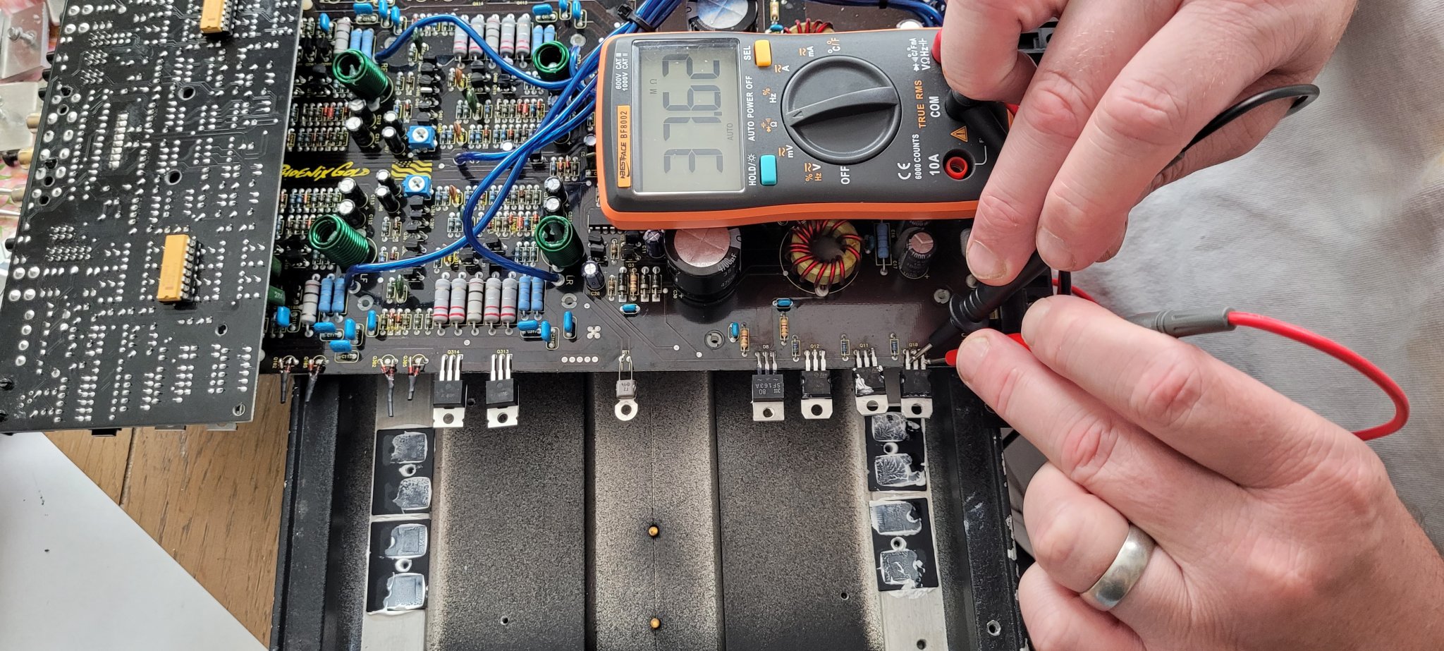

Don't put Q8 back in the circuit. We know it's bad and will skew all readings in the bank it's in (at least).
Q8 removed
Q7-s-g, 8.97 m-ohms, g-s O.L
Q8 removed
Q9-s-g, 8.9 m-ohms, g-s O.L
Q10-s-g, 9.29 m-ohms, g-s O.L
Q11-s-g, 9.26 m-ohms, g-s O.L
Q12-s-g, 9.29 m-ohms, g-s O.L
Q8 removed

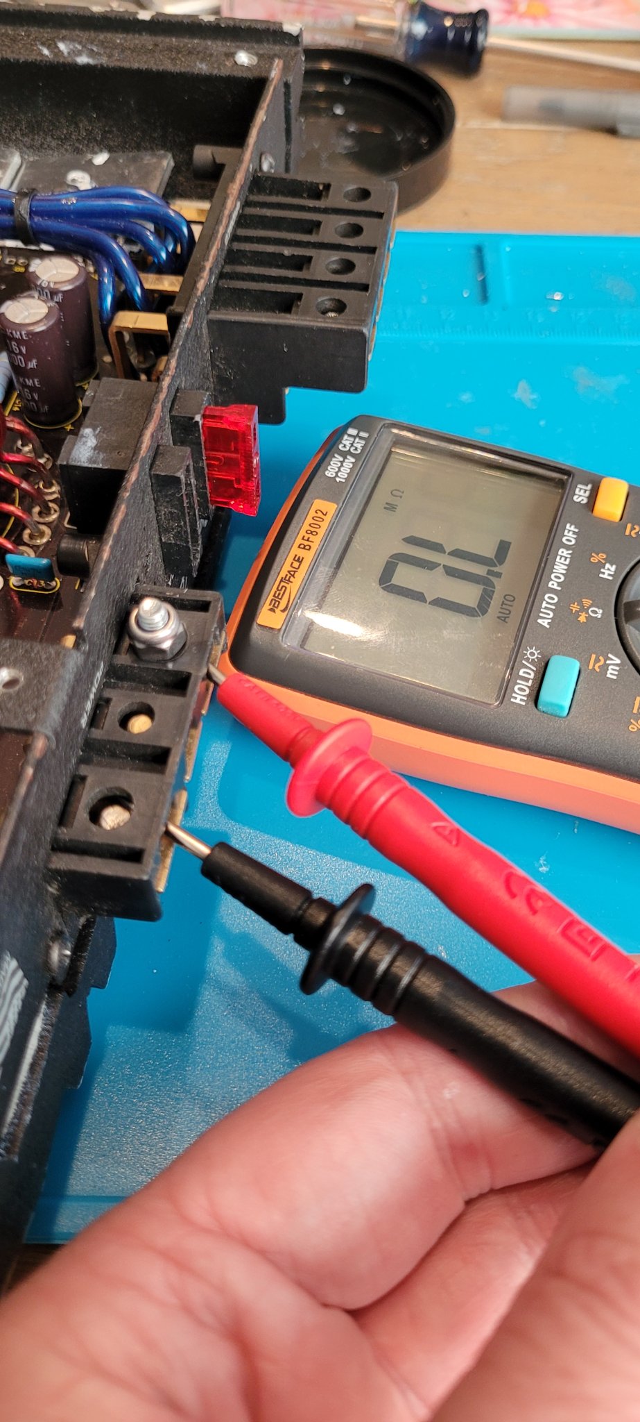

When you read OL across the B+ and ground terminals, was there a good fuse in the fuse holder?
If not, install another fuse and read across those terminals.

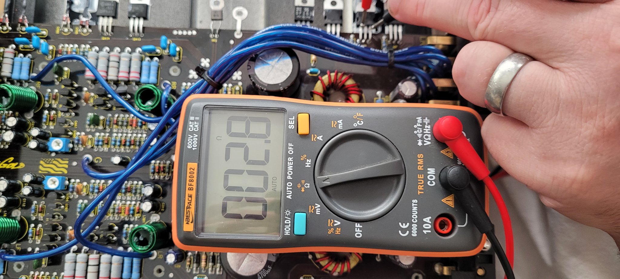

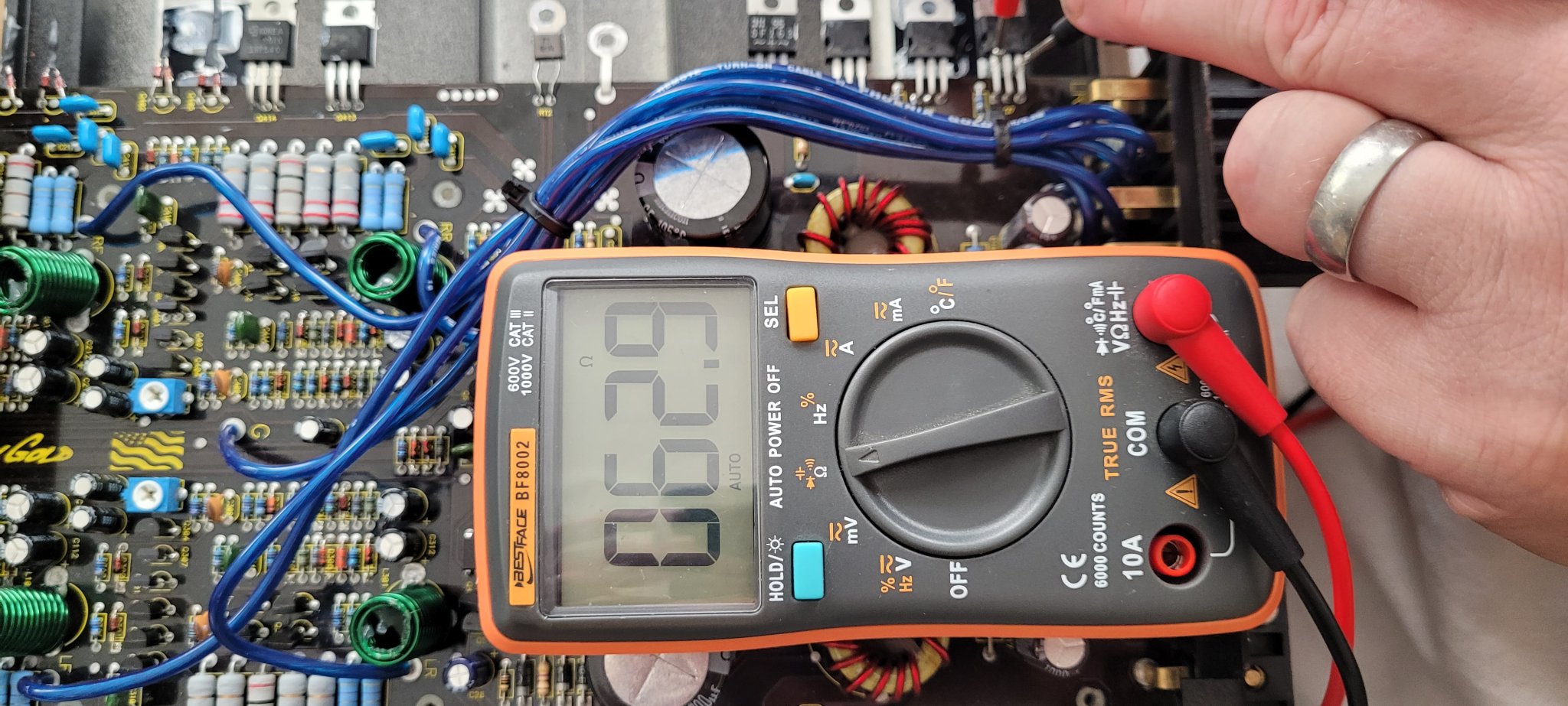

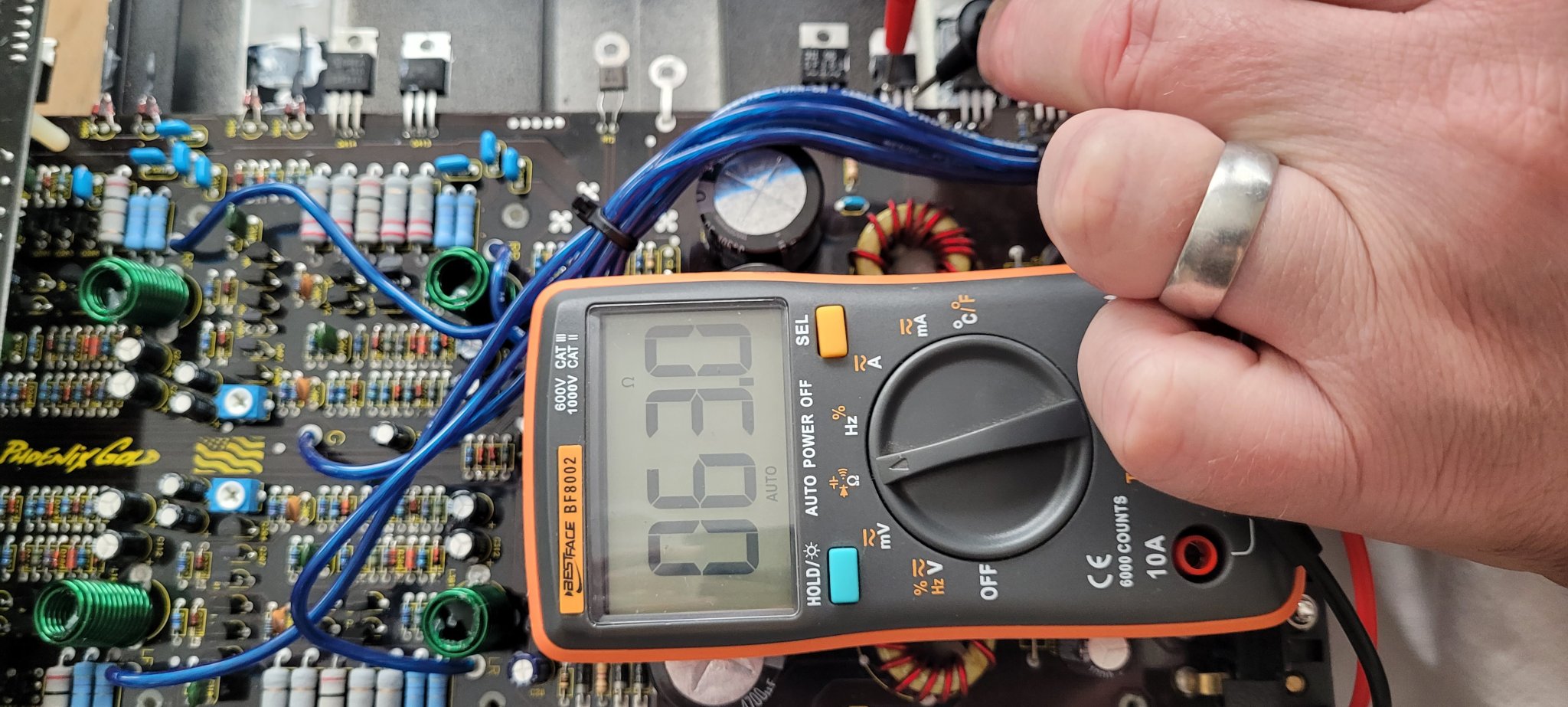

With remote connected, what's the DC voltage on the gate and drain terminals of the PS FETs (black probe on the amp's ground terminal)?
When I connect B+ and ground with ps fets removed the amp powered up and the green light lit up without a remote connected.
I will check voltage and post results.
