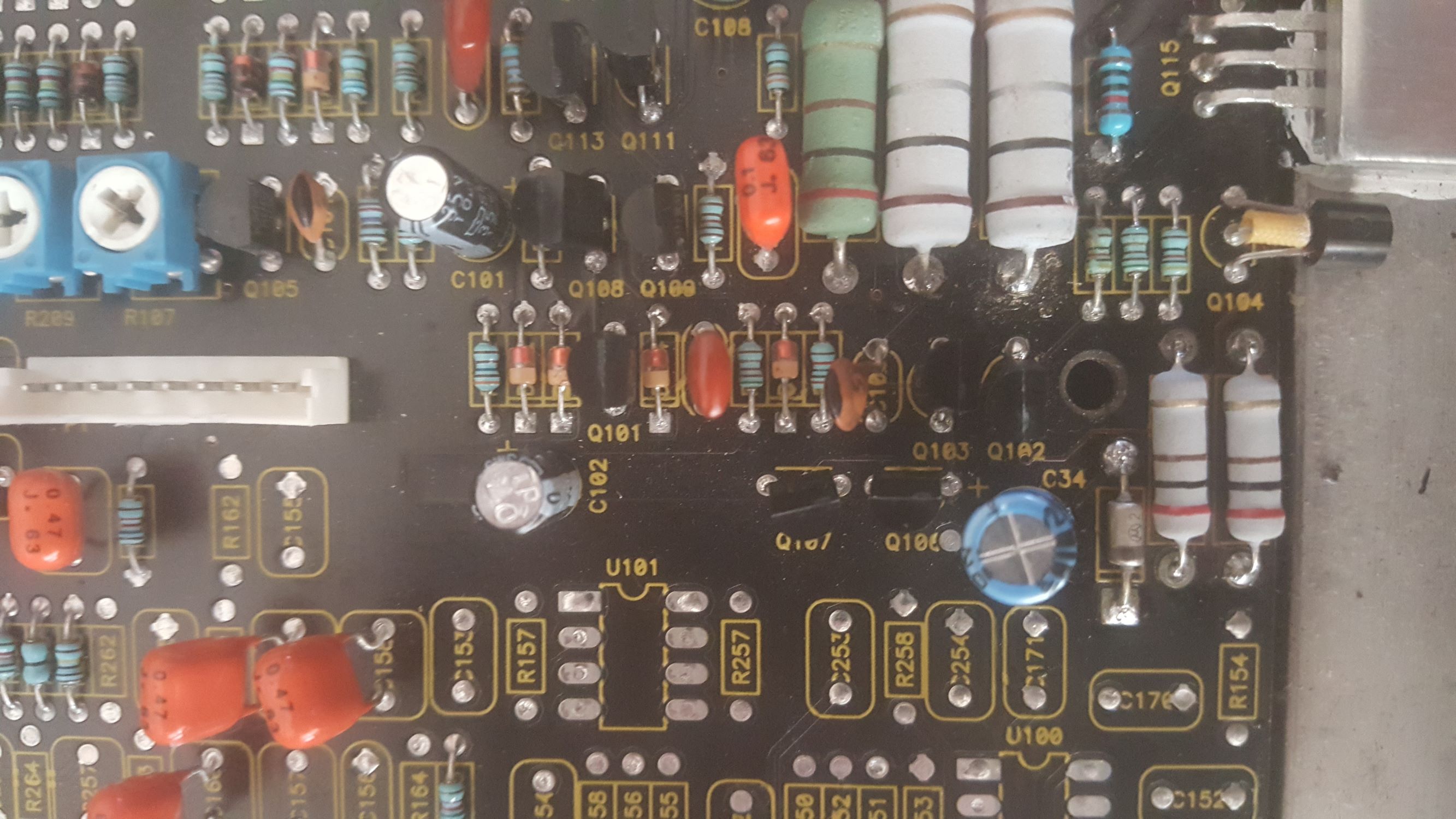

This is the area that is getting hot. (Q102,Q103,Q104,Q107, C34, the two 1W resistors)
Above post, I stated voltages on the zener diode, they were incorrect. Voltage on the 1n4744a 15V zener is 18 Vdc on the cathode and 0.000 on the anode.
The voltage drop across the the two 200 ohm parallel resistors is 10 volts, 28 Vdc to 18 Vdc.

I have a question about the zeners. They are reversed biased and being used as a voltage regulator, by design, being rated at 15 volts shouldn't the voltage across it be close to 15 volts if they are working properly, assuming input voltage is greater than breakdown voltage?

The Zeners have an internal resistance and that will make their voltage change with the current that's being driven through them. If the two 1k resistors are in parallel, you could lift one to see if the lower current would reduce the voltage across the Zeners. It's also possible that they have both drifted in value.

The two resistors are 200 ohm each and are in parallel relative to each other (not sure if I am explaining that correctly) and in series from the drain of the IRF540 and the cathode of the zener. They are new and read ~100 ohms in circuit.
I connected the preamp board and the voltage dropped to +/- 16.4 Vdc. I will try and lift one of the resistors to see if that changes anything.

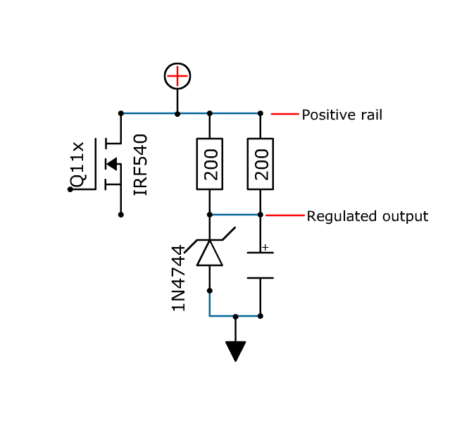

Attached is what I was trying to explain with regards to the regulator circuit.

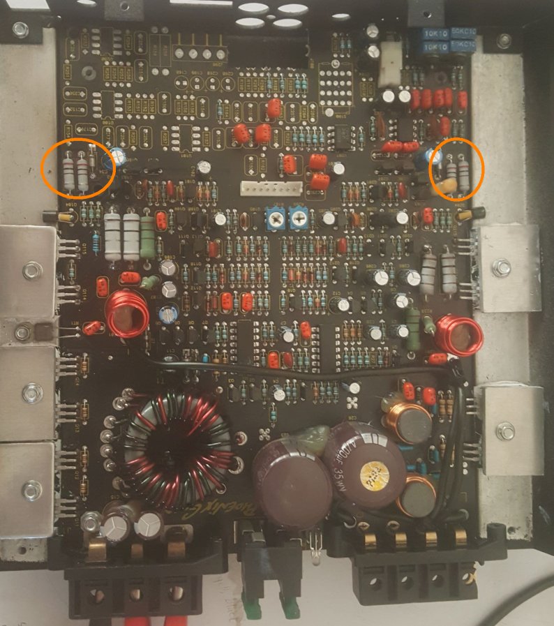

Do you think the 16volts is okay for the pre-amp board? I can see that in the past there has been a lot of heat in that area on both channels. The board is discolored under the resistors and the standoffs that help support the pre-amp board have some melting that has occurred.

16v isn't excessive. If you replace the Zeners, that will tell you if it's normal for them to go that high or if it's likely due to the high current.
When drawing a diagram, the highest voltages are typically at the top of the diagram. The rail voltage is the source of the voltage to the resistors. The resistors allow the voltage to drop at the cathode of the Zener. The anode of the Zener is grounded. This is the positive regulator. The negative is similar but reversed (cathode of Zener is grounded), resistors connected to the negative rail.
When/if you need to draw other diagrams, include the circuit board designation and value for all components. It's also best to find software that allows you to draw on a grid and to make/use libraries of parts. That saves time and allows consistency.
The heat stress that you see is common for this type of shunt regulator.
