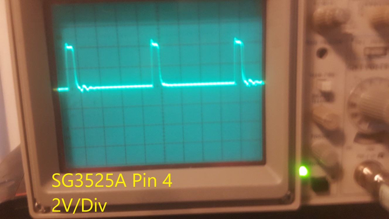

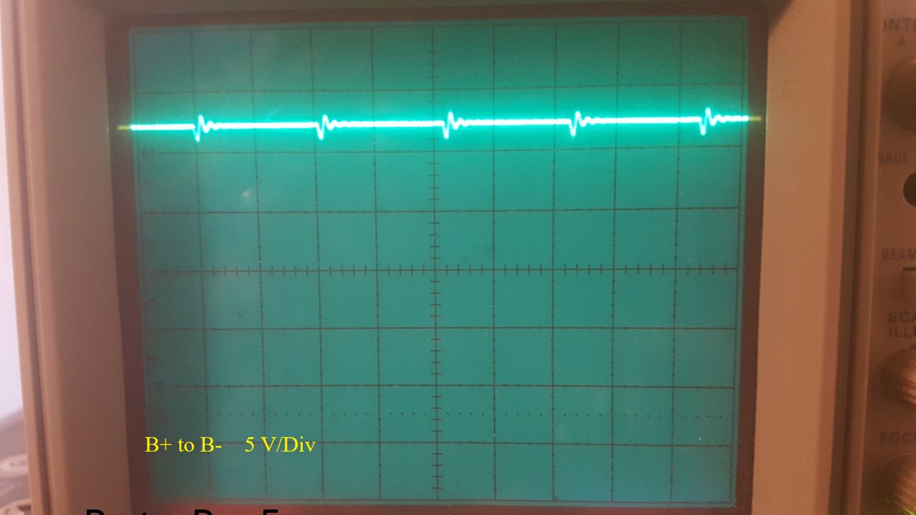

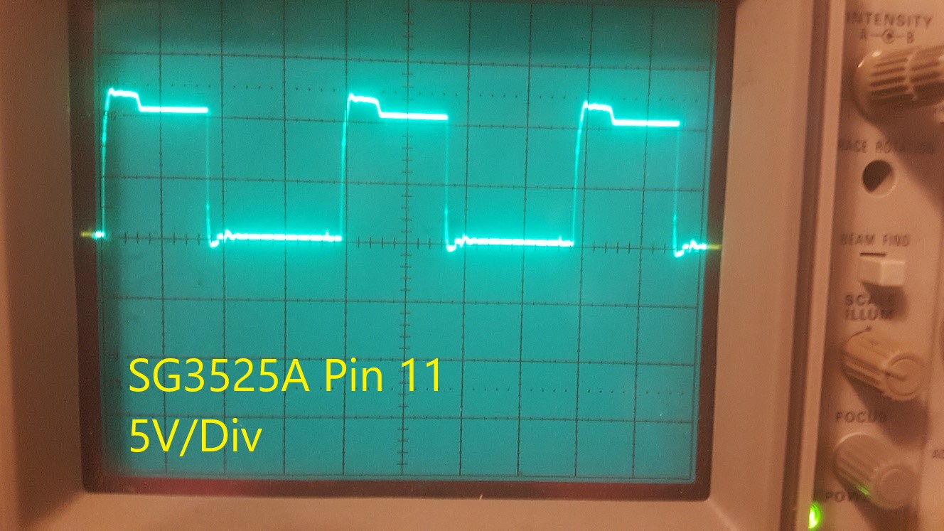

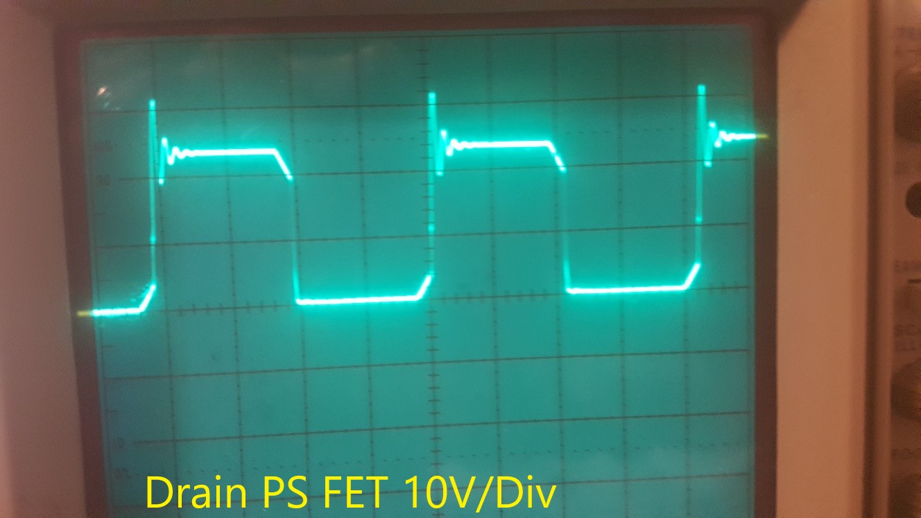

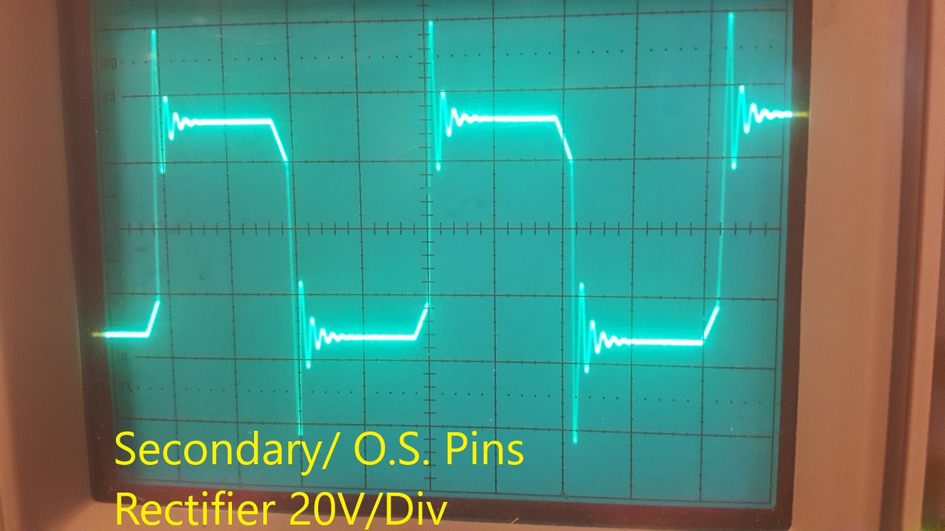

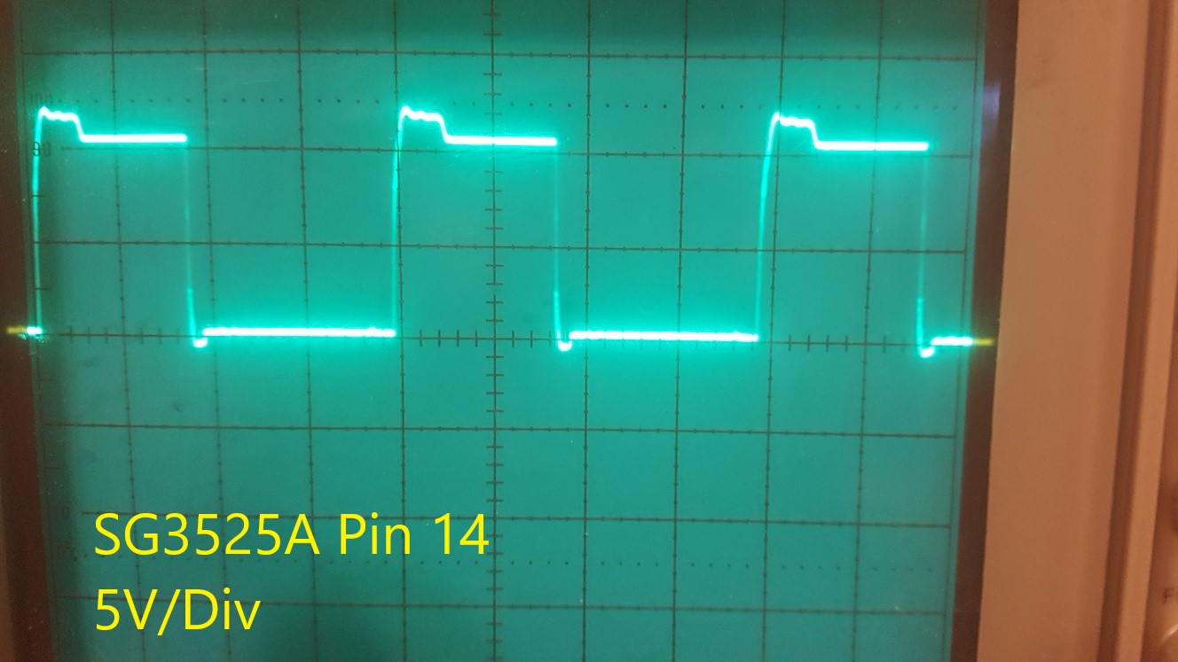

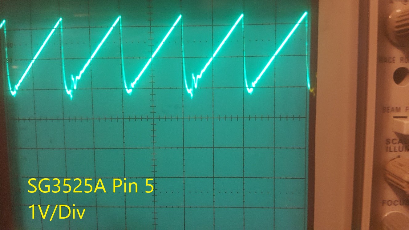

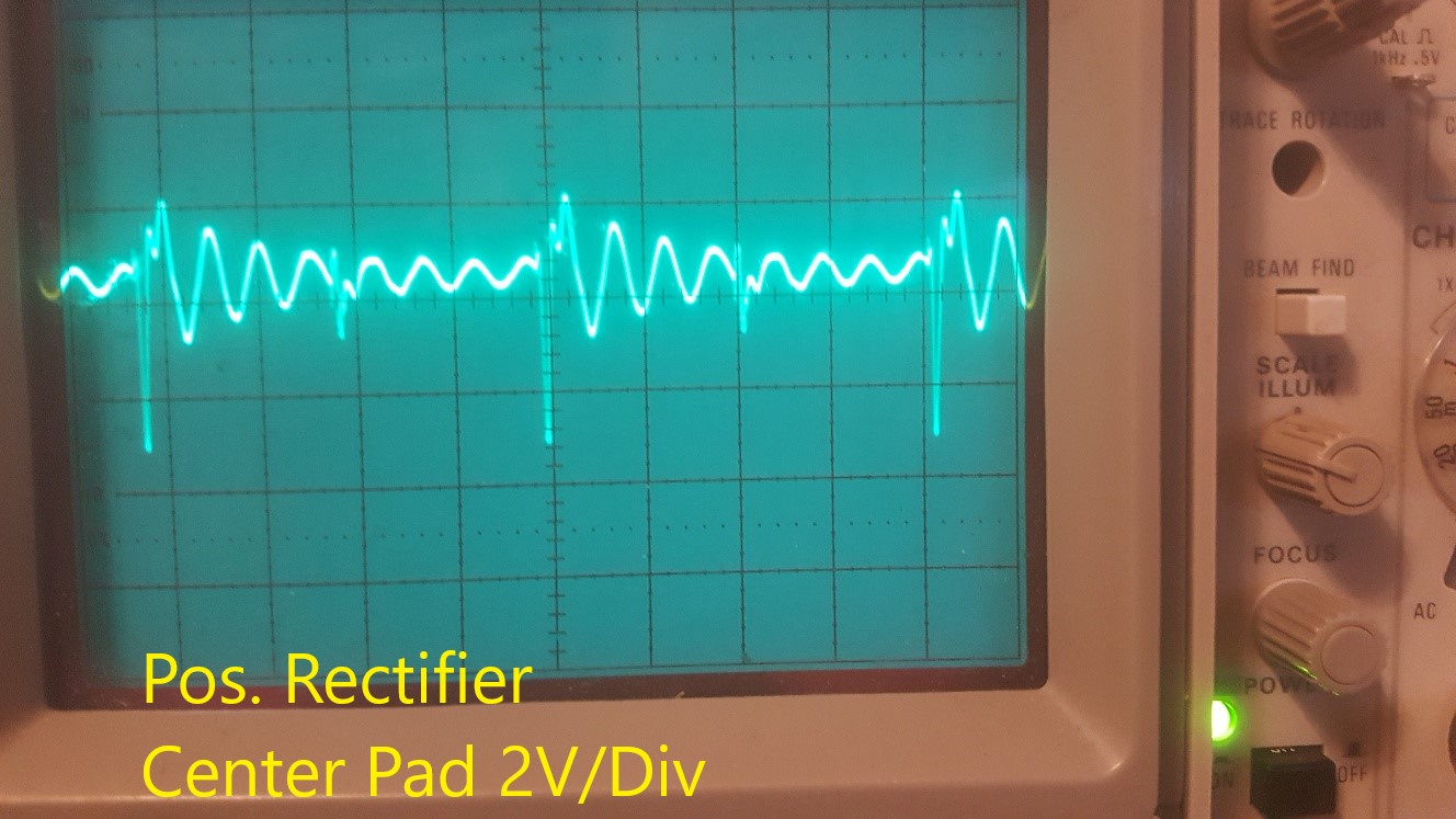

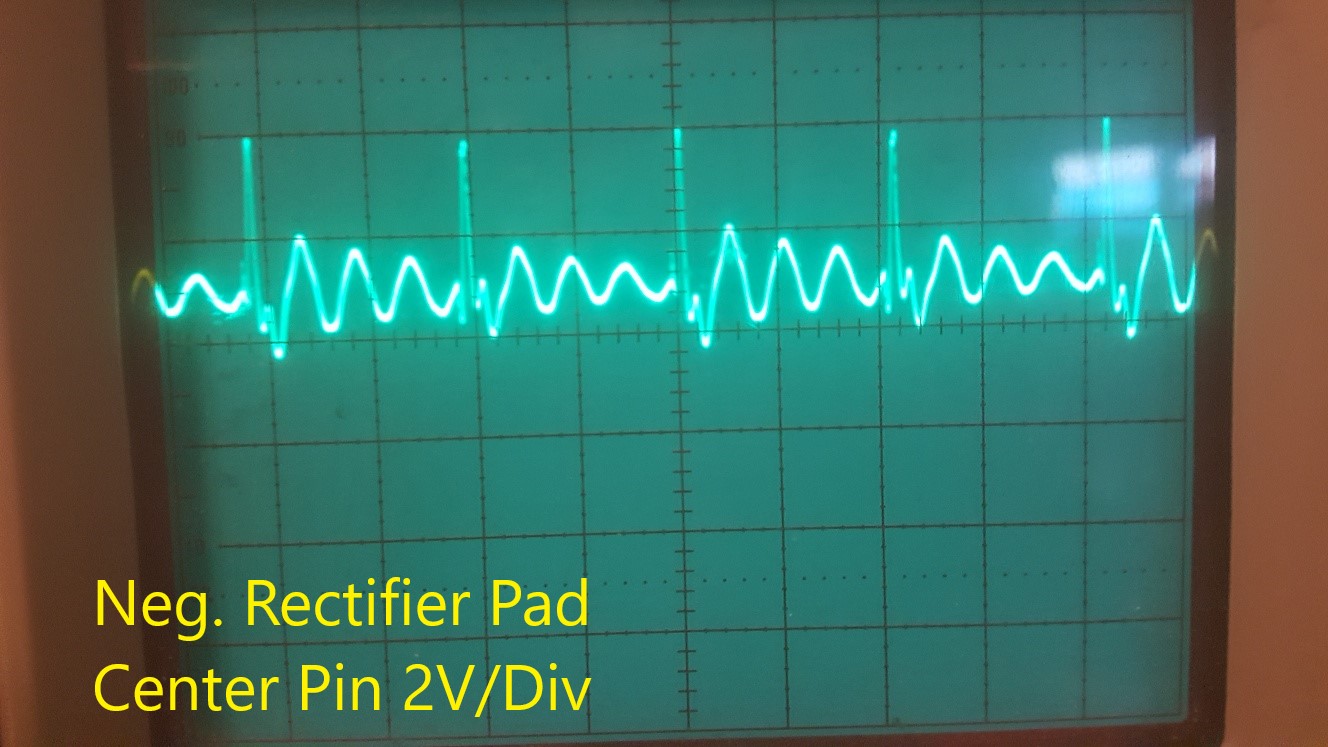

Could someone please look at these measurements and help me figure out what the spikes are at the first part of each wave?
These were taken on the power supply with the rectifiers removed. The external power supply was set to 12 Volts.
Should there be dc voltage on the center pad of where the rectifiers go? This particular amp has a black board that is two sided and shinning light through it and with my old eyes, I am having a tough time following the traces.
The DC on the secondary is insignificant. If it matched the DC supply voltage, that could indicate that the transformer was shorted but that's not the case here.
The ringing on the rising edge of the drain waveforms isn't significant, at this point. This could change significantly after the rectifiers are reinstalled.
Is the gate waveform for all of the PS FETs (taken from the gate leg) identical for all of the PS FETs?
Some of the noise that you're getting is likely because you're relying on the scope ground to the 12v power supply ground. This generally works well enough and virtually the only thing I ever used but if you want to get better waveforms, you need to use the short scope probe ground lead. You must be VERY careful not to short the probe ground to adjacent pins.
For the PS gate waveform, you'd ground the probe to the source leg of the FET being tested.
For the driver IC waveforms, you'd ground to pin 12.
Perry,
Yes, on the PS FETs gate, the amplitude, pulse width and period are the same on all four FETS using the divisions of the scope to calculate. When using the DMM the difference in amplitude between two pairs is 0.19 Vdc.
The rail capacitors appear to be bulging at the tops. I ordered replacements but they are to tall, so I will have to reorder the correct ones. I could put the ones I have in for testing if that is suggested.
On the KA339 Comparator the only difference of the inputs and outputs is on the #3 comparator the + and - are reversed, (-) = 4.92V > (+) = 3.83 and output = .046 V. all other inputs were the reverse of this and outputs around 5 V each.
If the PS looks good for know, I will move on to the audio side. That is where the main problem still lies as the high current draw ~10amps at idle has stopped with the rectifiers removed. I think I will start pulling the zener and small signal diodes and checking them as well as replacing one resistor I found with much higher resistance than indicated by the markings , 1.8 Kohm vs 51 ohms respectively.
