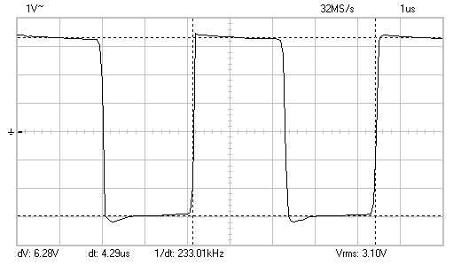

Running UcD at 233 kHz :cool:
PSU +-25VDC
It's still quite hard to get startet though:xeye:
Think next step will be to implement the normal current mirror in the comparator, as Chris has pointed out a number of times :), at it is running with 13 transistors in all at the moment.
Hope this might get it to start much easier. ..... might be because the gain in the comperator is too small at the moment, hvich will be increased with a current mirror, instead of the two collector resistors imployed now:rolleyes:
That might be part of the problem -- breadboard circuits can introduce significant capacitance, just where you don't need it!
Maybe the breadboard layout is changing the characteristics of the phase lead network -- and making oscillation difficult to start?
Just a thought! :)
