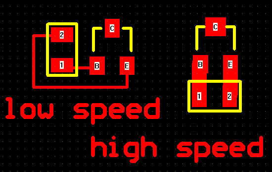

the pcb must be to design it at highspeed mode(i dont know how to say it in english,sorry )
if u can design the PCB base on 50MHZ or higher
it will be group up the PWM freq
I think I understand what you mean. Where can I read the tutorial about how to draw high speed PCB? Is it different than drawing ordinary PCB?

we have 3 versions of class-d amp it's not very hard to drive it up
but u must to really know the SCH
the 3rd verions it not like ucd, not self osc again.
before to made the class-d,i design 900MHZ wireless pruducts , so i draw the pcb of class-d as the 900MHZ🙂
high freq is more DIFFERENT than the nomal , i cant tell u in my poor english, but i can post a pic to let u know it
1st example

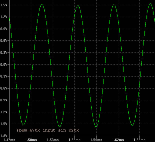

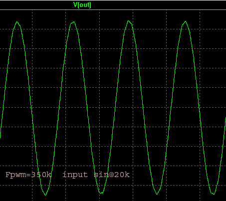

phase_accurate said:
IMO there is absolutely no advantage to go higher than 400 kHz with the switching frequency.
One advantage of a higher switching frequency is that a higher filter cutoff frequency can be used. That basically translates to the use of smaller inductors (value and physical size).
NOT JUST
i post 3 pic
1st: Fpwm=350k input sin@20k
2nd Fpwm=470k input sin@20k
3rd: Fpwm=1000k input sin@20k
you can see the diffrent
