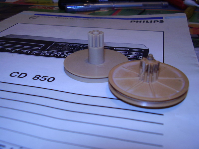

Have some problems with the in/out pulley (orange)

It 's still very difficult to find this orange pulley as separate part...Philips does'nt follow such oldies !

This pulley [ on Ebay ] is for the cdm9.
I have a cdm-4 pulley, belt and motor, all in excellent condition.
I was going to Ebay them but you can email me to negotiate price.

I've ordered a pulley for the cd-850mk2 from the hungarian philips rep.service ,but they've sent me 4 pcs of pulley for the cd-940 (850mk2 parts are no more avaible) almost the same but can't build in!
I'll do it for myself, just a little metalwork. When I'll finish it,make photos and manual how to do it and attach it to this thread
I hope it can help for all of you
