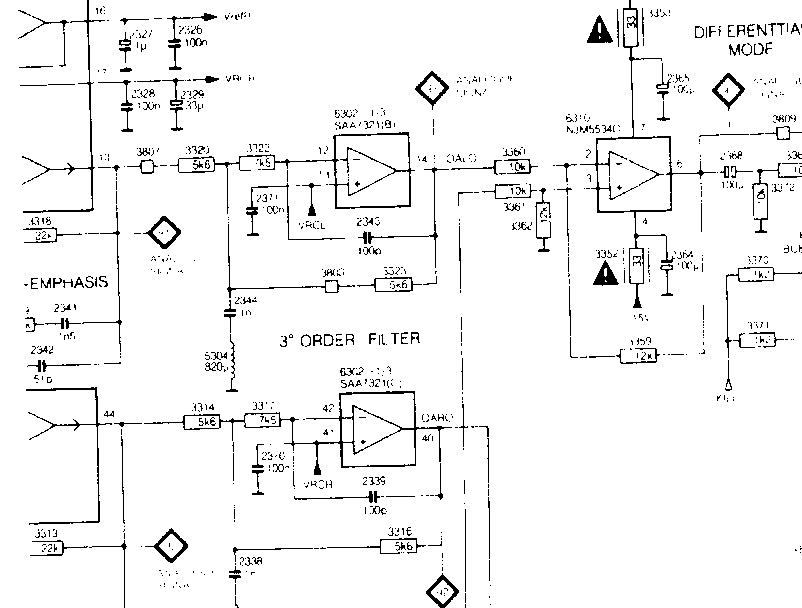

i this thread i've seen references to taking the output straight from the dac (bypass the opamps).
either to valve or other analogue stage to replace opamps.
I have alredy upgrade my cd850 with LCaudio clock and using opa227's
big difference in sound🙂

how about using this circuit instead of valves, to replace the opamps?
any suggestions anyone?

I'm on they way to work on a complete power supply mod for this player. Something with 4-5 new transformers, independant ones for each section.
Based on KWY's advice on the CD723 thread, adapted to this CDM4 machine.
Is anyone interested?

Yes, 4 or 5... I think I exagerated.
3 is more realistic, and IIRC, is what KWY adviced.
-one for the dac and I/V
-one for the servos
-one for the "critical" digital parts (decoder, filter...)
-one for the servos

have you seen the circiut diagram for the cd850?
i'll try balanced out of the dac.

I had the 850MKII.
I was going to buy the 850 then it got replaced with the mark II very quickly.
Big differences are the following:
* The old 850 had a weird problem, THD apparently rose to very high levels the lower the output signal was - a faulty filter apparently. It was in a magazine but can't remember which.
* The MKII also had a differential mode bitstream DAC instead of the normal one, IIRC.
I'm going to make all of you go crazy... I actually trashed my 850MKII a few weeks ago... I should have kept it to practice modding skills...
