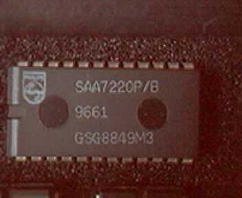

It is a good cdplayer that much resembles the Philips types of those days. As with those Philips types I would decouple SAA7220 really well with 220 uF OSCON.

Feed the SAA7220 with it's own supply or decouple it with OSCON.

If you have a low jitter clock like Guido Tent's or Elso Kwak's: Remove crystal 1302 ( 11.289 MHz ) and caps 2328 and 2329 ( 47 pF ). *Keep resistor 3366*. Connect the low jitter clock to pin 11 of IC SAA7220PB. Connect power leads of the clock supply to cap 2524. This is the mod that makes 50 % in terms of quality of all mods.
More mods are possible but these are the simple and very effective ones. I wouldn't advise you to remove the SAA7220PB so that the player will be an non os one. You'll regret that afterwards.
jean-paul said:
Another tip: connect a OSCON 100 uF 20 V direct over the supply pins of the SAA7220 dig. filter. Better is to give it its own clean supply. Add an extra well decoupled 7805 and if you're brave you can feed it with a new transformer and bridge.
This "famous" 😀 IC tends to throw a cartload of garbage on the 5V supply line.
