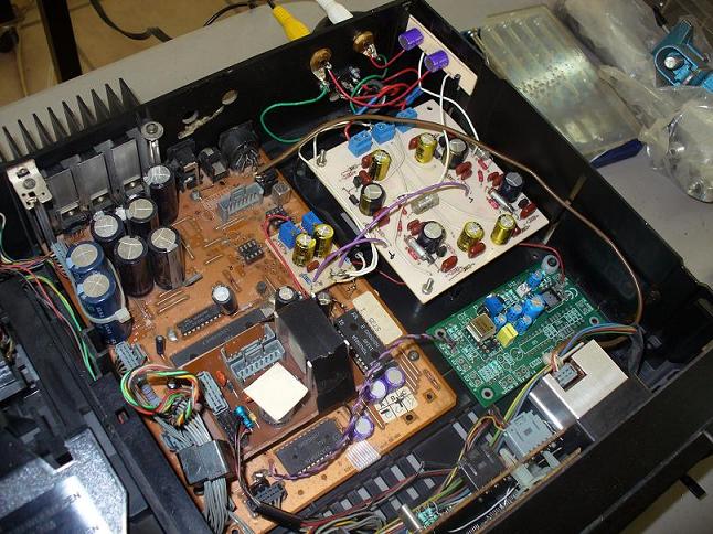

CDP description, Magnavox CDP650
Center of pic is the main board, the lower 3 caps are Sanyo Oscons 150u, one on the DF the other two on the Dac, all three are on the Digital supply and are bypassed by 1.5u Tantalum caps (>That was may idiosyncratic touch… hehehe). The bypass to the analog supply on the DAC is a 330u FC cap bypassed (underneath) by a small conformal MKP.
To the center right of the main board, just on top of the DAC and the 330u bypass it can be seen a small piggy back board containing the plus current injection to the output of the DAC.
To the lower right corner the XO clock courtesy of Guido Tent, wish all my PCB looked as good as this one, just excellent work.
Decoupling caps on the DAC are 0.1u conformal MKP’s and on the most significant bit 2.2u Sanyo Oscon’s, all on the underneath of the board.
Big Ferrite rings around cables coming from the drive to the main board, also at the input of the raw analog supply to the CDP plus the small ones at the decoupling caps on the same board and some others on supplies at the main board. Plus some caps and ferrite at AC input.
Upper right is the analog section by yours truly the now famous (?, heheheh) OPA660. Each OPA has its own shunt reg at the rail through LM431’s. The actual OPA’s can not be seen on this pic cause they are underneath.
The last touches to this board were replacing some of the important resistors with PRP’s (red ones) and replacing MKP’s LPF with styrene on a double pole arrangement, first pole 2000p and second is 1000pf, don’t know exactly were I am on roll off corner, but sounds good to me.
Raw power supply to the analog board is external with 317/337 regs.
Finaly the Oscon output caps can be seen to the upper right corner of the pic (150u / 16V)

Re: CDP description, Magnavox CDP650
Imo never use lytics for coupling 🙂
Better get some cheap Tube Light KP caps of 5.6uF or so, or motor starting caps. You will be surprised 😉
Oh before the beforementioned shunt PS with LM317/BD139 for SAA7210 and 7220 is powered, test it with a load resistor of about 30 ohms. If voltage is around 5V the try it on the chips.

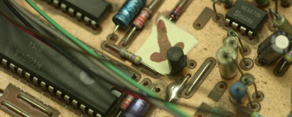

dead tray on 650
I made a picture of the main board with a blown transistor (mentioned on the board as item 6328).
The disk drive will not go out (even when aided by turning the main wheel at the left by hand); once out and once loaded with a disk, it does retract and play the disk (no disk error 🙂)
This transistor is the BC328 and connected to the M4804A Looks like it this BC328 is the fault. The collector goes to the drive connector (mid left on the board), emittor is earthed. I'll replace with a larger transistor.
But I am afraid the diskdrive will remain stuck with old grease etc.
Suggestion: better make it into a top drive?

I have tested lots of different caps at the output not the motor run type thou. MKP’s are good of course and will help to conceal some CDP noise problems; Oscons on the other hand will reveal most all. BTW, I have tested them against no cap.
