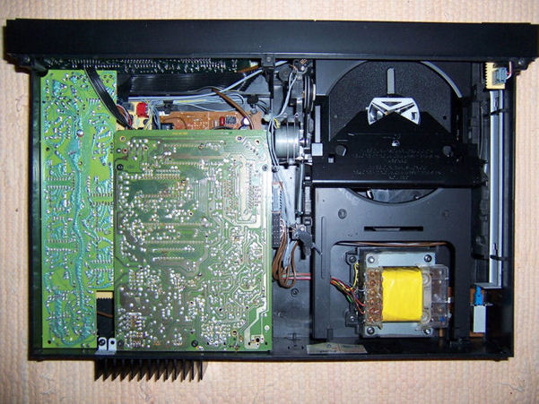

Below, I'm going to try to attach a photo of the inside of the machine. You can't see much because there are extra PCBs attached upside down over the main board. I've tried to get the biggest of these off but it seems stuck even though I've taken all the screws out. I'm afraid of damaging something by forcing it.
Anyway, I just wondered if the picture might jog any memories. Outside, it looks very much like the PCM 7000 (perhaps Audiofirst will confirm). The case is all plastic except for metal panels on the bottom, which I think are for reinforcement, and the metal lid. There's no mention of Cyrus anywhere on the machine, back or front, only Mission. Oddly, though, the serial number begins with a C, which is a characteristic of Cyrus equipment. It was manufactured in 1988.

Basically it's a Philips but the left light green board is NON-Philips.
Yes, the big main-PCB in the middle and the PCB under it...looks like Philips-CD650 and Grundig-CD8400 etc. On the left these Players haver a FTS-Board...here is the difference.

Can anyone tell from the picture whether I have the CDM2 or the 4?

There is usually a sticker on the mech showing the type but from the look of your disc clamp you have a CDM4.
I have a PCMII with a mech like the one in the photo of the 7000 shown in Post #1. You can see the different type of disc clamp and in mine this mech is a CDM2.

That's very reassuring, stoolpigeon. Listen, this is very embarrassing but I'm just a beginner and I can't even get the top PCB out to see what's inside. It seems to be stuck to the "radiator" at the back of the PCM II even after I've taken the screws out and I can't see how or why. I'm afraid of doing serious damage by just blundering blindly on so I just wondered if you could give me any tips as to how to get the top PCB off.
The voltage regulators on the pcb are attached to the heatsink (radiator) so the pcb with heatsink needs to come out as 1 piece. I can't remember exactly but I think the heatsink pokes out the back panel so you will have to jiggle the assembly toward the front and then lift it out.

OK I just checked the thread and refering to the photo in your post #23 I think you need to remove the 2 screws at the front of the pcb in line with the tray loading motor and the screw on the heatsink which is not actually on the pcb. You should then be able to jiggle the assembly and pull it out. Note there are quite a few wires attached to the board but they are long enough to allow you to get the assembly out to see whats going on.
