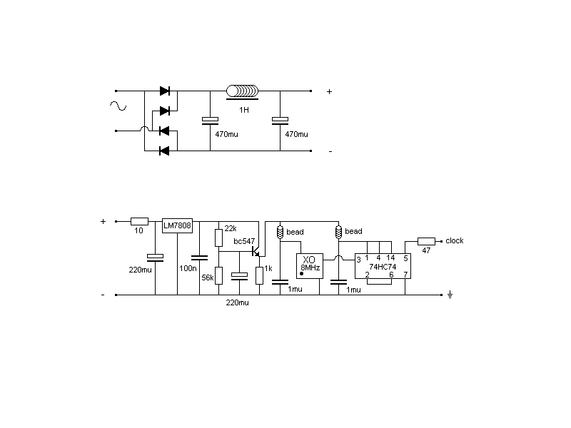

Can I use below clock layout to clock the 7000? I already have the Tent XO 8.4672MHz module. The idea is to divide the clock by two, same mod as MidiMaze. Some of the C-values are what I have lying around. Most of the layout is directly from Guido's site.
Thanks,
Jeroen

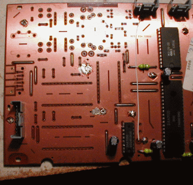

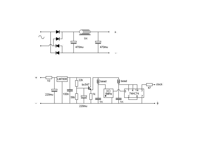

I built a clock into the player, see photo. It has a dedicated powersupply. The previously posted layout was incorrect, I had pin 3 and 5 connected the wrong way around. Over the coming week I will listen to it a bit more but first impression: mwoh... not impressed so far. It might be it needs some time or a better I/V or make it NOS.
Nice work. I also see you removed the DC blockers. You have some large (cerafine ?) caps on the 1540 supplies. what value are you using there ?
I have some small OSCONS here, but use the cerafines for the 2 opamp supplies (you have some black lyrtics here)
I started with pulling out the blocking caps. It made such a diff with my Marantz cd53. But... I do now have large plops when I change volume (stepped att.). Guess it is DC but as want to replace the opamps anyway I don't bother, did not even measure it...
The bigger caps next to the DACS are indeed cerafine. Well spotted!! The value is 220mu/35V. No science, just what I had on the shelve, the rest is cheaper Nichicon.
Yesterday I listened again and I had the feeling that things had improved after all. Voices (Christina Branco) sounded more present and music seemed to have more depth. But.... it was late, I spent a lot of time on the player, I was way past my first whiskey...
Next weekend I'm going to remove the SAA7030 or add a new I/V. Still a lot to gain I think and it's a fun machine to work with.

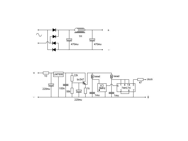

Re: 1h???
Elso Kwak said:
1H??????
(That is 1000 mH)
Uhhh..... 1 is indeed 1000m. :devilr:
Why do you ask. 😀
Serious, I have no clue. I asked for 400mH because that is what I remember Guido reply once in a post. I got this one. (you can see it in the photo in my post on 20-2 in this thread, it is the small black dot in the middle) They told me it is 1H. As I do not have direct access to a decent parts-shop where I live I just used it. Next time I open the hood of the player I will check the label. My electronics experience is limited so I do not (yet) recognize silly values.
What would suggest as a good value?
Thanks,
Jeroen
