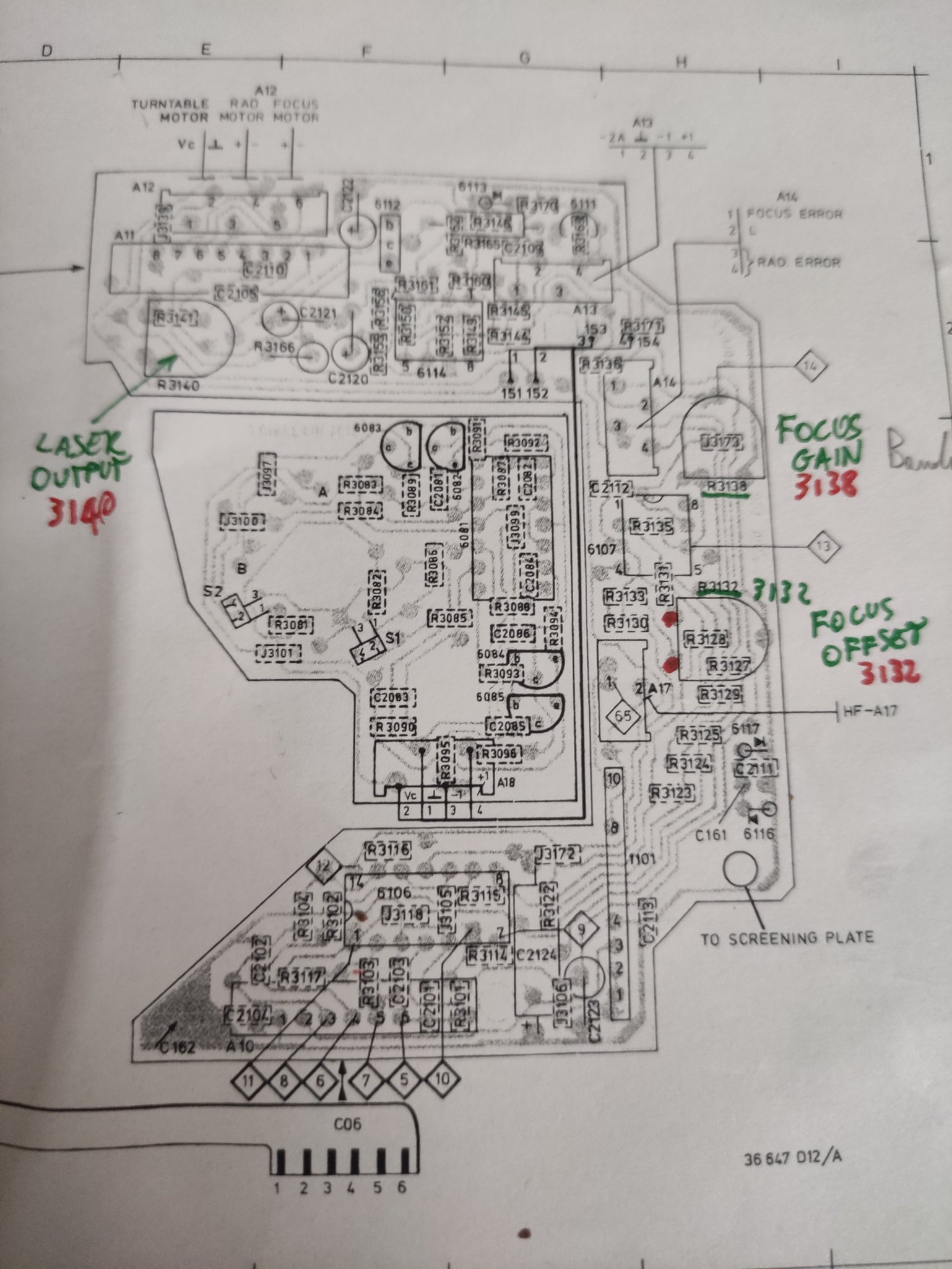

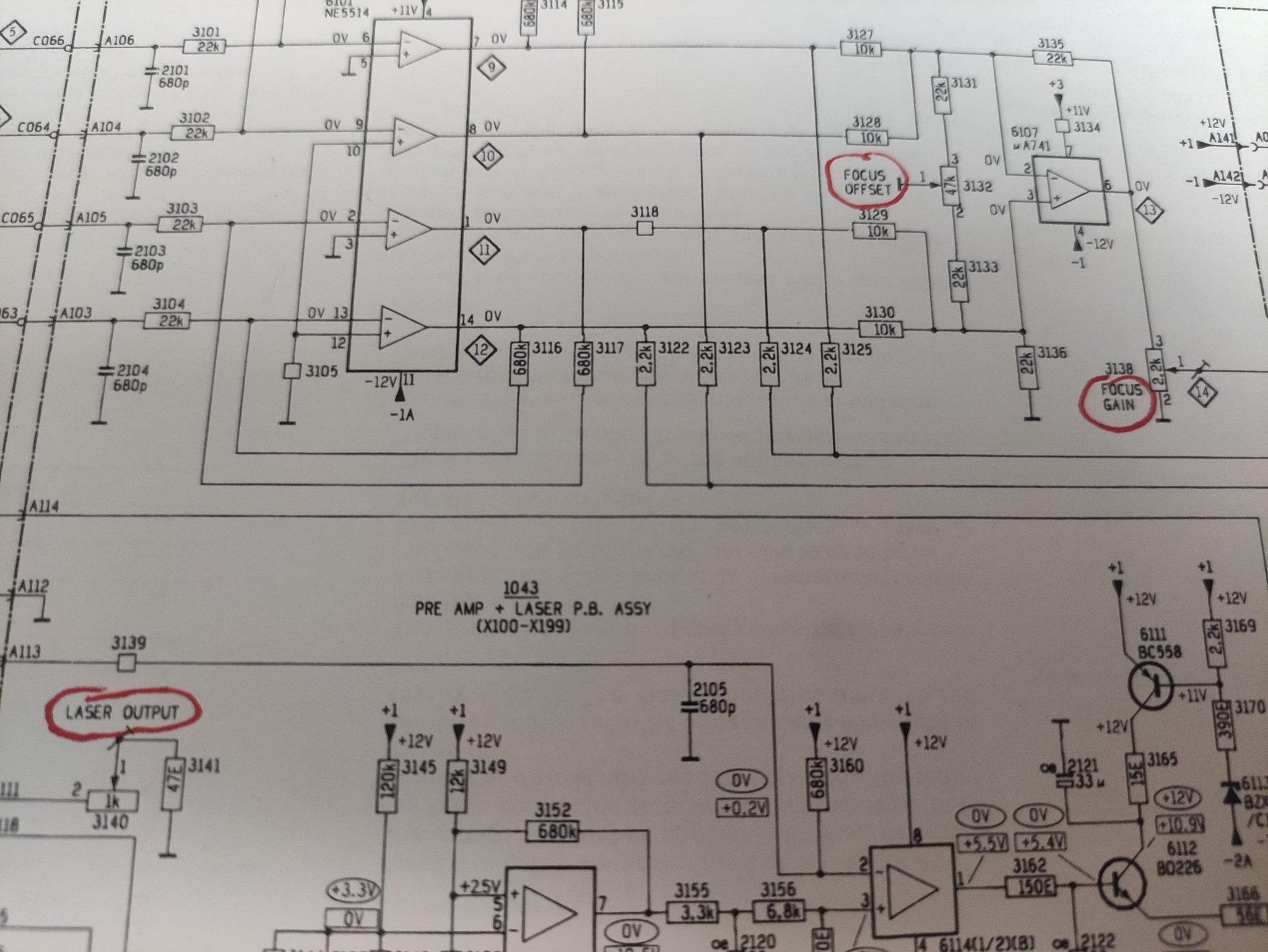

Hello friends, so far everything smooth by the resurrection of cd104 and his friend 304.
Set laser supply to 550mV with a normal pressed CD.
I like to do things spot on, so I'm wondering what for are the two other trim pots "focus gain s(hould be focus bandwidth)" and focus offset.
From what I've drawn from the schematic, focus offset should have 0V difference between pins 2 and 3 of 6107 uA741.
But focus gain?
Has it an influence on the RF Eye pattern? Or this should be set to Vpp=1.2V only through the laser output pot?
Yes, I read Mike Leach's article, but he doesn't delve in these detail.
Thank you.

I also want to know the purpose and adjustment method of Focus Offset. Since the servo is a closed loop, the voltage difference on pin 2 and 3 on the uA741 is always zero. Perhaps it should be adjusted by breaking the loop. I could not find any description anywhere.
As for the Focus Gain, it is described in the service manual of the CD player. A certain frequency is to be fed to a point, and the Lissajous pattern should be monitored on an oscilloscope, and the FG should be set to 90° phase shift. I suppose it adjusts the damping of the focus loop. It is not a super critical adjustment, the factory setting is usually OK.

How does it interact with the Torx screw that adjusts the turntable height? I think the ultimate goal is that all 4 photodiodes should get the same amount of light, and put out the same amount of current. But it can achieved by adjusting the table height or turning the FO variable resistor. Which comes first?
I always say this... Philips test procedures are often bizarre and convoluted 🙂
The Focus Offset R3132 looks to trim any electrical imbalance in the photo diode array. I can't spot any obvious reference to adjusting the preset and so I would look with a scope set accurately to show DC at the output of the 741 and see what happens between stop mode and play with a good disc.
It looks to me like you adjust the DC shift to be zero but try it with the scope. The 741 will always seem to have essentially zero volts between the two inputs (because it is configured normally with negative feedback via R3125) but the opamp output can vary depending on the preset and the offset.
Focus Gain isn't normally very critical, to low and its prone to lose focus easily and to high and the focus coil can be noisy as the system approaches instability. Again I would dangle a scope on the main focus coil driver stage and look at the output to the focus coil which should be a relatively low frequency fluctuation superimposed with a DC offset (the DC needed to move the lens to the correct position). Turn the gain up and look for any signs of obvious instability (likely showing as HF becoming superimposed on the focus output signal) and then just back the gain off a little from that point.

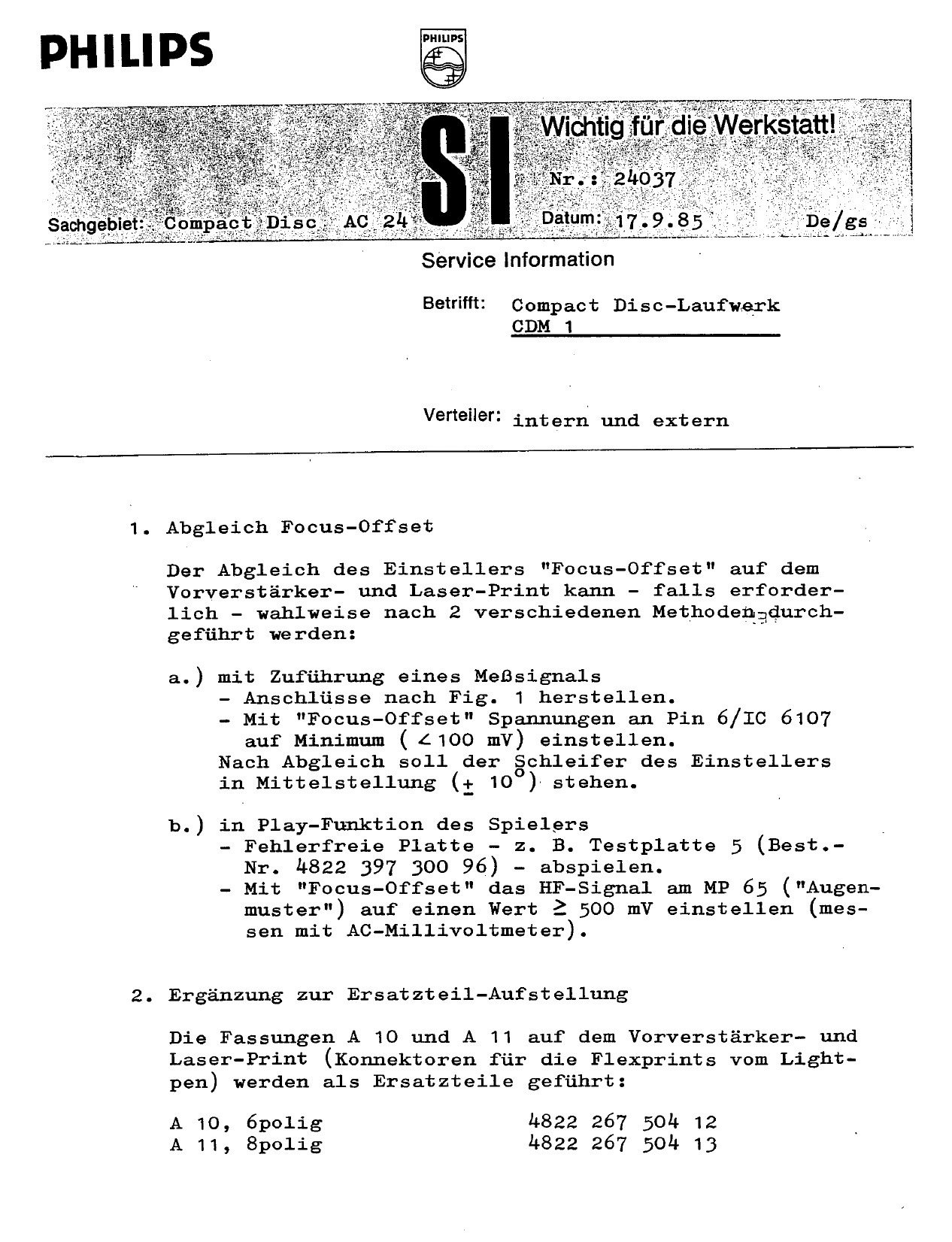

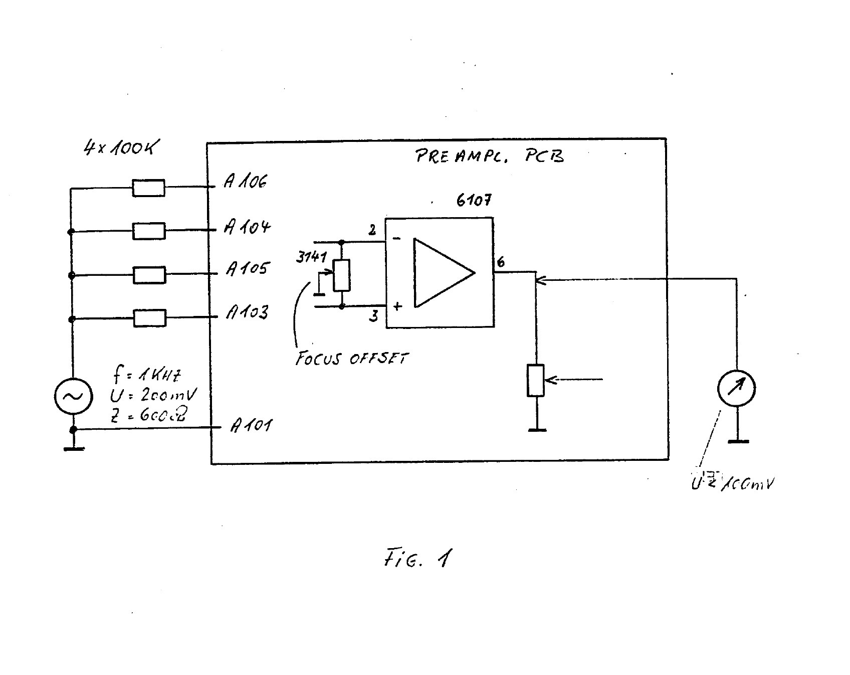

Some Service information in German about focus offset 😎
Google translate
1. Adjustment of focus offset
The adjustment of the "Focus Offset" adjuster on the preamplifier and laser print can - if necessary - be carried out using either of two different methods:
a.) with supply of a measurement signal
  • Make connections according to Fig. 1.
  • Set the voltages at pin 6/IC 6107 to minimum (< 100 mV) with “Focus Offset”.
After adjustment, the slider of the adjuster should be in the middle position (+ 10°).
b.) in the player's play function
  • Error-free plate - e.g. B. Test plate 5 (Order-
  • With "Focus-offset" The HF signal on MP 65 ("eyepattern") to a value > 500 mV (measure with AC millivoltmeter).
2. Addition to the spare parts list
The sockets A 10 and A 11 on the preamplifier and laser print (connectors for the flexprints from the light pen) are listed as spare parts:
A 10 - 6 pin 4822 267 504 12
A 11 - 8-pin 4822 267 504 13

Yes, notice they didn't mention the mechanical offset adjust. Their huge assumption is that this has not been disturbed, or wear has not occurred (or suspension has sagged).
In service, you never make assumptions unless you have good evidence they will be true. That and you never, ever perform adjustments of any kind if you do not have the training, tools and equipment to do so.

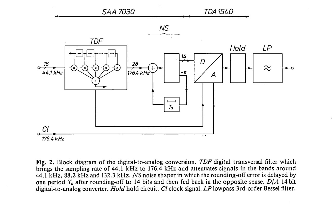

They did the best they could with 14 bit at the time. My Nakamichi OMS-7 is the same.
Honestly, 16 bit is better - no contest. Oversampling is a huge gain in quality. One reason is that you don't need such a high order filter. People who do not institute the filter are totally irresponsible and have zero understanding of how this stuff works.
With a lower order filter, a lot more of the sampling frequency escapes out into your system. You can't hear 44.1 KHz, but it can interfere with the electronics, create distortion as your active circuits have less feedback higher in frequency. WOrst case - out to your speakers it goes and straight to your tweeters where they attempt to reproduce that signal you can't hear.
We do the same with FM stereo tuners. We have to quickly filter out the 9% modulated 19 KHz pilot tone. Otherwise it does the same thing. With CD, the NO filter is set to about 22 KHz (guess why?). With digital the sampling frequency is full bore folks.
DSP and filters that oversample and interpolate to 92+ KHz and 20 + bits do perform better, and they sound better given the audio and filtering is done properly. I've serviced CD players and DACS since the beginning and there are very good reasons why they increased bit depth and sampling frequencies. The NOS crowd hasn't a clue, and are dangerously misinformed.
