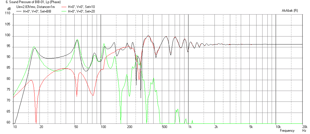

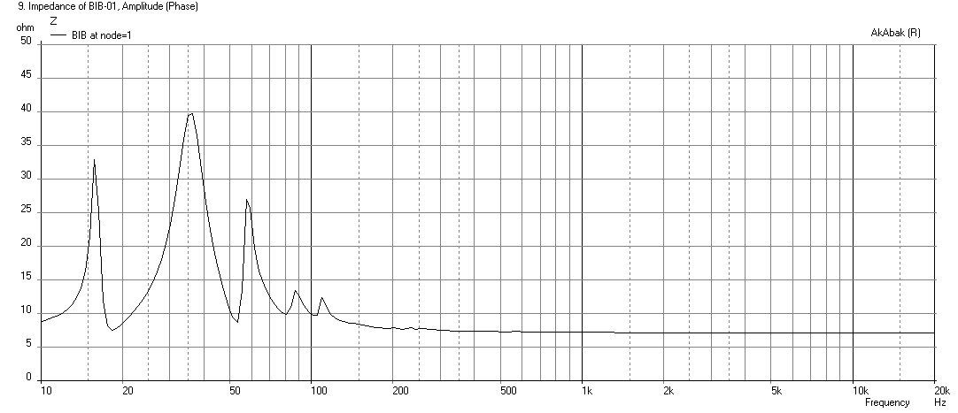

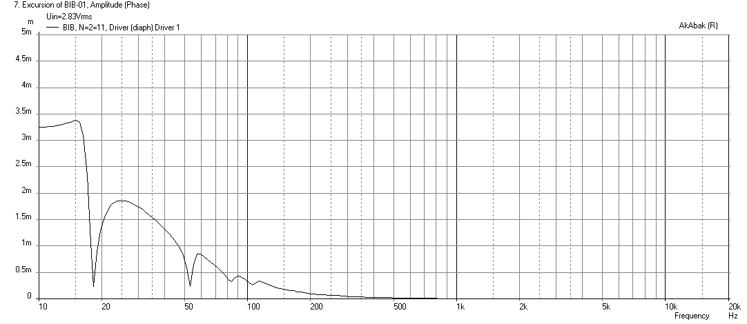

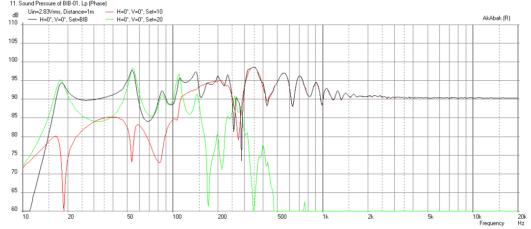

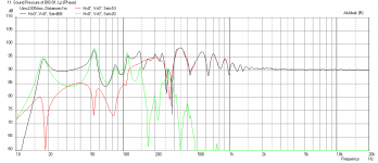

Sim of AD12100 in BIB
This is a huge speaker: 93.5in tall x 26in wide x 37in deep. Here is the predicted response with the BIB shoved up against a wall (assuming you have tall ceilings). There is no stuffing in these sims so the mids and HF's are higher in predictions than reality.
Freq response at 2.83v and 1m - goes very deep as you would expect from such a large horn but has a rather wide and deep notch around 70Hz. It looks like it still needs a baffle step correction (BSC) circuit:
Cone excursion in mm:
Impedance:
If you add a 7ohm and 1.5mH BSC circuite you get this:

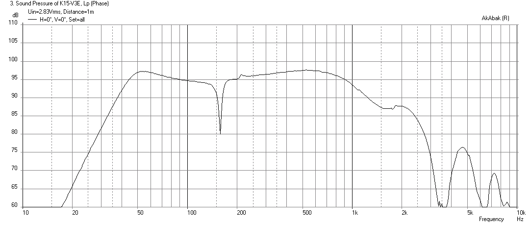

I think it practice it will look ~"flat" - I ran Beta15cx in K15 - had to tighten the rear lowpass gap to make it sound right on DAFO's drum beats and drop of "The Beast" - Imageshack lost my graph comparing behavior to a JBL M151
here's Beta15's TS - it was fairly enjoyable in K15 with a 40sq.in. vent

.......but how would these Philips drivers go in a BIB?
Just fine, though due to its low Fs and not a 'sub' woofer, I recommend using a higher Fs to calculate the BIB, so that it will place the driver a bit lower and shift the horn's bandwidth [BW] high enough to cover up to at least 80 Hz.
Really, unless one has a high ceiling, the 'stock' 48.78 Hz BIB tuning will work fine for most drivers. Here's a ~typical sim: http://www.diyaudio.com/forums/full...e-fostex-craft-handbooks-126.html#post3082457
The sims look really bad, but once mildly damped and up against a wall and especially if corner loaded, it's really a pretty impressive performer.
GM
here's ~ground plane of K15 loaded with the old Beta15 coaxial - you can interpret how much peaking is occurring - there was no ramp-up in the 200Hz region as seen with lower qts speakers - I would think the Phillips to be suitable

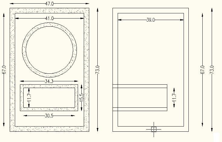

+1 stuffing is needed and once properly adjusted, BIB's sound very good. I have built several much smaller ones and have always had good success. The size on this one may need another fold to make manageable though.
Don't know what the Monitor 12's vent length is, but FWIW, the vent for this cab [which has a net Vb > the recommended 80 L] needs to be longer than the cab is deep to tune it down to 44 Hz where its advertising implies it is, so I recommend it be terminated 6.53 cm from the rear wall to work properly, though will tune it closer to 50 Hz.
That said, the driver's available power handling capability is nowhere near enough to justify such a large vent to keep vent mach low, so FWIW, a 4" [10.16 cm] diameter pipe x 2" [5.08 cm] long will tune it to ~44 Hz as well as giving you the option of tuning it lower with a longer vent to reduce any obvious reflex 'ringing' if desired.
