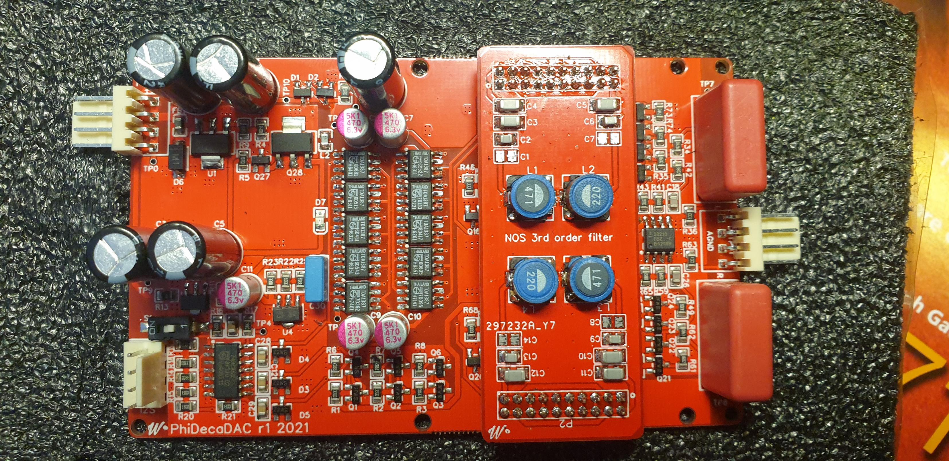

Thanks to Richard I am now in the Phidecadac club! I ordered a built board but now realise that the majority of the smd are presoldered in the fab house so maybe I could have managed the rest of the components!
Looking forward to hooking it up. I have a cheap DIR9001 board, an AK4118 board and also I have one of Miros design pcbs to populate which is a WM8804. A few options there. Generally I use optical spdif input from a chromecast audio. I'm not really a USB man but in my main dac for now the source is Rpi and Ians Fifo.
Will be comparing this to Ians dual ess dac and also my Miro AD1862. I have high hopes from what I've read on here and also I think I do like a good implementation of these early chips.
I have a spare single Salas Ubib and also recently built up a denoiser LM317 psu so I have a couple options.

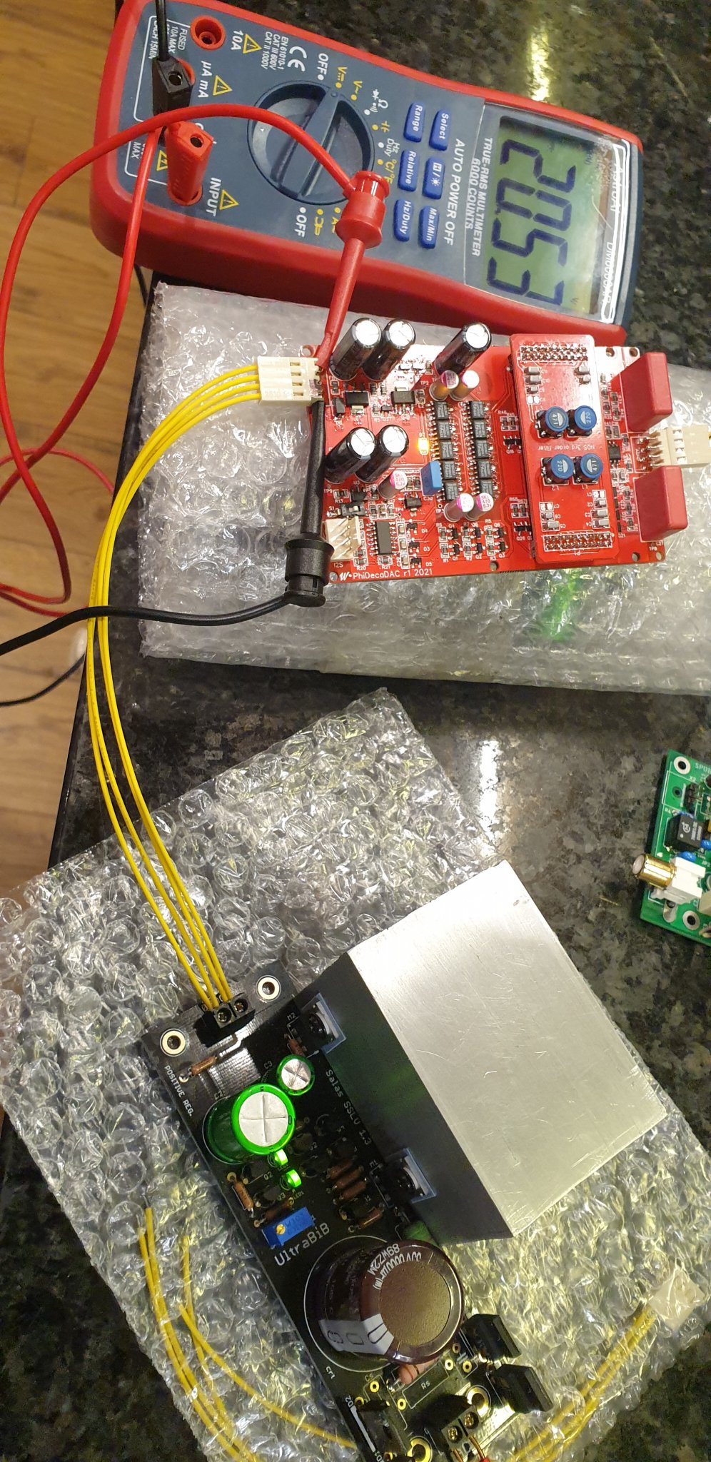

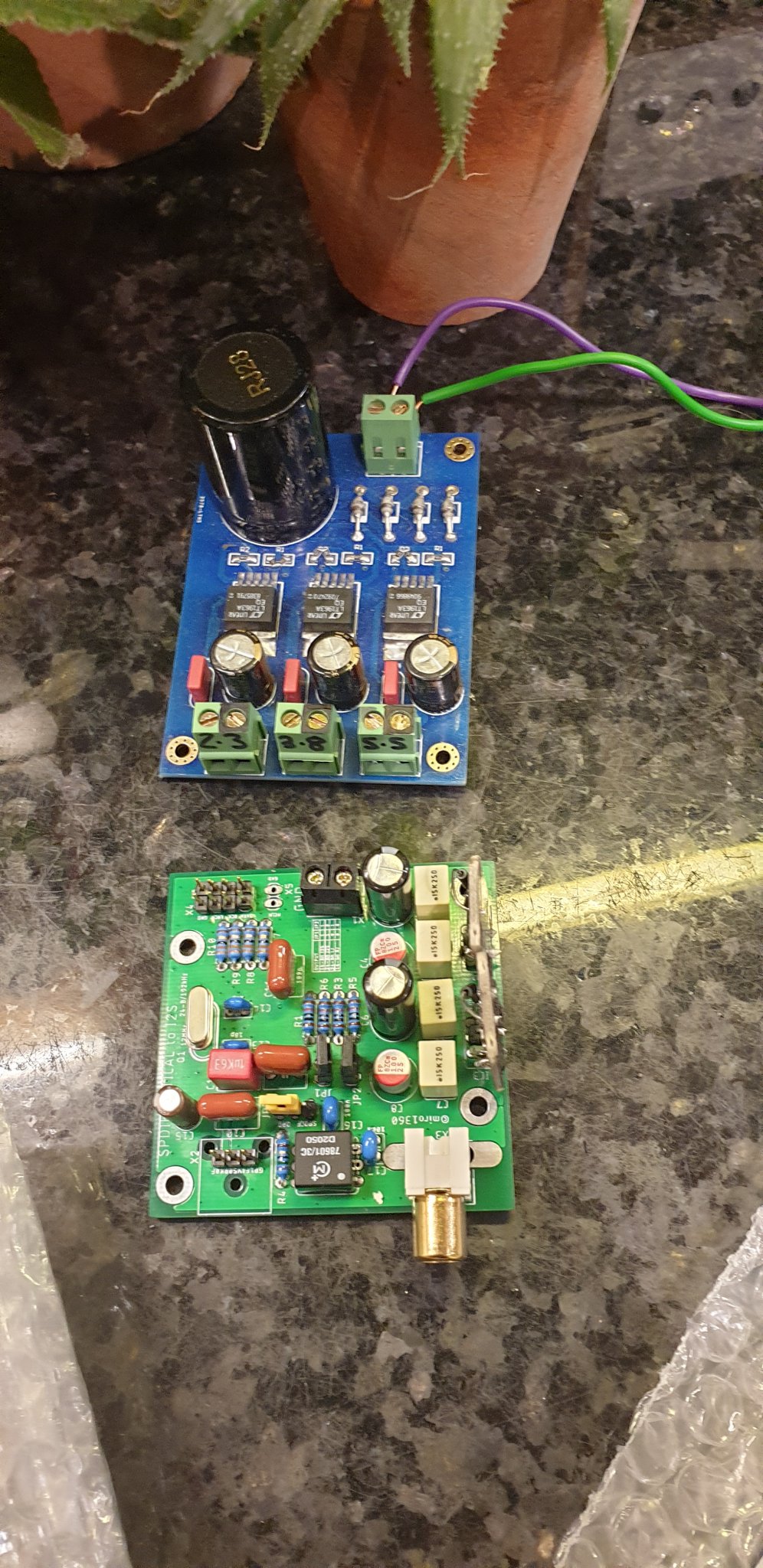

So I'm getting a rig going hopefully this weekend. Test voltages all good. Using Salas Ubib for the 20v, set just over. Will check for any drift this evening.
Using an 18v tap for Ubib. 9v tap for the Chinese LT1963 that I shall use to pre reg the digital receiver. So 5v5 into that. Then 2 LT3o42 Chinese purple regs st 3v3 for the 2 rails in the receiver. Basically WM8804 and the receiver and crystal . I used some ferrites to isolate the 2. Dont really know or understand what I'm doing!
Hopefully a listening test this weekend. Happy new year all!
