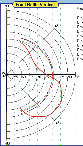

Are the two lighter lines on the phase plots the individual driver phases? I am reading this as your modification having the drivers something like 110° out of phase at the crossover point. No?
Your second example has some typical 1st order issues. It has over 2 Octaves of overlap and 90 degree phase shift between the sections. The response is quite good at the measured (simulated?) axis but any up or down movement will strongly degrade the response over a wide frequency range. Both peaks and response holes will come into effect at any position higher or lower than the measurement position.
Overall response at that point is nice, in fact better than the first example. If you situate your speakers exactly and never move then it may be a much better speaker for you than the first. Otherwise....
Yes, you are right. The artifact below 200Hz is due to the incorrect graphics simulation of the woofer.
110 out of phase is correct, but it is slightly worse of 90 but works perfectly.
Yes, you are right. But IMHO 2 octaves of overlap is the mild blend of the two drivers. Yes the respose is simulated but with measured data.
And yes, finally, if you move in the vertical axis the notch come in. But the ears says nothing. 🙂

Fair enough, but the vertical polar response around 3-6kHz must look something like this red line I've crudely sketched. If you brought the woofer forward a bit and re-did the crossover, maybe you could get much closer to ideal 1st order behavior, or maybe even redesigning with a tilt would be enough... you need what, 2.5-3cm shift or so I think.
Hi!
Yes, you are correct. The vertical polar is so, but while the mic says "bad", the ears at 3 meters don't notice. 🙂
