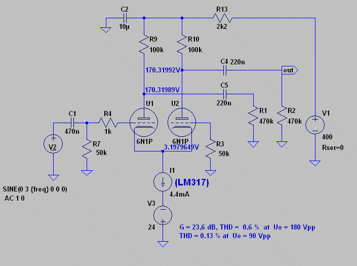

phase splitter with low distortion
That is a good value. However, if 35 Vpp is what is needed in actual amplifier, then I would check that the phase splitter is capable of supplying at least 70 Vpp without excessive THD rise.
I have used basically similar circuit, but with 6N1P-EV and 6DJ8 and LM317 as the CCS, since it is very simple and only a few components are needed.
Phase Splitter
Your circuit was interesting, so I ran a simulation in LTSpice, and I did not get the same values as you. To get the same current in the tubes I had to adjust the resistors in the ccs. My values for distortion, and Vout is different from yours, see attached pdf file. I got 30 p-p out for 1 v p-p in. And about -49db THD, which gives about 0.35%. If you look at the fft from the simulation, 3d harmonic distortion is the largest, at 30 v p-p out.

The simulation result depens a lot on the used tube model.
But below is one I have used and the actual performance is very close to simulated one.

Yes fine, but only way to extract full performance is to feed into Williamson diff drivers or straight into a low Pout class A op/stage; Morgan Jones did the working out for the Mullard 5-20 and found the long tailed quite heavily loaded esp when the op/stage grid leak resistor values is reduced, then it starts to produce more thd and also by Miller effect. Fussy with distortion ? Look at the big picture with the whole design; wrap it up with copious amounts of global NFB. That's exactly what many early designs did.

The grid resistors will be smaller depending of tubes selected unless a williamson type driver tube is used.
With 6550 or kt120 it should be 50k.
The 6550 is a nasty tube for that...Those with simulation programs should load the long tail o/p's with those 50K grid leak values plus 120pF in shunt (Miller effect) and see the results with rising frequency.
This is an example where the op tube actually governs the driver !!
