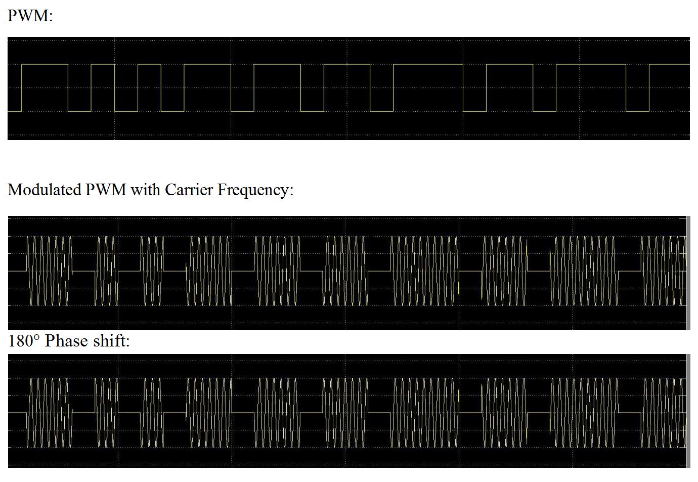

Then, how could I drive transistors in push-pull configuration with PWM signal? The duty cycle of the pulse in the PWM signal keeps on changing.
Do I need to modulate the signal first with sinusoidal carrier frequency, and only then the phase shift will work like an inverter. Is it the right method to drive class D amplifier or not? I can use the modulated signal and its inversion as shown below to drive both transistors in push-pull?
In a half bridge, both transistors must never be ON at the same time, but it is desirable to have dead time as low as possible. So, the goal is to have almost always exactly one of the 2 FETs ON. This can be accomplished by generating a PWM signal for upper FET, then logically inverting this signal and feeding it to lower FET.

-> Since no one corrected my posting above, I ll do it myself: The truth is:
1.
Inverted non-sinusodioal periodic waveform generated by an (ideal) opamp inverter: ALL frequencies (fundamental as well as harmonics) are 180° out of phase in relation to the non-inverted signal. Wave looks mirrored upside down. OK.
2.
time shifted non-sinusodial periodic waveform (shifted by a half period): ONLY the fundamental AS WELL AS THE UNEVEN / ODD HARMONICS are 180° out of phase in relation to the non-shifted signal, the EVEN harmonics will see zero (360° or 360° * 2 or 360° * 3...) phase shift .
