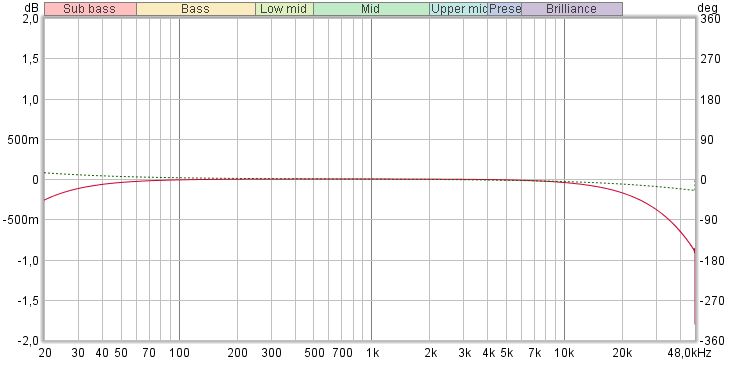

That looks great. The frequency response is flat down to 20Hz and less than 0.25dB dip into 20kHz. Notice the flat phase response from 20Hz to 48kHz characteristic of good Class AB designs.
Hi maty,
For info into linked article is written Onkyo states amp bandwidth is 5Hz-100kHz, below is 1st order textbook minimum phase of that response and means phase is aprox -11º at 20kHz point.
For me that Onkyo measurement looks not by the book or a misbehaved amplitude/phase relation even it makes you happy see zero degree at 20kHz point, speculate if its the true relation in there could be a chance the measurement chain is not 100% precise adjusted/calibrated so it drift a bit in phase, and think it could look so if you notice the the phase climb north at the very end and fade out north of zero degree but if its a 96kHz sweep then think the last fade out dot should had been down at zero degree point.

Maty - you do realize after this measurement was taken, it was agreed that the phase shift was affected by the AES17 filter, and later removed and remeasured, and the phase shift was more like 18 deg at 20khz (IIRC) , yeah?
It was the first time he measured the phase of a product with his AP. I guess what you said happened, I do not remember.
First: 18 degree.
After: 41 degree
18 degree maybe was acceptable, very low audible -> only bold. But 41 degree is too much, unaceptable to me, be it class A, AB, G or D.

Maty Tinman. Look at the dates on those graphs I posted.
First, with AES filter. 41 degrees
Second, without, as you would to speakers, 18 degrees.
The first measurement was only 18º. The second, 41º.
