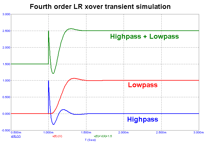

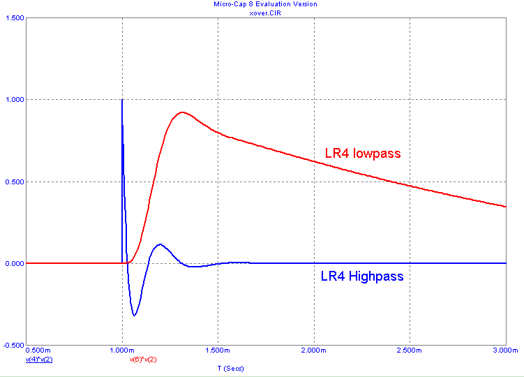

I brought up this phase distortion thing because the pulse response graph explained how signal is affected when we invert tweeter polarity in the case of LR2 xover (acoustic LR2).
This is how the original filter config is designed. And most of us have been using this kind of All-Pass-Config xover for so far so long.
Below is spice sim for the electrical reponse of perfect LR4 xover. No driver alignment, driver acoustic, or amplifier overshoot is involved. Dave is right, amplifier feedback has nothing to do with this phase distortion.

In post 33 soongsc has four graphs from the Linkwitzlab website.
Where is the phase distortion. Is it a polarity issue?
Seems like the output pulses would be shifted to the right if they were phase distorted.
Is the distortion in these graphs due solely to the RC constants in these active filters? Or is some of it due to slewing of the opamp?
The first three are probably the result of the time constants of the filter network.
The fourth one looks like amplifier instability. This graph is only on the Linkwitzlab site. Is there a pulse to the right (in graph 4 on the Linkwitzlab site) that has already occurred, but isn't shown on the graph?
This is a crash course in filter theory. I had no idea that the waveform would be changed this much. Yes, this is a square wave pulse, the worst of them all.
I'm hoping someone will show a filter that doesn't do this. Surely it takes a toll on fidelity.
