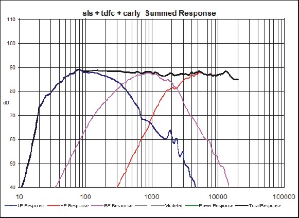

Salas, yes you are correct in your post that I am seeking for understand what the zig zags represent and what to watch for.....And absolutely, this has turned into a nice discussion, however, much of it is Greek to me, but I am willing to learn to understand........What I am attempting to accomplish with the FRD spreadsheet with my simulations along with a lot of listening, are tweaks to finetune my sound.....Having an understanding of what many of the Frequency Response Charts represent, I am able to continue to fine tune as I relate what the speakers actually sound like to my Response charts.......But in the matter of Phase......I am clueless, and have no understanding on how to interpret the phase charts that are generated with each simulation I produce........The thing that concerns me is that I feel that I may be missing some important aspects of my crossover design, because I don't know how to interpret the Phase charts, thereby giving me no more information to work with.....Tom Danley.....Can you clarify what you mean by summed mag and phase as a 3 row text file?...And what you mean by unwrapping it and taking a guess......I can save most of these files as FRD and ZMA files, and I would be delighted to give you a shot, However I would also like to learn how to interpret my phase charts as well.........Thank you all for the input you have provided so far, and I look forward to learning more...............Omni
Omni, think about this explanation for a bit.

omni said:however, much of it is Greek to me, but I am willing to learn to understand........
Bingo! I am Greek and I can help out!
frequency is only half of the picture, phase is the other half. It describes "when" the frequency occurs in time.
As many have said, your original charts are muddied by the excess delay that shows up as this exponentially increasing phase shift with frequency (1ms delay is significantly more and more of a cycle as F increases)
Most people plot phase on a -pi to +pi scale with 0 phase shift in the center (a full cycle traverses 2*pi phase). When the phase falls below -pi, it suddenly re-appears at the top at +pi because -180 degrees is the same as +180 degrees. This is called "phase wrap"
When the delay is removed from your plot, then you will have a phase response which can be interpreted. But not before.

Omni,
To understand what is good phase response is, read the paper I linked to by John Kreskovsky.
Second, interpreting your graphs is harder with all the extra delay in there but not impossible. What makes it tough to say if they are good bad or otherwise is there isn't enough information in your posts or pictures to know what the phase should be.
To interpret phase in a frequency and response plot, you first need to know what the phase should look like if your design is correct. To do this we need to know the intended crossover point(s), and the acoustic slopes you are trying to accomplish.
For example, a two way 4th order Linkwitz Riley at 2500 Hz. This is called your target. For the drivers coupled with their XOs to sum properly the frequency response must match the target freq. response slopes, which I think you understand. But in addition to this, for the drivers to sum properly the phase response has to match the target phase as well. In the case of a 4th order LR XO, this means the drivers must be in phase (have the same phase) over as wide a range on either side of the XO point as possible.
In the case of a 4th order Linkwitz Riley, "perfect phase" would mean that at any frequency on the graph , the tweeter phase and woofer phase would be exactly the same on the phase plot. i.e the graph for the tweeter phase plot line would be exactly the same as the woofer.
Please note that this relationship between the woofer and tweeter phase depends on the target slopes (linkwitz 2nd order, Butterworth 1st order, Bessel etc) So this is why I said that it is hard to interpret your graphs because you don't really give us enough information to know how they should look.
That said, your high pass and bandpass phase seem to be in phase at about 3000 Hz but that is about it. So if your target XO says both drivers should be in phase, they don't match well except at that point.

omni said:Salas......Thank you very much.......So as for your help.....Can you tell me what the zig zags indicate and what I should be looking for?......Any help in interpreting these phase charts?....Omni
Iain and Dennis beat me into answering. Very thoughtful answers.
Dennis.......Thank you very much for you WELL thought out post and explanation...And Tom Danley.....I appreciate the time you have put towards my effort.......It is very late tonite, but I wanted to acknowledge your efforts......Sunday I will fill you guys in on my crossover intended slopes with a summed response chart and the particulars, so please keep an eye out.......Salas, your latest humble reply is greatly appreciated, however I have a feeling you have the knowledge to weigh in on this as well, so until tommorrow........live joyously..........Omni....By the way... I downloaded and printed the suggested paper by John K and am in the process of studying it...................
Gentlemen.......Attached is my latest summed response chart, which may require a little tweaking.....I am shooting for a tapered response across the chart, with a slight BBC dip.......Target alignment rolloffs I am shooting are Bessel........12dB/octave.......Target crossover frequencies are 350 Hz on the low end.....and 2500 Hz in the upper end.......Polarity for both midrange and tweeter is reversed.............Omni
Hi Omni, my dear friend
Its been a long time , mate!
I am trying to be helpful, but your last graph looks much the same as 2 years ago? Kindly consider PLEASE, the logarithmic Y-axis which needs to be refined or 'homed-in-on' for proper evaluation.
Changing your vertical is, imho crucial to 'Frankie' sounding better!
Its logarithmic...its NOT a linear Y-axis. 40dB might sound like a mouse in slippers on carpet, BUT 110dB, which is your top scale, WILL sound like your ears being blown out next to a Boeing A340 on takeoff! This will make your graph look vastly different if squashed to normal listening levels of say, 70 to 90dB maybe. But, I think even 90dB is very loud? Like the headphone cones blowing?
It will then have Mt Everest size peaks! What I'm politely trying to say is that IF you stay with a 40 to 110dB volume axis on your graph, then my friend, you will NEVER EVER get a good sound.
<other folk please reply?>
Please sort out the response curve first, THEN tackle the phase issue. One thing at a time. Sort out the most important thing first.

If you're talking about the phase of a given completed system, then my answer is that it doesn't matter much. It is possible to screw up phase in such a way that it will be audible, but for anything reasonable you might do, the phase response of the end system isn't much of a concern.
I´ve been struggling with flat phase response related to transient perfect.
My crossover is active linear phase which has alingment delay so phase response can be as flat as speaker/driver can give.
But my system has horns and driving horn near lower frequency limit there seems to be big phase hump.
with horns less the delay to more "transient perfect" impulse response makes phase hump more and vice versa.
with sealed enclosures it was easier to achieve "transient perfectness" with flattish phase response
as what comes to sound, sealeds are like trousers and horns more the stayup stockings
