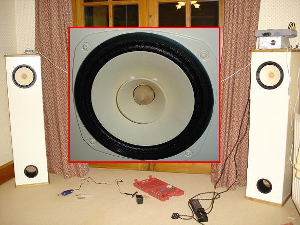

Wellllllllll, what can I say...Dave you're a god send.
That irritating 'peakiness'....that shout......that impossible to get rid of 'hash'.....GONE
At last😀
I am a happy man😀
Ignore the wires and stuff everywhere I have been doing a little tinkering and I'm close to divorce…. But hey I have my music!
Thanks again Dave, Old buddy, Old pal!

Yup, those'll be a sonofagun if you want to remove them but they sure look nice. Glad to "hear" you like them.
Cal Weldon said:Yup, those'll be a sonofagun if you want to remove them but they sure look nice. Glad to "hear" you like them.
Hi Cal, whats your Avatar changed to? Are you now a solitary shining Star?
It's funny but as you cut the central section out you create the very same sound you were trying to get rid of....kinda reasuring!
I'm using the sockets a la Decware
Took out the dust cap on the Fostex 166Es in my Abbys and put in 1/2' drive sockets. big improvement in treble smoothness; as far as not removing glare in certain Cds/LPs.... there are lots of bad recordings out there, particularly CDs from the dawn of the digital era.
