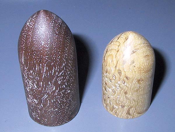

John was kind enuff to vollenteer to be a B200 phase plug guinea pig...
Hey Dave,
A couple questions if you don't mind.
Are those your standard 7/8" by 1 1/2" (22mm x 38mm) phase plugs?
In the picture it looks like there is only a thin layer of adhesive left where the dust cap attached. Was there cutting involved or was the dust cap somehow able to be pulled from the cone?
And, when removing the dust cap, any risk to the voice coil leads under the cap?
thanks,
Scott
scottw said:Are those your standard 7/8" by 1 1/2" (22mm x 38mm) phase plugs?
No they are quite a bit bigger (longer in particular -- i have a pic in my camera i can't get at ATM). They are also CNCed instead of hand turned (costs more, but means Scott doesn't have to build a custom tool for one-offs)
The dust cap came off easy enuff. Cleanig the adhesive off around the edges was a real chore.
No. Of course you still have to be really careful.

Hey Dave,
I like what I see, nice work! Take your time - no panic... I still haven't committed myself to a baffle or design that has to include the Hawthorne Audio Augie for bass duty. Please be sure to post some notes for the benefit of all B200 owners. I'm sure you'll be receiving more inquiry on your B200 modifications soon.
John.

Dave,
Been messing with the phase plug thing for my Kenwood KFC-6469s, off and on, since we last spoke about it (some months back). I've come to the conclusion that its not going to happen simply or easily or cheaply by modding something pre-existing, so I'm looking for measuring guidelines for having some made custom.
First off, I think I need 15/16" diameter, so none of your 3 standard sizes are going to be drop in solutions. Second, how do we determine how tall they need to be and at what point they need to transition from cylinder to bullet?

Kensai said:so I'm looking for measuring guidelines for having some made custom.
1" VC diameter?
The production Visaton B200s may just fit (1st listen today -- nothing unexpected -- ie improvements in all expected areas... perhaps not as dramatic as on some of the Fostex, but still worthwhile IMHO)
The plug wants to reach to near the height of the surround. The shoulder wants to be just a bit above the height of the voice coil top above the pole-piece.
dave
