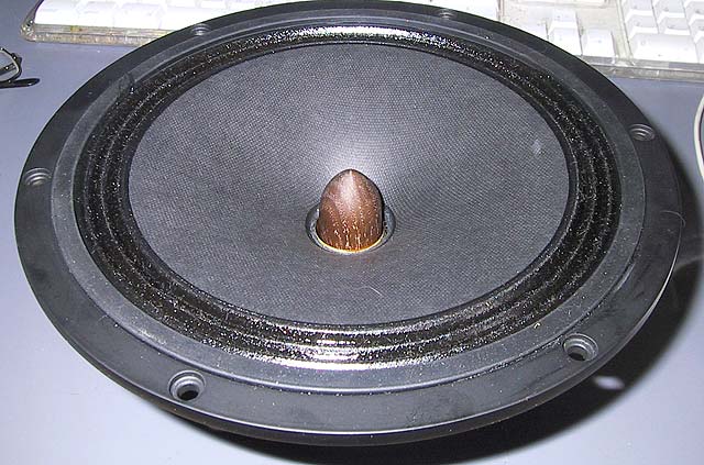

John was kind enuff to vollenteer to be a B200 phase plug guinea pig... this week i'm hauling the OBs over from storage at my parents (have to make room for them ) and start doing some listening evals.
Thanx John for your patience -- things can be slow going here.

I've not personally tried the sockets... one of my customers has.
Wow Dave!
These phase plugs are a significant improvement over the Steve Deckert
socket wrench mod. Much more even tempered from top to bottom. Whatever
seemed 'wrong' with the original 207 driver has been eliminated, and are
more involving even when you aren't sitting in the sweet spot. Maybe the
mids are more detailed, who knows, but they are certainly worth the purchase
price even if it seems like a lot of $$ when you first look at them.
Thanks again,
Bob
dave
My first mod to the FE206E was Planet 10 phase plugs. After reading about the socket mod, I had to try it because it was cheap and seemed logical. With the sockets there was a change, but not really an improvement in smoothness and dispersion as there was with the wooden plugs. To me, the Planet 10 plugs reduced the beaming more and FWIW look cool in the driver. The plugs I was sent were clear finished wood and I planned on painting them black. After living with them a few months, I won`t change the color, they look good and perform as advertised. I have no association with Planet 10, other than being a fan of their products....they`re worth the money and the thrill ( made me nervous, but turned out to be easy), of installing them. Put the sockets back in your tool box where they belong.
