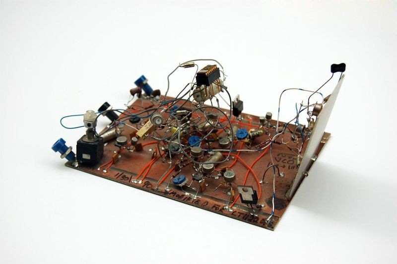

The Vref regulator isn't all that messy. Its reasonably compact and uses carefully laid out hand wiring.
Not like some of the early dead-bug stuff I did with ES9038Q2M. That said, dead-bug over ground plane is a useful technique for some prototyping.

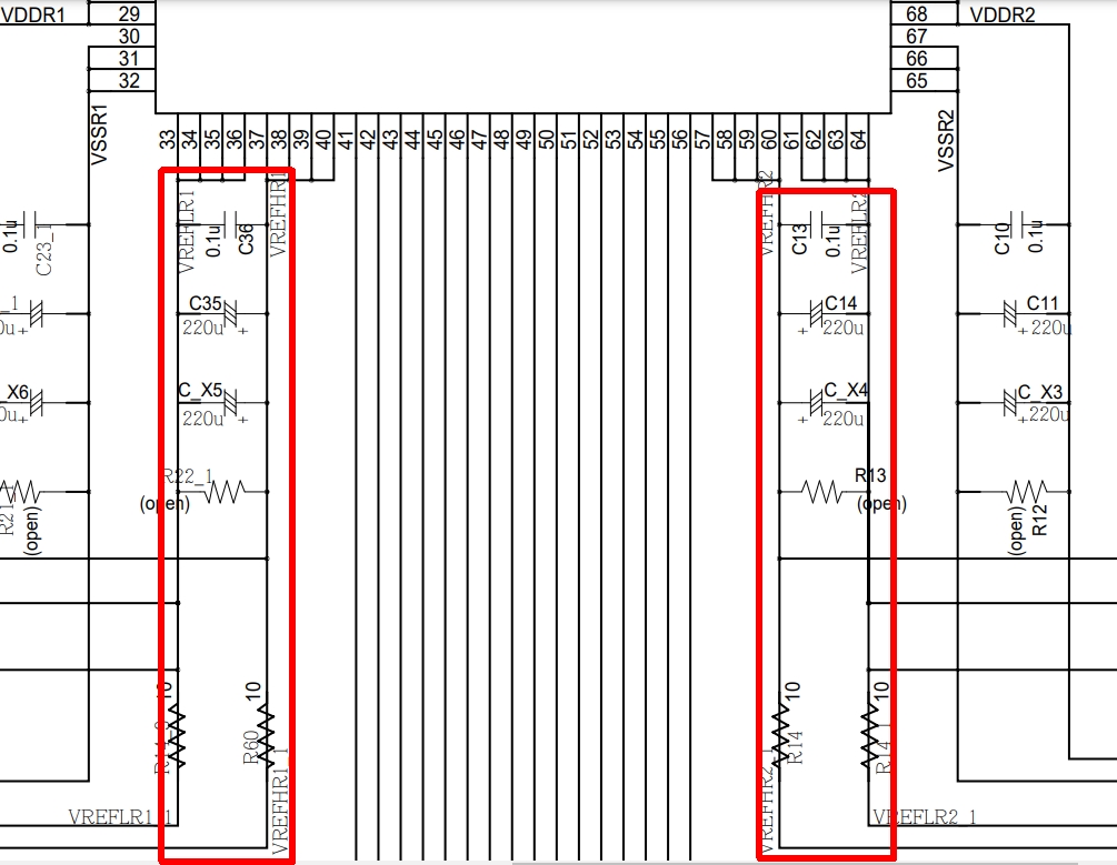

I was asked a question regarding regulator distance from the dac, given an AK4499 eval board is involved. If you don't like not being able to get much closer why don't you complain to AKM not me?
I don't mean DC current. I mean does current vary with signal? How does it vary? Is it 22mA average with an AC component proportional to signal? Or a harmonic of signal, like ESS when not used with a differential IV? What are the HF components?In my case it draws 22mA per channel.
Haven't measured it. Most likely is rather similar to ESS. Its a switched resistor dac that needs opamp IV.
Here's what AK4499 datasheet has to say about it:
"Connect a 0.1μF ceramic capacitor and 2200 μF electrolytic capacitor between the VREFHL1/R1/L2/R2
pin and the VREFL L1/R1/L2/R2 pin.
The VREFHL1/R1/L2/R2 and VREFL L1/R1/L2/R2 pins should avoid noises from other power supplies.
Connect the VREFHL1/R1/L2/R2 to the analog 5.0V via a 1Ω resistor, and the VREFL pin to the analog
ground via a 1Ω resistor when it is difficult to obtain expected analog characteristics because of noises
from other power supplies (A low pass filter of fc=36Hz will be composed with the 2200 μF capacitor
and the 1Ω resistor. It removes signal frequency noise from other power supply lines). However, the
direct voltage at the VREFHL1/R1/L2/R2 and VREFL L1/R1/L2/R2 pins drops ±23 mV since a current of
±23 mA flows at VREFH/L via 1 Ω resistor.
The ceramic capacitors should be connected as near as possible to the pins. All digital signals,
especially clocks, should be kept away from the VREFHL1/R1/L2/R2 and VREFLL1/R1/L2/R2 pins in
order to avoid unwanted coupling into the AK4499."
EDIT: Attached below is part of eval board schematic showing the Vref bypass caps located on the DAC chip daughterboard. Those caps remain intact. The discrete Vref supply attaches where R13 and or R22_1 would go if they were populated. The 10-ohm resistors are bypassed for ground, and open for Vref.
I don't have any particular reason to believe there is a problem with this arrangement, although it has not received close investigation by me.

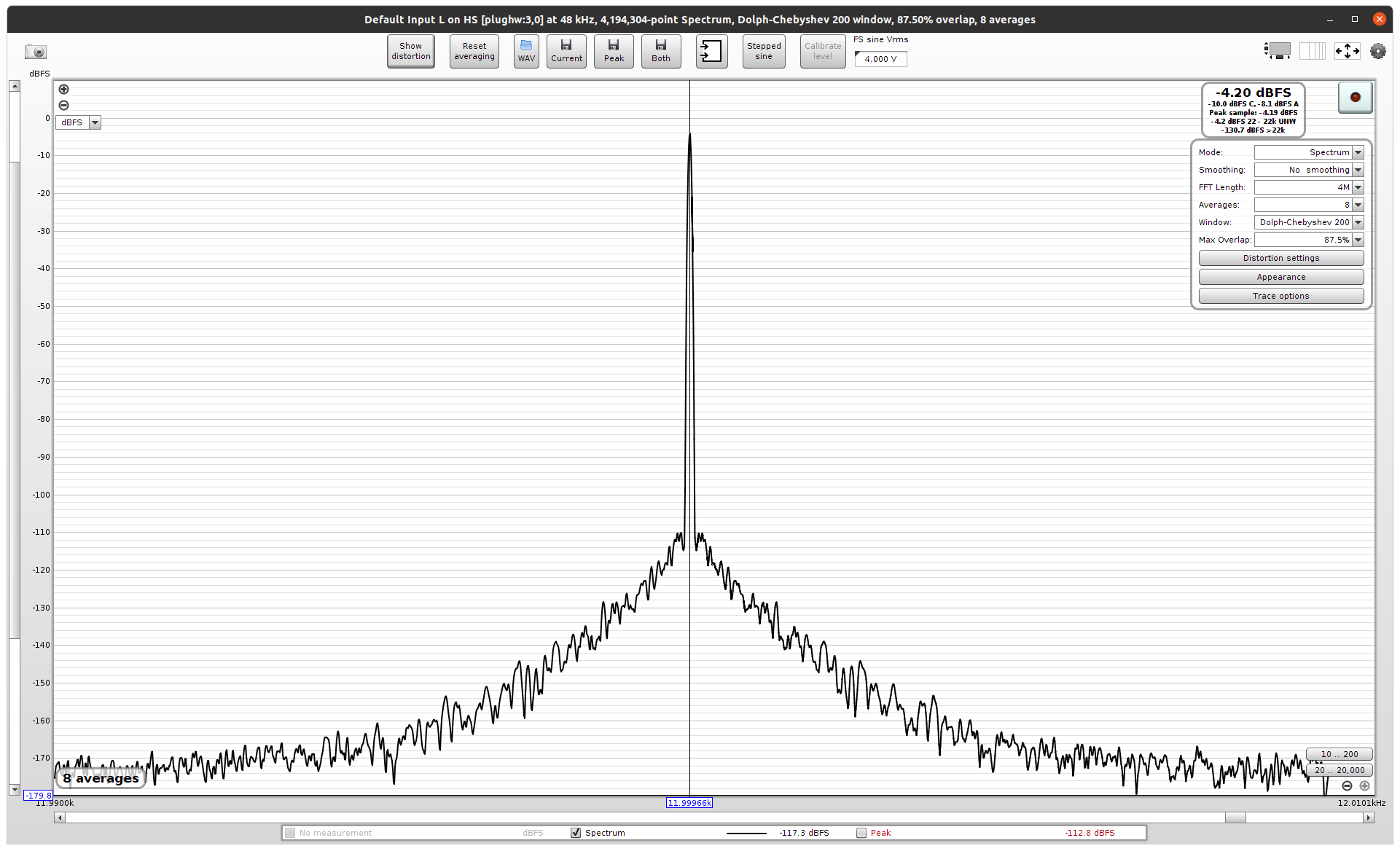

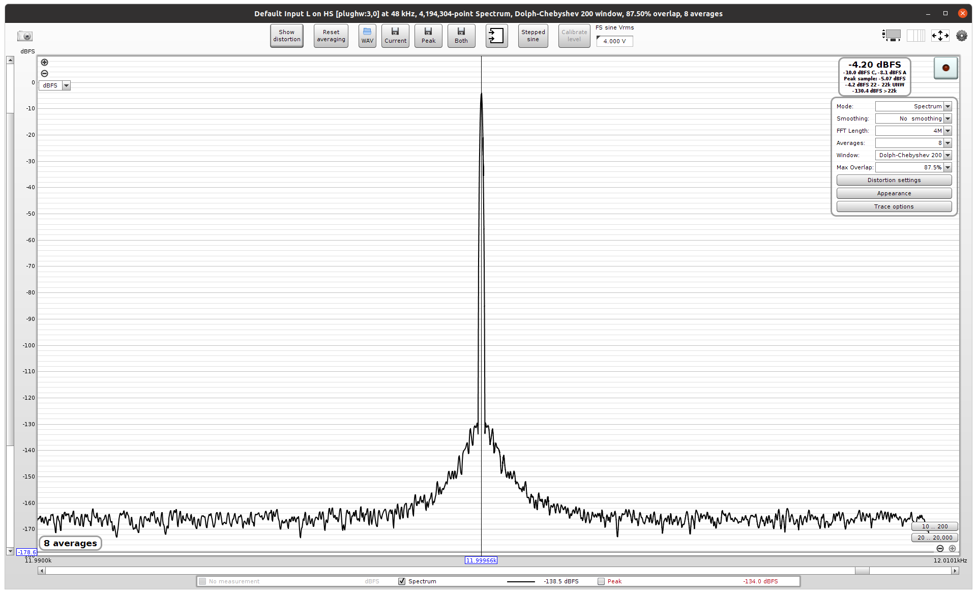

I wonder how package and voltage rating influence this also. I know you’ve already tested a few permutations, but I do wonder if a larger package performs better, or even automotive “soft” termination with epoxy caps.I made still some further tests. First I changed the Cset capacitor to 10uF/50V X7R. This has over 80% capacitance left at 5V.
Here is the same measurement as earlier. Not much improvement to X5R.
Then I wrapped the dac board with speaker polywool and placed it within a steel kettle.
Clear improvement. About as good as tantalum polymer.
So piezoelectric microphony is a very probable cause. And it seems that Class II capacitors can be used in LT3042 Cset provided that proper shock mounting or noise damping is implemented.
Anyhow IMO all this just proves that Vref implementation is very critical for DS dacs. Even small imperfections can easily overshadow the potential benefits from low close-in phase noise clocks.
