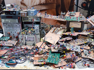

Haven't done much real research or experimental work, have you guys?Ouch! Does it look like a mess?
After decades in a major research lab, one knows better than to make such silly comments.
Perhaps some work by RAP will illustrate the point. Surely you must know who he was?

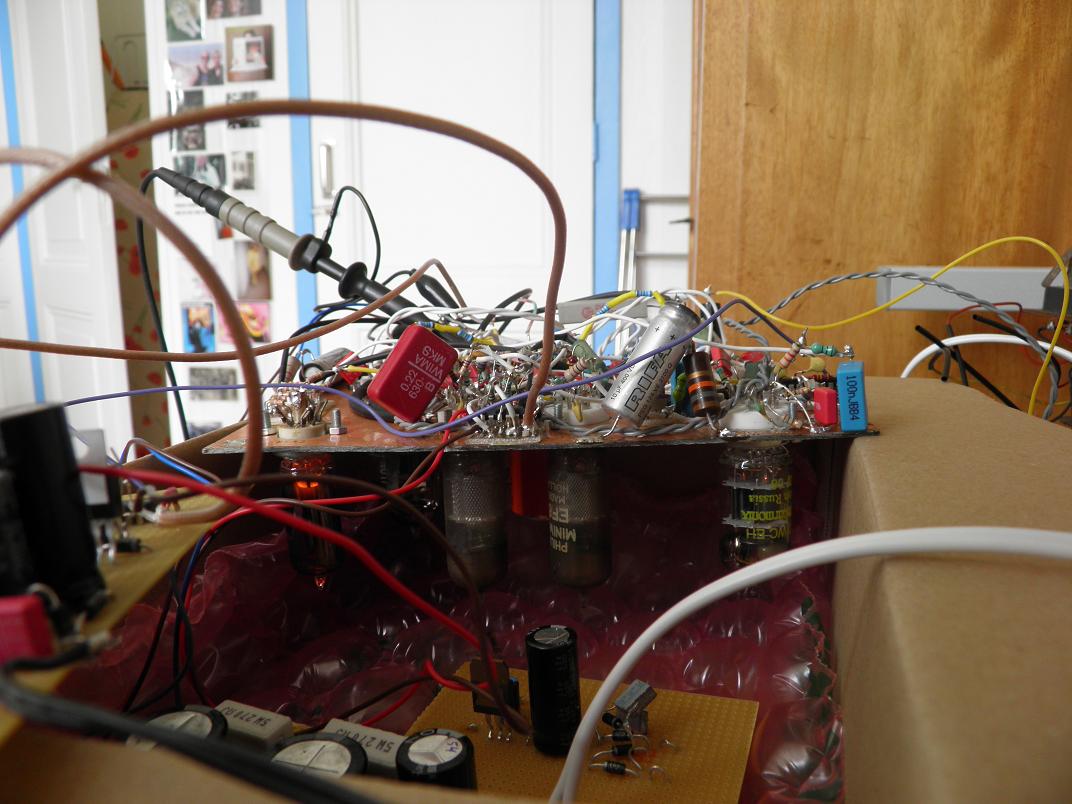

My experimental hobby circuits usually look messier than the experimental circuits in the lab at work. This is a typical hobby circuit:
