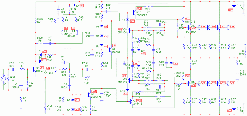

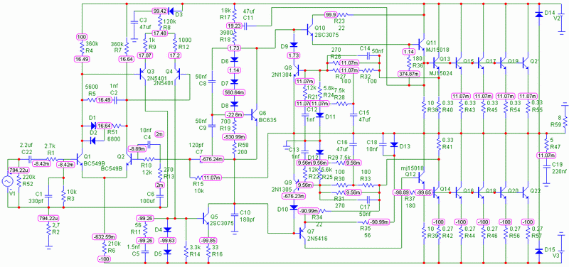

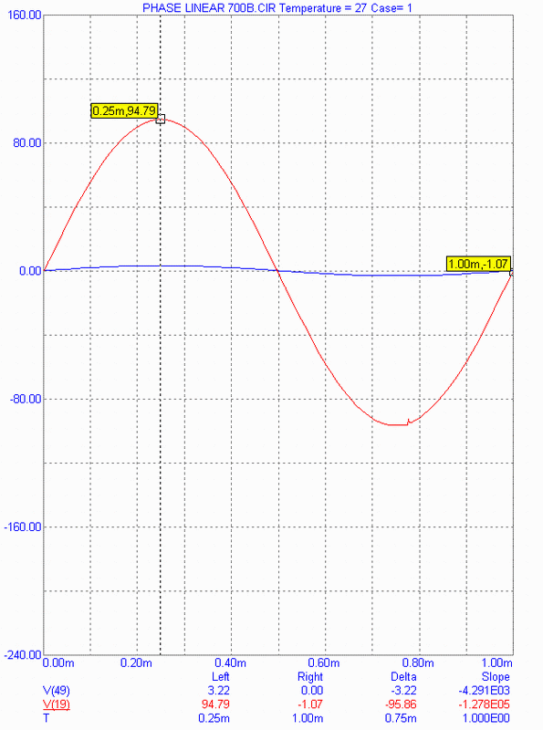

I found some time to finish modeling the 700B.
Picture is the best I can produce, Transistors are what was reasonably available in Microcap except for the Ge's Q8 and Q9 which are standard models.
I can pass the model text file to anyone interested.
/Hugo
