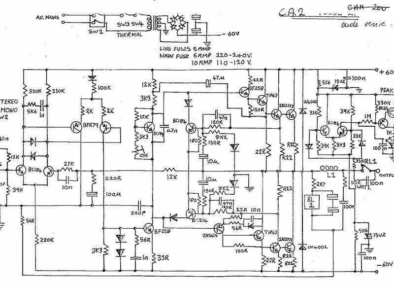

I've looked at the PL 700 schematic in the past and I have a few comments.
Two cascaded diff amps can be seen at the input, the first has no emitter degeneration, the second has heavy degeneration.
The VAS stage does not have a Cdom cap, instead it has RC compensation at the base, and an RC to ground at the collector:
http://www.diyaudio.com/forums/showthread.php?postid=548640#post548640
A cap provides HF feedback from the VAS to the diff amp.
There are three voltage gain stages, and this can be difficult to compensate.
It seems that this amp does not follow good design practice based on what we know today. I have to wonder how stable the original was and if it would be stable with modern replacement semis.
I would say that stability analysis would be required with new semis.
If new semis are used it makes sense to make the output stage complementary if the quasi version can be made stable then both sides have to work and then there is no reason not to go complementary. The CFP side usually provides much more current into low Z loads.
I would consider removing one diff amp stage.
If both are retained I'd consider heavy degeneration in the first stage and less in the second as can be seen in Otala's design, also see:
http://www.diyaudio.com/forums/showthread.php?postid=548259#post548259
Consider a matched pair in the diff amp, and a current source for the emitters.
Big modern output devices should have significantly greater SOA and it should be possible to eliminate the output current limiting, fuses would be wise, and calculations to confirm this idea.
I'd say a full redesign would be best, wish I had the time.

jleaman said:Does some one have the full schematic for the bar led display im talking about ? Id like to build one..
J'
I've got the schematic (PDF) as part of the entire manual. I've repaired several due to an aging coupling cap. The leds were in a dip and is likely obsolete. There may be other chips that are obsolete. It's actually a pretty complicated circuit as it compresses the signal to display the dynamic range. email me if you want the manual.

Netlist said:Pete,
Thanks for your post. I found a similar design from the ‘old days’ by C-Audio (?).
It sheds a light on how things were done (or copied) in these days.
/Hugo

Let me mention that I'd add degeneration to the first stage, and probably less to the second.
The compensation that I'm talking about is C2 in this schematic of Otala's design:
http://www.diyaudio.com/forums/attachment.php?postid=553320&stamp=1105870798
I write a bit more about in the last paragraph here:
http://www.diyaudio.com/forums/showthread.php?postid=556106#post556106
I've not seen the insides of a PL-700 how are the output devices wired, long or short interconnects?
Pete B.

Pete,
I was the one who should have replied.
Unfortunately, I can only thank you for the detailed explanation you gave. I don't have the time nor the brains for math.
Anyway, for those who want to tackle this project, I can do some measurements on my rebuild specimen if required.
I can also tell that the wiring was done pretty short in the original design; that is from driver board to output transistors.
I used MAT02 in the first diff pair and substituted it with no other alterations. I believe this is still a good transistor pair but it might be obsolete.
As for the output devices, good replacements are listed somewhere in d3imlay's pdf's.
/Hugo

Also,
Please explain which transistors are the diff. pair?
Take care,
Different schematics
I agree that it is best to do the earlier version without the OP amp, but there seem to be several schematics.
The version with the MPS5172 transistors in the first diff amp seems to be the earlier version. This is designated as the PCB-14A schematic. It is hard to believe that they run the diff pair straight off the +/-100 V rails. The collector and emitter resistors are so large that they drop a lot of volts and set a fairly low operating current, perhaps keeping them safe.
The +/- 100V supply is risky which probably lead to the next version with the TIS97 input diff pair where the B+ is zener regulated down to +2?V (can't read the schematic) and it also supplies the second diff pair. This is good, a much more reasonable voltage, and these stages do not need a large supply since they're not required to swing the full output voltage. The negative supply is resistor divided down to 1/4 of the main supply, don't know why he cheaped out here, could have used another zener.
I agree that it would be good to use a dual pair transistor in the diff amp(s). It is tempting to borrow the front end of the JE-990 op amp in order to bring this amp more up to date. I also agree with using the ON Semi MJ21195/96 transistors for outputs.
Pete B.
Pete B.
