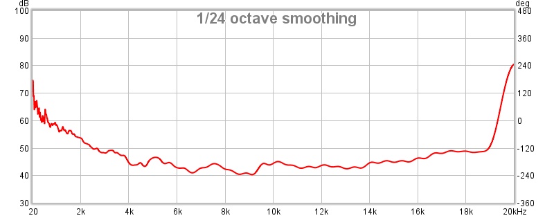

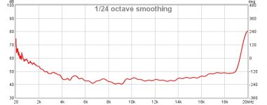

i tried to measure my current speakers (naim n-sat) phase curve and it came out like in the picture. would a phase curve looking like that be adequate for designing a decent x over (dont have to be perfect by any means), i just dont see a resemblance to the mesurments dayton audio gives out on their drivers.

I would not rely on frequency response or phase response measured in the datasheet to design the crossover.
The datasheet info is useful for selecting appropriate drivers maybe, but you're far better off measuring the drivers you have in the finished enclosure with an inexpensive microphone like a MiniDSP UMIK-1 or Dayton UMM-6. This is because there are often variations in manufacturing of drivers that causes their response to deviate from the datasheet, and because you don't know if the phase info in the datasheet has a delay/offset. The main purpose of the frequency response in the datasheet is to show that the driver does or doesn't have major defects at certain frequencies.
What the phase of each driver is doing is not really important. What is important is to design the crossover such that the overall phase (driver + crossover) is aligned at the crossover frequency. Say you have a woofer and tweeter and want to cross them at 2kHz, then they should both have the same phase (no matter what the absolute value is) at 2kHz after you've added the highpass and lowpass filters. Ideally you also want them the phase to 'track' for at least an octave above and below this (1kHz to 4kHz). Does not mean that the phase has to be constant from 1-4kHz, just the same on both drivers. If they are both +60degrees at 1Khz, -10degrees at 2kHz and -80degrees at 4kHz, great! If you do this then you have a speaker which delivers more or less the same frequency response on the design axis and to a reasonable angle off axis in either direction. If you have poor phase alignment/tracking, you will have a speaker which achieves flat response on the design axis, but has a peak off axis in one direction and a null in the other off-axis direction - i.e. if you designed you speaker for a sitting position then when you stand up you either get blasted with a peak at 2kHz, or the response droops hard at 2kHz.
There are methods of designing multi-way speakers such that the phase of the finished speaker is more or less constant over the entire frequency range ('linear phase', like your naim n-sat), often purposely maligning the phase of the two drivers, but I would not worry about achieving this for your first speaker design. A beginner is going to achieve far better results just aiming to get drivers aligned at the crossover point. The audibility of the overall phase response of a speaker system is largely debated. Phase misalignment between drivers on the other hand is definitely audible as the frequency response can change dramatically versus listening position in the case of poor phase alignment.

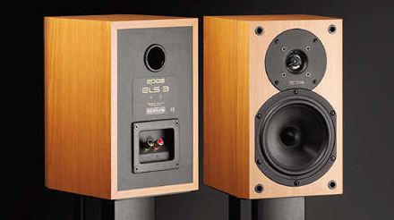

The 5" plastic bass plus 3/4" to 1" tweeter has an illustrious history:
Here an Epos ELS-3:

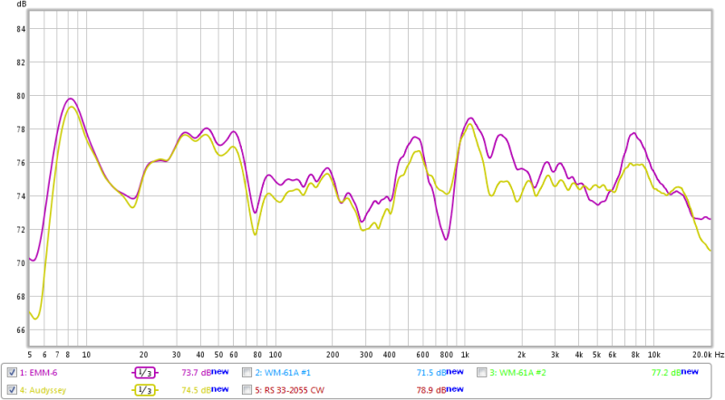

Thanks TMM for that response, it cleard up alot of things but i cant se how spending 120$ (the price for a calibrated mic in sweden) for a mic can add value on a project that cost 100$ in drivers. i looked upp a comparison between a audyssey mic and a calibrated mic and the results are in the picture below.
Here's how: in the end it'll be the difference between a 100$ pile of junk, and the best sounding 220$ speakers you have ever heard, possibly rivalling >2k$ commercial speakers if done right.
Which would you rather end up with?
(Of course, it won't be the mic alone. It will MOSTLY be the TIME spent LEARNING how to take and interpret meaningful measurements. On that, I cannot recommend Joe D'Appolito's book highly enough. And there you are: 40$ more... or 30$ if you choose to buy used).
