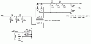

phantom voltage multiplier

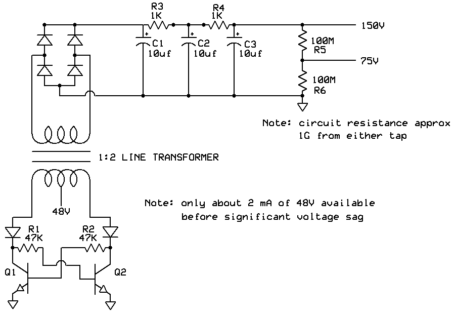

I'm wanting to put higher voltage on a mic diaphragm as well as provide ability to center supply for figure of 8 pattern on dual diaphragm mics. Will this circuit work? What transistors would you suggest? I know the final output side current draw is almost negligible but how do I calculate the losses to determine supply current draw?

Obviously the base resistors will have 96 V so that gives the loss in the base resistors. The loss in the transistors will be small. The transformer core is really the unknown. I assume, due to the lack of a resonating capacitor, you are relying on saturation of the core to determine frequency. So that is the main unknown.
Incidentally, you offer no protection for the reverse voltage on the bases, so they will break down when that side goes negative. You should do something about that.
Yes, the transformer saturation would determine the frequency, how would a resonating cap be tied into the circuit?

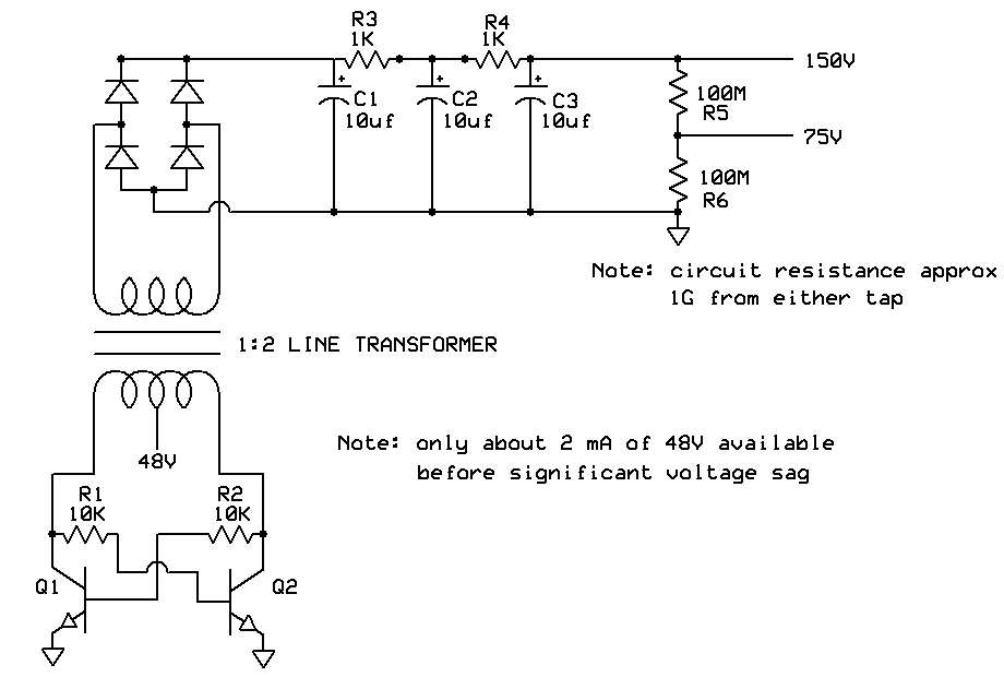

Would the diodes solve that? I changed the resistors to 47K because 10K would suck too much current. Also, how do you figure 96V on the resistor with a 48V supply?
When the left hand transistor conducts and the left side of the winding is thus grounded, the right side, due to transformer action, will soar to double the supply voltage, or 96 V.
The diodes are in the wrong place. They should be in anti parallel with the base-emitter junctions. A resonating capacitor would be across the winding.
Frankly, this is not a circuit for the casual designer. Many years ago I designed many like it and you need a square loop core material to minimize losses and help define the square waveform. So the best would be to wind your own. You may need speedup capacitors across the base resistors. Furthermore, the transistors experience high voltage in the off state and must be capable of withstanding that.
Perhaps you should reconsider and use a Colpitts or Hartley oscillator. Or even a relaxation oscillator (flyback).

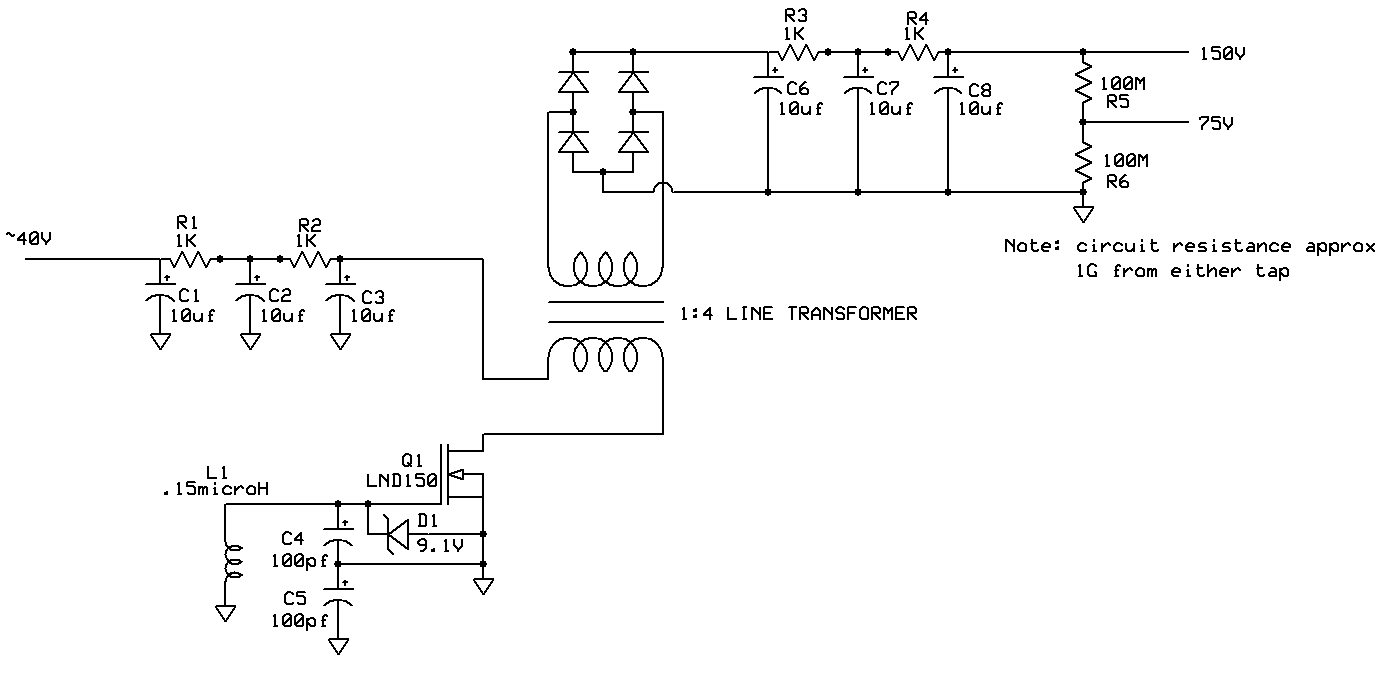

You have L1 in parallel with the output transformer. Shouldn't the latter be in the drain circuit? Of course some protection for the FET would be appropriate, due to the inductance of the primary. What function does R1 serve? You would need it if the transformer were put into the drain circuit.
I didn't calculate the frequency; I guess it's well above audio range. Perhaps right on the same frequency with some local broadcast station...
I assume the FET is depletion mode, else the oscillator wouldn't start.
I think it's around 50MHz, what should I aim for?
Does the added diode provide proper protction for the MOSFET?
I changed to an LND150 which is a depletion mode. I have used them often and have several in stock.
Have I moved the transformer to the proper location now?
Thanks for your help.

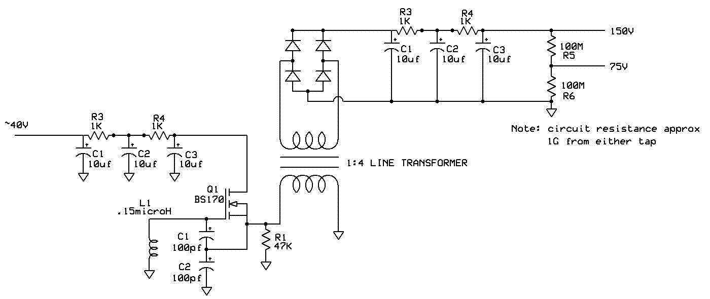

The diode won't protect against high voltage spikes on the drain. Further, the frequency is way too high for any normal transformer; I'd shoot for maybe 50-100 kHz. Plus, make sure the transformer can withstand the high voltages you are applying. In addition, C3 is electrolytic and needs to be bypassed by a paper or ceramic capacitor to be effective at these frequencies. And the rectifiers need to be fast ones.
You may also want to resonate the transformer at the operating frequency; add a capacitor in parallel with the winding.
Any further development of this circuit requires a breadboard or, at the very least, a simulation.

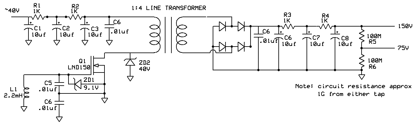

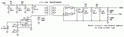

Ok, does ZD2 protect the spikes to the drain now? I've added film caps on both the input and output filters to take the high frequency out. Also, I've changed the inductor and caps to get the frequency more in line.
Does this look close enough to breadboard now?
Nope. You have the bottom capacitor shorted. I can't say if ZD1 will protect or, for that matter, allow oscillation. Further, ZD2 isn't too good an idea, as it may screw up the oscillation - it will conduct on every half cycle. If you want to do it that way I'd use 80V not 40V. I would suggest a diode across the transformer primary, instead, and another to prevent negative on the drain. Incidentally, this transformer will be carrying dc so should be designed for that.
I didn't compute the impedance of your resonant circuit. That would be square root of L/C and should be fairly high, since we are driving a high impedance gate.
DOH oops. Ok so how do I size the source resistor?
I'm looking at a Tamara transformer that has a dielectric strength exceeding 1000V and although this isn't what it's designed for, this will be such low current and I am willing to give it a try.

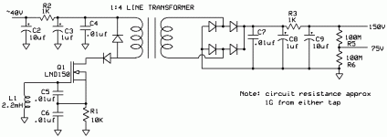

Do I have the diode arrangement correct finally?
I realize that the secondary will only be seeing half wave but I have a full wave rectifier, I don't see that as a problem do you?
When calculating impedance, what do I use for the C value?
.0022/.00000001 = 469, this seems low, is this correct? do I need to change my L/C ratio to make this higher?
Well I wouldn't use diodes that way. I'd put one from drain to ground, anode on ground side. Thus the FET is protected from reverse voltage.
The value to use for C in the calculation is the series combination of the two tuning capacitors; in your case that would be .005 microfarad. And no, the transformer wouldn't be giving half wave. Transformers can't do that.
When I spoke of voltage rating of the transformer I meant the volt-second rating. In other words, you don't want to saturate the core. Raising the voltage or lowering the frequency increase flux density.
The Z value for the tuned circuit probably should be in the range of thousands of Ohms. Making those two capacitors equal does create a large amount of feedback; you probably don't need that much. So make them unequal, with C5 being the larger value.
