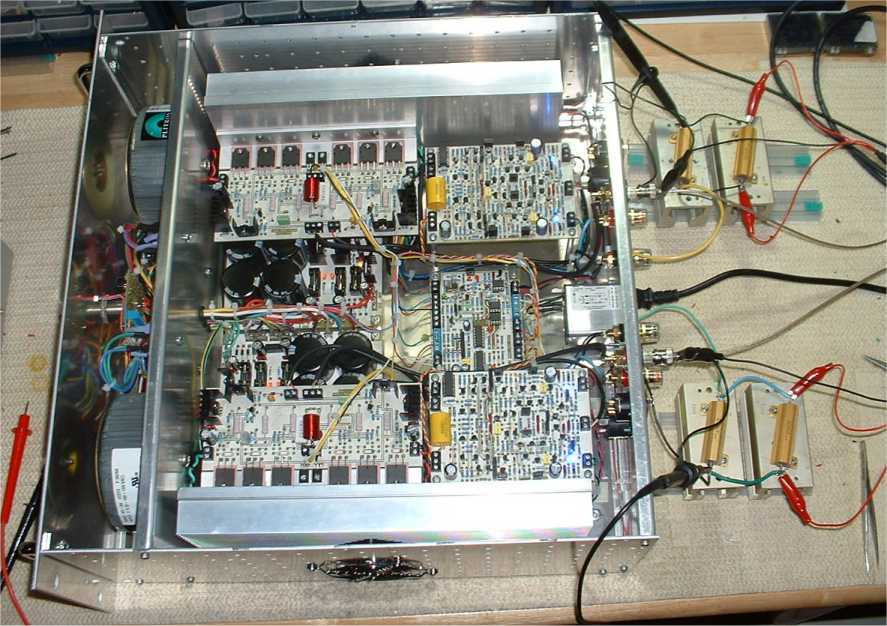

Done.
Now testing...
No significant issues, the only strange things are:
1. At -121 dB, S/N seem to be a little higher than what was measured before putting two channels in the case. It is therefore very hard to measure the THD20.
2. A slight drift of the THD20 value. After 1 hour warmup, THD20 floats around 1ppm with a period of about 15 minutes.
After a few hours of running at 187W/4ohm, the case temperature is about 55C, heatsinks are at about 70C. The fans kick in every 10 minutes for about 2 minutes.
Now testing...
Case closed 🙂

Still looking for a cheap option to oxidize the aluminum front panel...
This was the most complex project I've ever completed.

For anodizing, you can try gun barrel bluing. The front must be extremely clean for this to work (just like when doing a gun barrel). Practice on some scrap first. The longer you leave it on, the darker it gets. Finger grease will damage the finish, but that is repairable.
Try another preamp. The ML tends to sound a little "edgy", as does a Krell. Some day I would really love to hear this amp. It looks great on paper.

Unfortunately, I don't own any high end sources, preamps or speakers. That's why I have to rely on what others are willing to provide for testing.
I'll look into the gun barrel bluing thing. I've found this company in Etobicoke http://www.brimacanodizing.com/ and I'll call them tomorrow for a quote.
