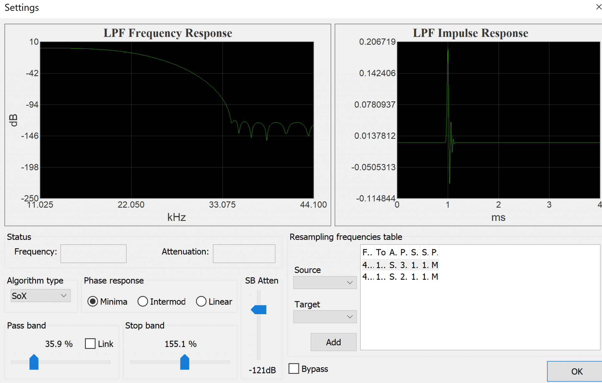

As you know, our test files are produced via the PGGB upsampling software. This is because it’s the highest performing audio resampling filter of which I’m aware. My only reservations regarding the PGGB have been it’s cost, which reflects it’s performance. (A quick aside, if you recall, our thread members are generously offered a 50% discount by ZB, author of the PGGB). Plus, the fact that it’s extreme performance necessitated it work offline. In other words, it doesn’t support real-time streaming content, such as from disc or the internet.
First, a disclaimer. I believe the below information to be correct, however, the responsibility is on you to verify all details. That said, ZB has just released an essentially real-time version of the PGGB, and which functions as a Foobar2000 plug-in. Even better, this Foobar version is free for download and use! So, you now may upsample, downsample, dither and experiment to your heart’s content, and at no cost.
As I understand it, the main performance limitation here is the maximum number of filter taps. Which is ONLY 2-million, in the free version. If you desire, a license may be optionally purchased which expands the maximum filter taps to 1-billion. For reference, the offline version PGGB supports a maximum of 8-billion taps. Ridiculously large figures for an interpolation-filter in either case. It’s an effective business strategy when a company manifestly believes in the benefits of it’s product. No risk for potential users to find out what PGGB technology may do for their listening enjoyment. Enough talking by me. Below is a link to the ‘remastero’ website with the intriguing details.

ZB's speaks about PGGB-RT latency
I received the below email from ZB this morning. It regards our thread discussion on the PGGB-RT playback latency.
I saw some questions raised regarding tap length and delays and feasibility of doing the upsampling (or downsampling) in real-time.
The tap lengths are the maximum PGGB will use but they are not used all the time if the length of the track is not long enough. The taps are for the output rate. So choosing 2M and setting an output rate of 88.2kHz implies a maximum of 2M taps would be used at 88.2kHz and the track length has to be longer than or equal to 2M at the output rate, else the number of taps used will be reduced. If 1B taps are chosen, you need a very very long track. More here: PGGB - FAQ
I mention PGGB-RT is 'near real-time', this is because, in reality, it is doing exactly what the offline upsampling is doing except using memory not disk. It reads in a whole track into memory, does the upsampling and spits out the whole track into memory. It does not work like a typical DSP which has to wait in real-time to collect the necessary samples and then process, this would cause too much delay. For this reason, in foobar PGGB does not appear as a DSP but rather as a decoder under 'tools'.
So the real delay is the time taken to process the first track and this is possible because PGGB-RT always has access to whole tracks on disk. The results are the same as what you have already seen with the offline PGGB upsampled files.
When you have a playlist in foobar and hit play, there will be a delay equal to what it takes to process the first track, but this delay depends both on length of the track and also the CPU speed, generally a few seconds to a few 10 seconds. I use Intel IPP and also make use of multiple cores so the computation is quite efficient. While the first track is playing, PGGB-RT will start processing the second track so by the time the first track is done playing, the second track is already processed and is in memory, ready to be played.
Though streaming is not currently supported, most streaming apps have access to full tracks (at least for Qobuz and Tidal), so the same concept can be applied there too.
