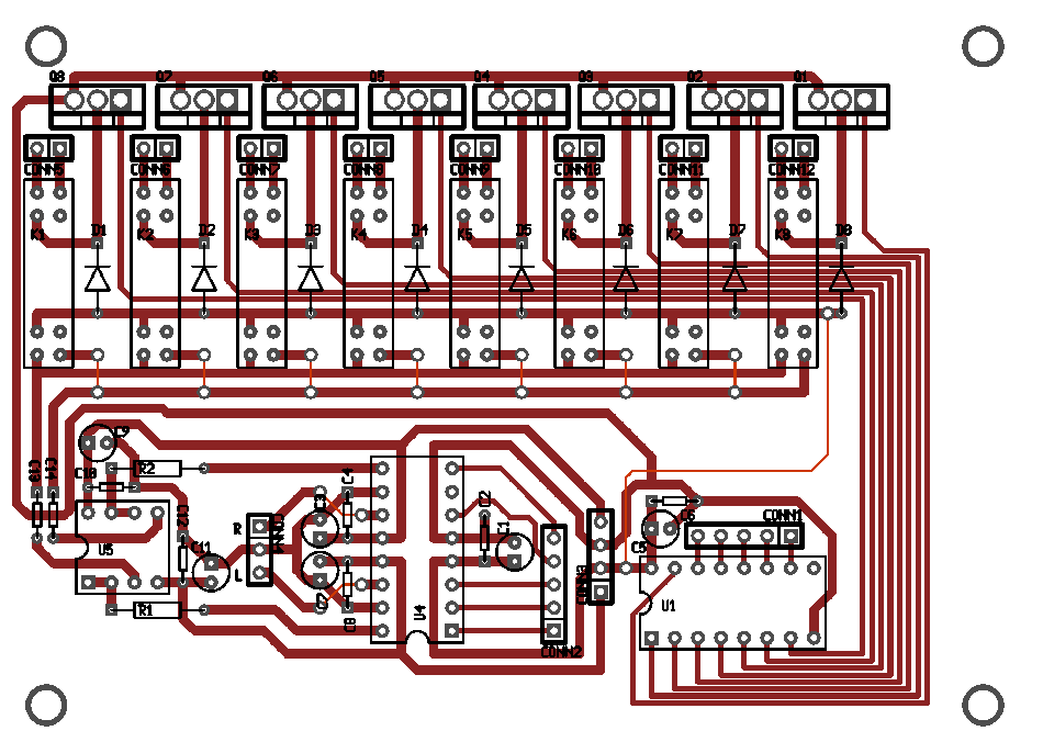

revised board layout
attached is the revised board layout that corresponds to the revised schematic. surprisingly, i was able to even make it smaller. 😎 thoughts?
p.s. it looks like the diode symbols on the board layout are backwards... silly pcb software.
thanks,
~ brad.
thanks,
~ brad.
You can make all the traces to the relays shorter by turning U1 90 degrees
anti-clockwise, so it is parallel to U4.
#16 is a very good post, especially for all the 3-resistor-amp builders.

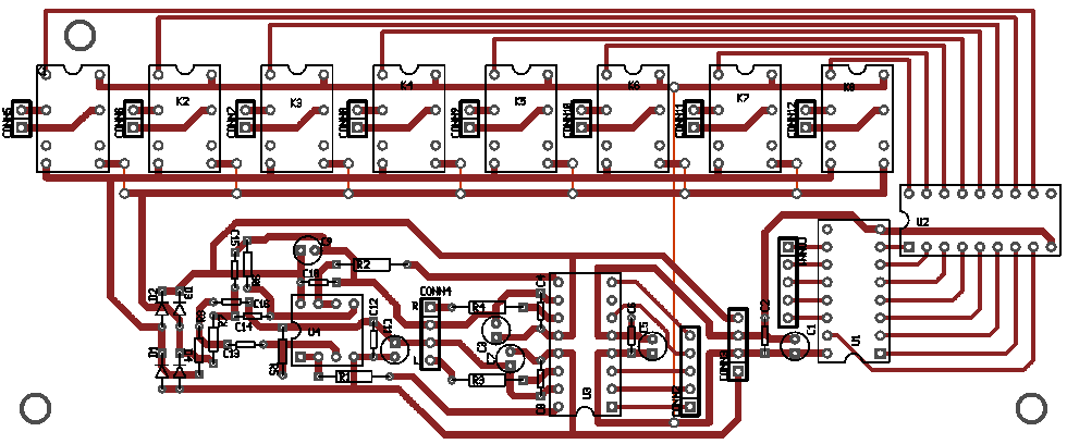

the yet again revised schematic
ok, i've made revisions based on the following recommendations:
* lower power (25mA) OMRON relays
* flyback diodes on the opamp inputs
* HP and LP filters on the opamp inputs
* 100R resistors at PGA outputs
* separate right and left channel grounds
this input has absolutely been extremely helpful so far. i'm learning alot! 🙂
~ brad.
P.S. the 47pF caps should actually be 470pF, for a rolloff at 33.86kHz.

The recommended roll-off for audio amplifiers is between 100 kHz and 300 kHz. That is because the frequency at which a filter starts to have an audible influence is ~5 times from its corner frequency.
I noticed that R6 is the wrong side of the AC coupling cap C14.
I had put 100R resistors with 470p as an HF filter (I realise the diagram was very difficult to read). You could certainly bring this down quite alot if you want tighter filtering. However as pointed out in the previous email you don't really want to go down to a 33KHz 3dB point as you will have some fairly significant amplitude effects at 20KHz and significant phase effects.
You still need some form of ground going back to the microcontroller with the digital signals. Even if you don't have a seperate one for the clocks, you do need a defined ground return otherwise you will get signal intergity problems. So you need to add at least one ground return to each of the connectors. Otherwise the loop area between the return path, which would presumably be through the PSU, will be very large. This will cause signal itegrity problems and crosstalk problems. (Not to mention EMC problems, which could be a problem if you interfere with next doors TV or radio)
LGND and RGND need to be joined together, I often do this with a 0R resistor as you can then put a few options on and see which one works best, and it stops you running into problems with the layout package. Once these are connected together you will also need a conection to DGND; again a 0R resistor could be used.
I am holding myself back from a long lecture on schematic style as its not really a problem in a home build. I bet your really gald your not part of my design team 🙂

pacificblue said:The recommended roll-off for audio amplifiers is between 100 kHz and 300 kHz. That is because the frequency at which a filter starts to have an audible influence is ~5 times from its corner frequency.
wow, good info. 🙂 fixed in the current schematic.
gfiandy said:I noticed that R6 is the wrong side of the AC coupling cap C14.
fixed in the schematic, which i know is not as clean as one would like. the board reflects this change.
gfiandy said:I had put 100R resistors with 470p as an HF filter (I realise the diagram was very difficult to read). You could certainly bring this down quite alot if you want tighter filtering. However as pointed out in the previous email you don't really want to go down to a 33KHz 3dB point as you will have some fairly significant amplitude effects at 20KHz and significant phase effects.
i tightened the HF -3dB point to 340 kHz.
gfiandy said:You still need some form of ground going back to the microcontroller with the digital signals.
i'm not sure i follow. there is a digital ground, separate from the analog grounds.
gfiandy said:LGND and RGND need to be joined together, I often do this with a 0R resistor as you can then put a few options on and see which one works best, and it stops you running into problems with the layout package. Once these are connected together you will also need a conection to DGND; again a 0R resistor could be used.
all the grounds will connect together at a final star connection point in the chassis.
gfiandy said:I am holding myself back from a long lecture on schematic style as its not really a problem in a home build.
thanks. 🙂 honestly, at this point, i really just want to know if the board will perform well enough for everyday use. i'm not looking to release a groundbreaking design, just something that sounds good and works well when i listen to my music.
gfiandy said:I bet your really gald your not part of my design team 🙂
actually, your insights have forced me to understand every part of the schematic at more depth than i did originally. you've helped alot.
thanks,
~ brad.
