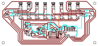

i finally got around to working out a first draft board design. attached is an image of the board with the GND net selected to illustrate that there are no groundloops and that the analog and digital grounds are connected only once: underneath the PGA. all coupling capacitors are 10uF electrolytics in parallel with 0.1uF ceramics.
please let me know if you would change anything here. the circular nature of the control lines makes me a bit nervous, but since only one of the lines between the shift register and the drivers is carrying only about 10mA DC at a time, and since the traces carrying the 500mA DC for the relay do not enclose the PGA/OPA, it shouldn't be an issue, right? (please correct me here if i'm wrong)
thanks!
~ brad.

Your design has no rejection to DC. So if there is any DC on the ouput of your source or the opamps you use as a buffer do not have very very good DC performance you will get Zipper noise in your volume control.
You need a resistor from the positive input to ground to provide a DC path to ground. The positive input needs this to provide its input bias current in case your source is AC coupled at its output. (Which is quite likely). Otherwise you will get a very large DC offset due the opamp trying to draw its input bias current though the ac coupling capacitor. (this will cause massive zipper noise)
You either need a DC servo or to AC couple at the input of the volume control. Or you could just accept the zipper noise as it will only do it as you change volume level.
Normally you would introduce some resistance before the opamp to protect it from static strikes and to limit turn on current into the input (this can damage some opamps the 2112 paticularly) and a cap to ground to filer off any HF noise that may be picked up from the source or from the cables.
It is also normal to have some resistance at the output of an opamp and this is paticularly true for those in the output of the 2310 if it is anything like the old CS3310. This is to isolate the amplifer from the cable capacitance which can make them unstable. Normally a resitor of 47R to 100R is used here. (I use 47R as most coax audio cables are approx 50R and this should give a better match, however this is some what moot as the bandwidth is so low. )
If you want to protect the amplifer against static strikes, diodes to the power rails should also be used, but you could just put up with this risk.
I would seperate the ground return for the PSU for the relays from the ground return for the PSU for the volume control at least back to the connector. If possible I would seperate them completely then the high current for the relay will not be interacting with the same path as the return currents for the volume control and opamps. Also I wouldluse much thicker track for the high current paths to the relays and for the return current from the relay via its gorund return.
Unless your relays have them built in; you need back EMF catch diodes on the coils of the relays or the back emf voltage from the coils will destroy the driving circuit and possibly anything else conected to the sam power rail. (this is really inportant don't leave them off, the back EMF from the coil can be hundreds of volts)
You are right it is considered poor design to surround an analogue region with a digital region. However as the signals are static when the sytem is runing you will probably get away with it. (I would move all the control and digital circuits to one side of the PCB rather than spitting it to either side)
Sorry this is so long but there is alot more to designing and laying out a good circuit than most people realise. (and this is only the basics for a comercial design there would be alot of other things required)
Andrew

Another thing the PGA2310 will almost certainly thump when you turn it on and off even if it is muted as the power rails don't come up evenly. Unless your power amplifer is off when you turn it on you will need a mute relay at the output or put up with the thump.
Andrew
Andrew
thanks for all the help Andrew!
i'm not going to be doing any fades or repeated volume changes, so most likely i can live with the dc offset if it is small enough. i suppose i could place a small ceramic cap at the signal pin of each RCA input jack before connecting to the relays, if the offset is significant.
as this preamplifier/selector will be part of an integrated amplifier with the outputs of the PGA connected quite closely to the inputs of LM3886 chipamps (with 4.7k input resistors) are the output resistors still necessary?
the ULN2064 darlington drivers contain integrated suppression diodes, though their unknown Vr(max) makes me ancy. i may redesign around simple MOSFETs with 1N4004 protection diodes. as for the digital signals sent to the drivers, i'll try to get those all to one side.
good point on the separate ground returns. this is to reduce hum, correct?

I was using a pga2320 without an input cap and the DC offset at the input eventually killed it...
glt said:I was using a pga2320 without an input cap and the DC offset at the input eventually killed it...
wow, sounds like i need to place some ceramic caps at the inputs of the OPA2134. one question... will the capacitance and the input impedance of the opamp form a high-pass rolloff at some insanely low frequency, or am i smoking too much? 😉
