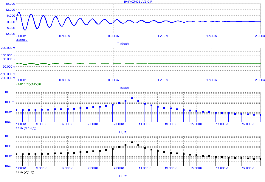

Dave,
I am pointing at the fact that we shall have non-linear and linear issues in one signal. Step change of derivative (sharp corner) will be smoothed by limited frequency bandwidth of explored circuit, the lower bandwidth, the more "rounding". Non-linearities would result in modifyied harmonic content. The resulting spectrum would be most probably quite difficult to analyze. What can you read from this?
The v(out) is an ouput from an amp with considerable crossover distortion, but you would not find it in a spectrum.
I'm not the one to discuss this with... amidst the discussion of potential stimulus i threw this one out that Mr. Perkins found quite useful. (Get him on the phone, he can go on for hours (and at a very high technical level))
The one thing i can throw out in addition from Bill describing this (and most of it going over my head) was that this was used to examine "ring-down" as well as other things. I associate that with a similar approach to what Gedded is proposing.
dave
dave
