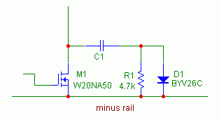

To Eva: this is too dogmatic approach.
I used to attend school somehow and I still remember how to calculate elementary things like energy storage
Still, there was 0,5W resistor in snubber prototype (produced in thousands quantities) and I used the same in my variant. The resistor was barely hot during operation.
There should be another explanation; obviously energy stored in small 5uH inductor is not fully dissipated in that resistor, instead maybe transferred into main output capacitor.
Or, stored energy is of smaller order 😕
Forgot to add, small diode there is SF26, ultrafast type too.
I'm sorry that I cannot find that PFC schematic propotype now, and I also don't have those pcbs near me so that to make picture.
I made a mistake in my above description of 2nd snubber (diode is the opposite connected) so put its schematic here as I recall it. I'm not sure about capacitor value but it's not hard to define since resistor used was 5W cemented wirewound type. This snubber unlike first one operates at full voltage pulses so energy waste is higher. Looks like they include it to decrease switching losses and normalize voltage rise on FET channel after it goes into off-state.
This circuit was also present in schematic by STM engineers, so prototype PFC contains 2 snubbers.

Alme and Eva are discussing a snubber circuit in this thread and this would be a useful addition to reduce switching losses if it can be worked out. The configuration in question is for a magnetic snubber that looks to be the same one I saw in an ST appnote. It came with a number of formulae and my notes show I calculated some values as follows, based on the appnote:
L = 4uH, based on Vout/(di/dt = 100A/us)
C = 200nF based on (Energy(C) = Energy(L) = 250uJ) and Vc = 50V
If this energy has all to be disipated in the resistor then the resistor would need to be 36W!
R was not calculated and I appear to have run aground here and abandoned the snubber. The high dissipation I calc in the R is consistent with Eva's explanation, but I'm not at all confident enough on snubbers to be pedantic about it. (I'm usually just grateful if my stuff doesn't explode!)
But this dissipation would render the snubber useless, which surely can't be the case. Perhaps, as Alme has suggested, there's something we're not seeing here, or our initial assumptions about how this thing works may be wrong. . .
Come guys, thinking caps on . . .

Hi there....Those wanting to use melf surface mount resistors be mighty careful in pfc circuits. In telecom many boards fail due to board flexing after the soldering process ...then mounted......the serious and explosive condition that can happen if the OVP and voltage feedback dividers beome o/c. With no reference the duty cycle goes full in one cycle to reach breakdown voltages.
It happened to me on a 1 kW 500V pfc and with so many joules stored up in the o/p caps the switching components exploded.
Anyoner using a magnetic snubber would be hard to convince me of the worthwhile conditions at high line Vin. The odd % + in efficiency doesn't warrant the extra cost of a fast diode /components and extra space. What everyone should be looking at is reducing the wretched bridge diode loss at low V in with high VA.....this in my circuits is by far the greater losses than either IGBT or fast diode.

Quite right. There's about 20W lost there in my design, which I forgot about completely in the calc in my last post! This would make my FET switching losses then about 24W.
I've seen some bridgeless designs in an appnote (think it was ST) where they use 2 FETs instead of a bridge. But I've never scrutinised these designs to see how the losses from the second FET switch compare with the loss of the bridge. It may be a false saving, it may be worthwhile.
I once designed a 240W PFC/converter PSU for a company, and it had rectangular 200V 1206 resistors in the divider chains for both feedback and OVP. As luck would have it, these both failed at the same time while the CE examiner was testing the unit in his lab. The +400V bus shot up to 720V and 2 x 100uF electrolytics exploded! The examiner was VERY SHAKEN, but had to concede that this was a low probability case of a double fault.
