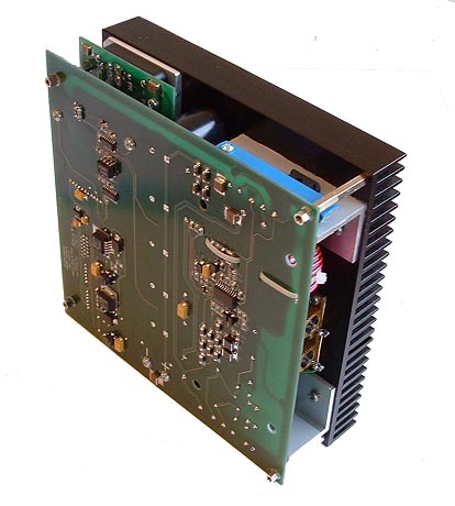

What's that?
PS: The big heatsink-mounted resistors you can just see under the PCB are voltage dependent load dumpers on the +72V rail. In a digital amp where PSU voltage is used to control volume, if the volume is reduced by reducing the voltage of the sync reg, current flows backwards through the sync reg to the +72V raw supply and builds up voltage on caps on the 72V bus. To keep this buildup to reasonable limits one has to fit clamps or a switchable load on the +72V raw supply. In my first PowerDAC I used a series string of 3 x 5kW TransZorbs as a clamp; in this design I switch in a phat load.
Cheers
John

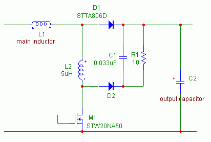

Alme :
This circuit dissipates in a resistor all the energy stored on the inductor on each pulse
With 5uH at 45Khz and 25A peak [2KW at 160Vrms including diode reverse current] the dissipation on the resistor would be 70W so it's not practical
However, my circuit uses a coupled inductor to transfer that energy to the output capacitor so it's almost lossless
To Eva: I'm not sure about that stuff, how to define power loss in such snubber, but I've seen 0,5W resistor is used there in some professional design and I also used such resistor without a problem (PFC output power 300-400W, switching freq. 100kHz, input voltage 180-240VAC)
And, forgot to add, there is also another snubber present: diode and resistor in parallel, diode anode to minus rail, and capacitor between its cathode and FET drain.
Is this for EMI issue?
