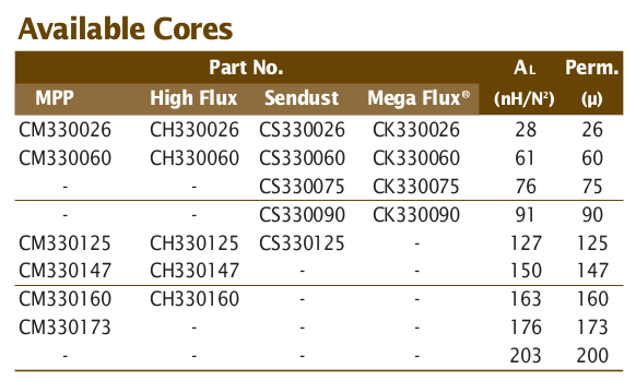

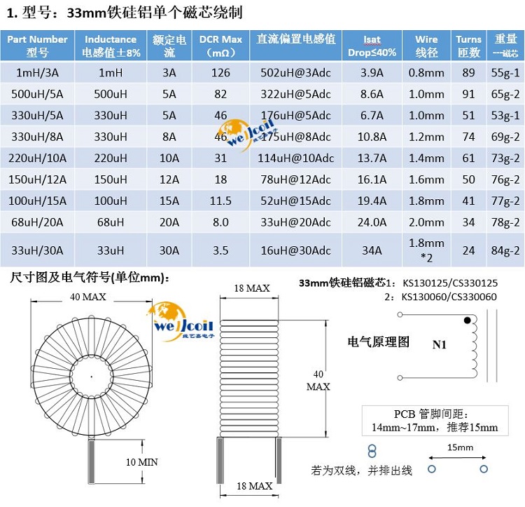

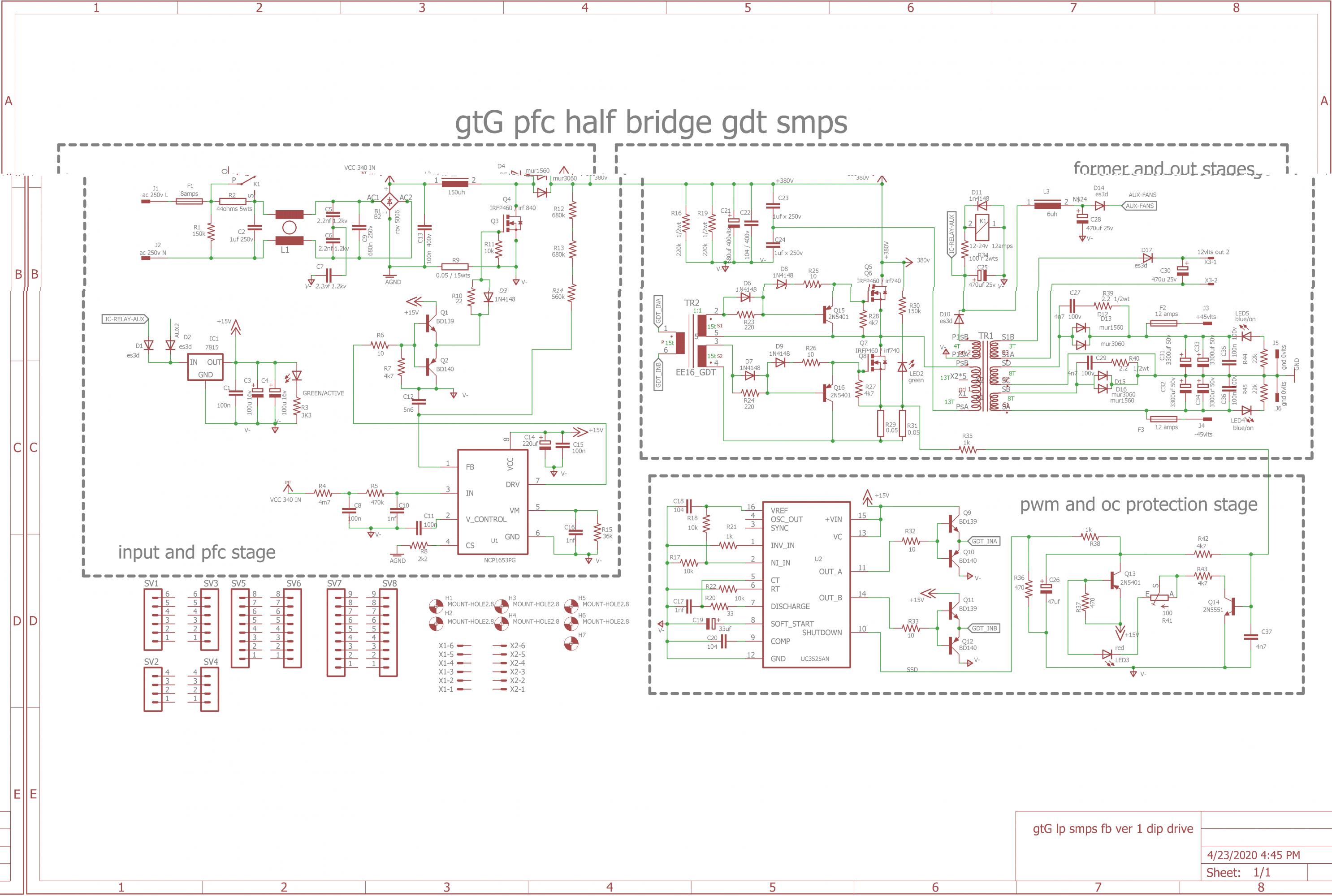

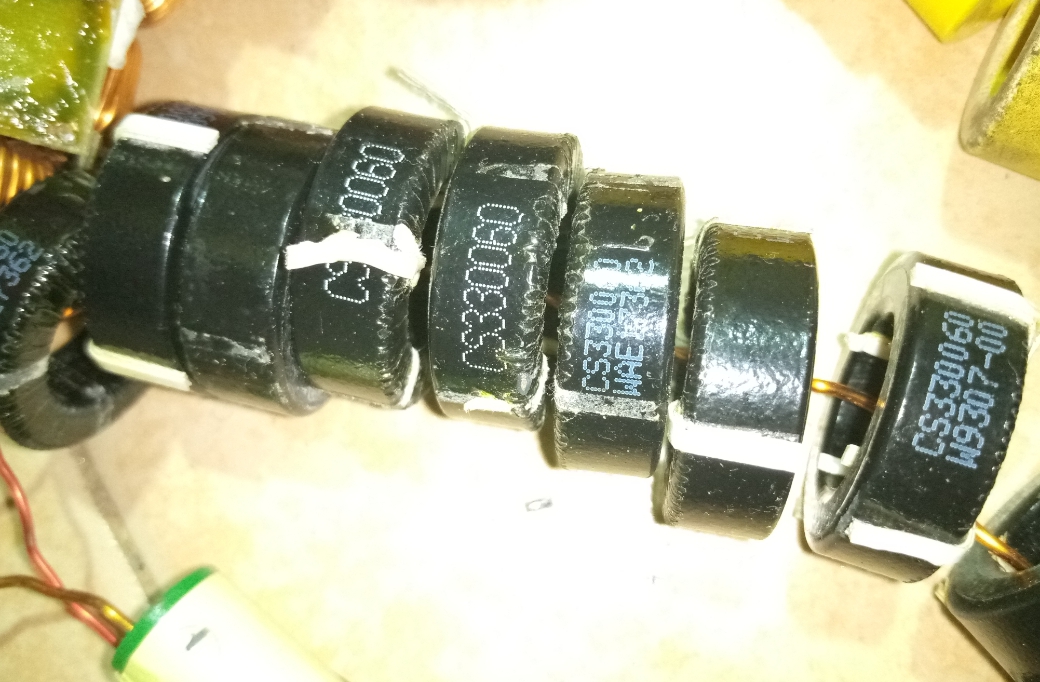

hi all, i have drawn a smps schematic and on the pfc side i am planning to use the onsemi chip ncp1653 . the core i was planning to use the black core cs330060 with about 61 turns.
ideas and comments are highly welcomed.below is the smps schematic and core datasheet 🙂
