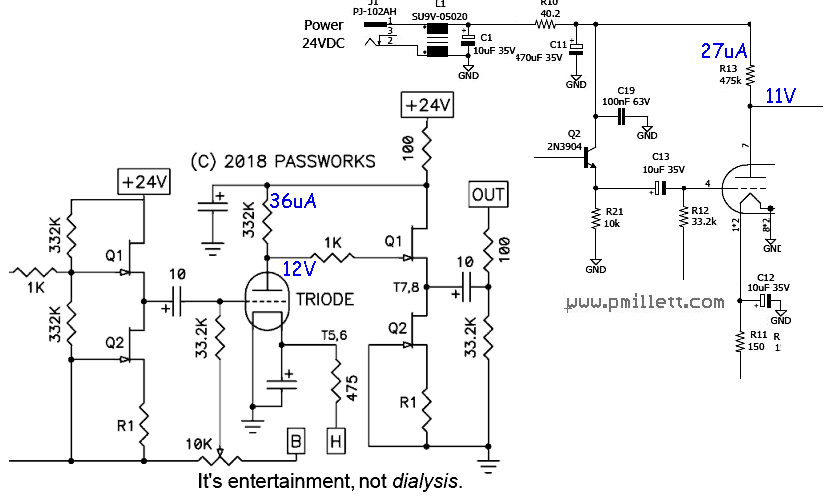

This circuit uses very high resistance values, and very low plate current.

In that event I would say that the design is lacking, and operates the tubes
at excessively low plate currents (roughly 30uA).

The factory data sheet circuit isn't that much different from this circuit, though.
However, there is a way to see if the noise is from the bias regulator IC.
Leave out the capacitors that you removed, for now.
Connect a 10uF 35V capacitor directly from each tube grid to ground.
Make sure the positive terminal of the new capacitor is connected to the tube grid,
and the negative is connected to circuit ground.
There will be no sound when doing this, just the noise (if it is still there).
This filters the bias supply heavily, and will show whether that is the source of the noise.

...operates the tubes at excessively low plate currents (roughly 30uA).
The NuTube (originally a display device) is about the worst tube ever used in audio. I forget the curves but 30uA may be as good as it can do.
The nearest experts will be Pete Millett and Nelson Pass.
Pass's plan: https://www.firstwatt.com/pdf/art_diy_nutube_preamp.pdf -- not so different from Millett's, as far as the tube goes. (Different in/out buffers.)
First I hoped it was the 475k bias resistors on the buffer bases (should be more like 30k instead).
Then thought it could be the bias regulator IC, which still has not been ruled out, but probably
it is the tubes.
it is the tubes.
First I hoped it was the 475k bias resistors ....
Bypassed by 10k pot through 100nFd cap. About 1uV in the upper audio band. Would be quite inaudible at line level. (Even raw 475K is only 9uV, not a big hiss.)

Here's an update for you: Pete Millett got back to me about the hiss, and recommended lowering the value of R13 and R14, starting with 220k and going as low as 100k or lower. I tried 220k and didn't hear a huge difference. Going to try 100k later and give it a listen.

Update for those interested: Lowering R13 and R14 to 100K made a palpable different. I'd say about 80%-90% reduction in hiss. Pete suggests going as low as 47K, but warns of gain falloff. I'll be trying 47K as soon as I get my hands on some.
